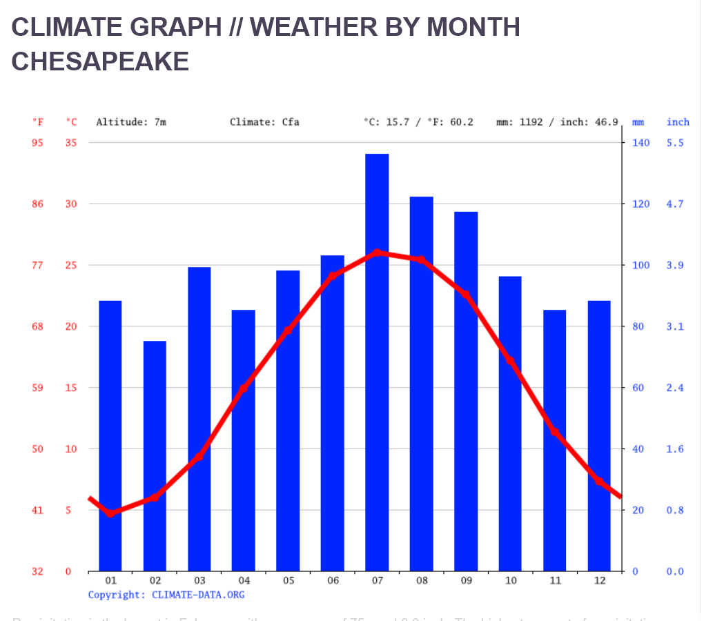

C'mon, you're kidding us. Winterize in your climate ?
Your expected lows are in the low 40"s F. and you're in the water. Our expected lows are in the mid 20's F. and the faucets will not freeze. The thermometer in the cabin never goes below 35 F. due to the water around the hull and a bit of diffused sunlight in the day.
If you're worried about your engine, put a 25W bulb under the oil pan. And your engine does have 50/50 antifreeze for corrosion control I trust ?
Two recommendations :
1. Stop listening to the mental black holes on your dock.
2. Buy yourself a good book on boat maintenance such as Caulder's "Boatowner's Mechanical and Electric Manual".
I don’t know what red line in your chart is meant to show (average high? Average low? Daily average?), but I can tell you most years our marina on the northern Chesapeake gets at least a skin of ice at least briefly. Some years parts of river get a decent layer of ice for a couple weeks. The OP’s profile says Annapolis, about 40 miles south of me, but well north of the southern bay. The average low in Annapolis in January is 29. Personally I wouldn’t be comfortable without winterizing in that area.
