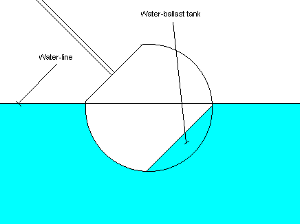

That tank MUST be full and sealed tightly. Anything less and your boat will be a hostile winch that borders on psychotic. I don't know how upset I'd be about it leaking a little on the trailer if it's full(it really shouldn't be full out of the water unless your trailer is a massive brute).
"Full" will depend on how much gear you have on board. When I'm loaded for a week long cruise mine would over flow with the vent out. If you havn't experienced the insidious creep of unneeded gear then it could be down in the vent a few inches at the most. The 23.5/240/26/260 all have the same fill system so it won't vary much(if any).
When I'm emptying mine on the ramp I personally like to announce that my beer drinking crew REALLY filled the holding tank this time;)

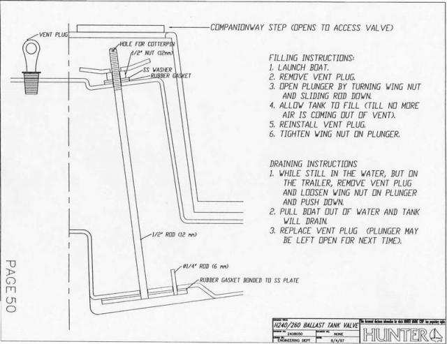

Here's a pic to visualize the dynamics of a water ballast boat. Also a page from the manual for the tank details. There's no room for air to slosh around if it's working right. Be safe, keep it full and seal it tight and go have fun in your new ride. Congrats, Mike and Kelli

Soling42,
Thanks for your reply also.
I have looked at the picture you attached in the manual, but perhaps didn't notice a detail that might help resolve my concern.
If I look at the area around the wing nut in the diagram, then follow the top of the tank to the right, I notice that it quickly makes a 90° (more or less) turn downward. It goes down for a ways then makes another bend to become horizontal,
davidb
Aug 22, 2010
11
Hunter 23.5 Benbrook, TX
Dang it - sent of the previous post before I was through with it!
To resume...
If I look at the area around the wing nut in the diagram, then follow the top of the tank to the right, I notice that it quickly makes a 90° (more or less) turn downward. It goes down for a ways then makes another bend to become horizontal, proceeding to the right off the edge of the diagram. If the construction on the H23.5 is close to that of the H240 (pictured), then I have just about convinced myself that the part that proceeds off to the right is in fact the top of the main part of the ballast tank. The proportions of the space under the wing nut would pretty much explain my observation. I'll have to go double check the corresonding picture in my H23.5 manual to see if it looks the same.

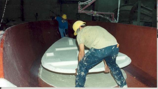

Here's another pic of a tank being installed. Your tank will fill in no more than 8-10mins. If in doubt about whether it's blocked or screwed up, check the bottom plate at the ramp or with a mask/snorkel. My old 240 would leak down if the vent wasn't sealed tight but otherwise it's impossible if the vent's in right and the thread for the wing nut's not sucking air.
Load some folks carefully on the boat while she's filling/nearly full but still tied to the dock to see the water level rise at the vent. She'll be tender but won't flip or anything completely unpredictable within good sense. When it stops blowing out air that's all you'll get. I suspect she's just a lightweight without all the provisions she'll get over the next year.
