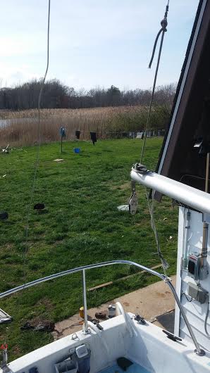

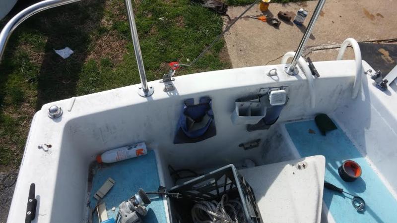

Hello Everyone,
I just bought a Mac 25 "lawn ornament" that I am refurbishing. Having primarily only sailed Hobies in the past I am not sure how to rig this thing, esp. the mainsail/ sheet. I know I am missing a block or two based on pics I have found on the internet but I was wondering if others could post pics of there main sheet/ tackle with descriptions so I can replace the blocks etc. Thanks in advance!

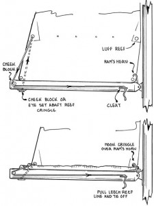

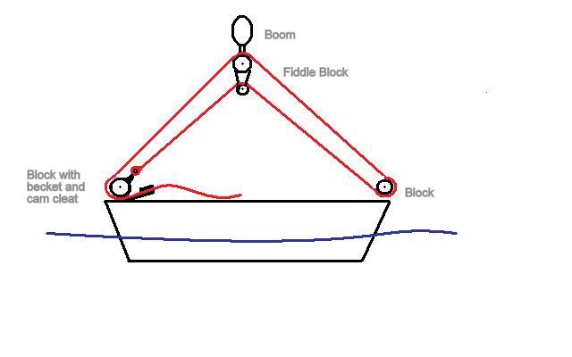

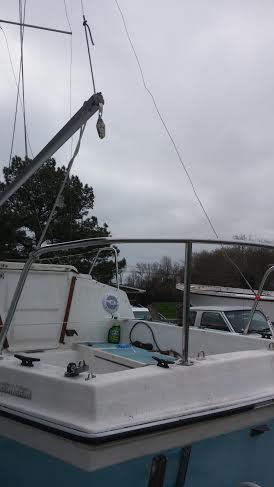

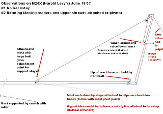

my 1st sailboat was a Mac25... I loved sailing it... it will be a good boat and will take some punishment from mistakes as you learn... do not be afraid to go out and sail it... here are some drawings of how it should be rigged... I hope they help... I set me Mac25 up for solo sailing, so every rope on my boat came into the cockpit for easy reach... what kind of rudder do you have on your Mac25 ?... mine had a kick-up rudder system... it is great if there are frequent submerged objects in your lake... the 1st 3 pictures are of mainsheet rigging used on the Mac25... the 4th picture is the mast raising gin pole system.. the last pcture is of main sail reefing ....
I attached a traveler in my cockpit just aft of the cabin doors and used mid boom sheeting... l prefer this type of set up as to the end of boom main sheeting..

the mid boom sheeting lets you better control of the sail shape... the end of boom allows for better swing of sail, but not the downward force to give better sail characteristics... the vang helps with that... a traveler will help like the vang, but repositions your mainsheet for the control of the sail... a vang is used mostly when you have your boom swung way out over the gun'ale... the vang can also double as a preventer for the boom in the case of a jibe when running downwind...
My Morgan 35ft uses end of boom sheeting... the boom rotates for reefing the main sail... and I have a traveler for sheeting the main...

Great visual aids and advice everyone thanks. I have a couple extra Hobie blocks I will rig up for the main sheet. I don't see any place on the boom or mast for a down-haul/ boom vang to attach though. That is a bit disconcerting! I imagine the boat sails like sh!t without one. Any thoughts?
Jul 1, 2012
306
MacGregor 26D Kirkland, WA
hey Doc, maybe that end of boom point was just for a topping lift? your rig is off a Hobie 18, right?
