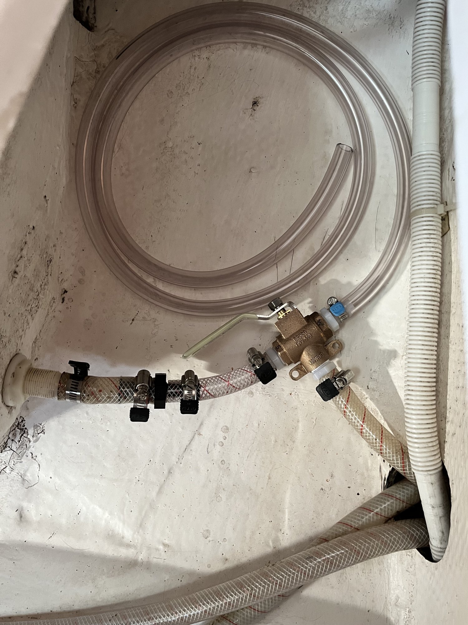

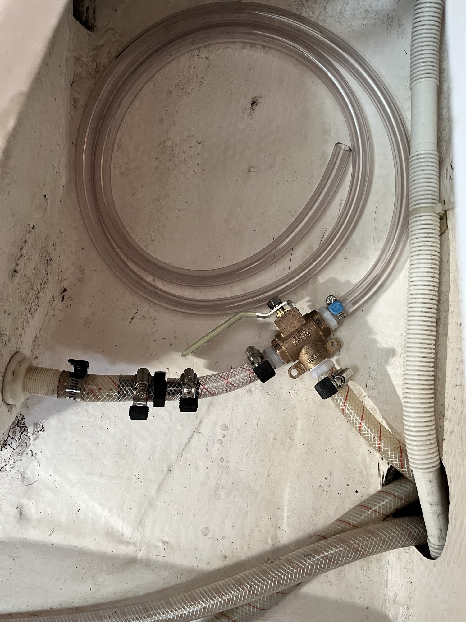

I already winterized this season but this was a project I wanted to get done for the future. I'm wanting to avoid having to pour RV antifreeze in my fresh water tank to winterize my potable water lines, pump, valves etc. I just don't like it sitting at the bottom of the water tank all winter long. I've already installed plumbing to bypass the water heater with a couple diverter valves before I winterize. This just completes my winterization process: I have used the same diverter on the main supply line after to water tank so I can draw antifreeze into the system without the tank. I also replaced the PB line with PEX. The before and after pictures are taken in the floor, just in front(behind?) of the V berth. There's a removable floor panel that just lifts up. Once the tank is drained of water, I turn the diverter and draw antifreeze from the jug. The clear line stows in the small space when I'm done. I tested it and it all works as expected.

If the tank is drained, what can do damage by freezing?
I assume he is pushing water out of the rest of the fresh water system.

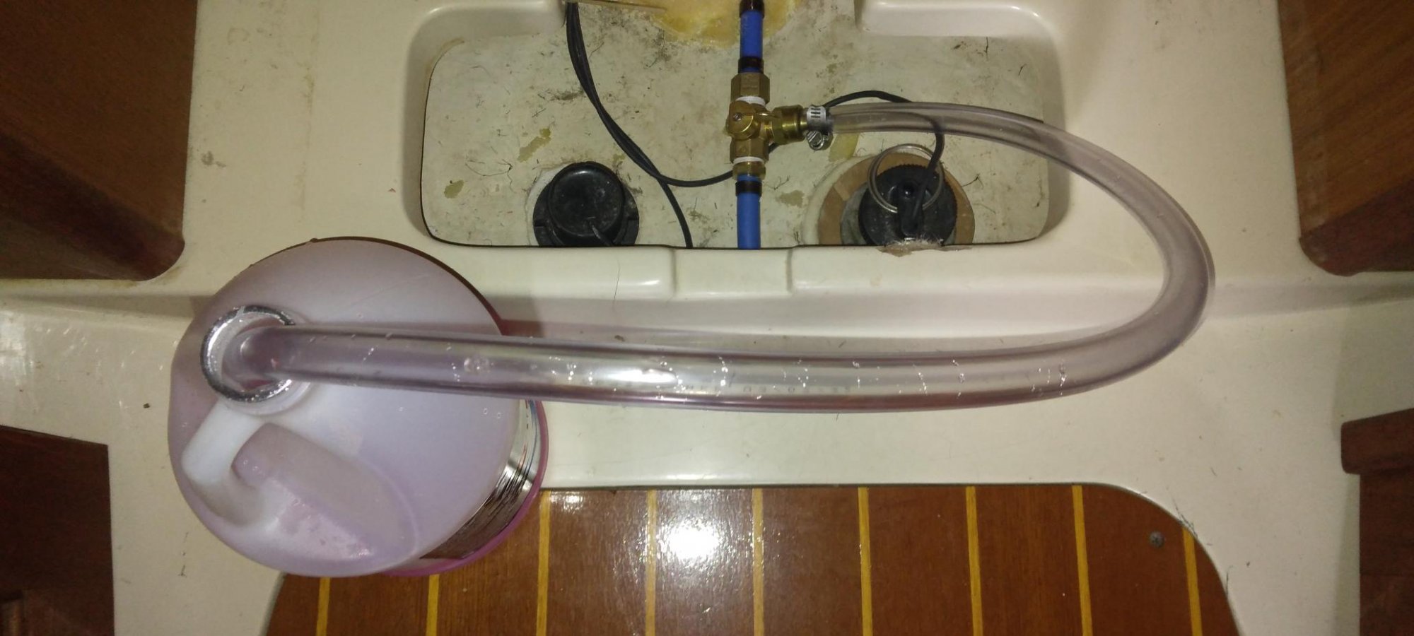

I do something similar, but not quite as “automatic”. I remove the water line from the tank and I have a short piece of hose with a fitting that screws onto the hose from the water tank. The extra hose let’s me put the end in a bottle of AF, and turn on the water pump. Then open the faucets and run AF through the water system.

That's exactly what I've been doing, although only for a couple of years now. Since my fresh water tank probably has a couple of gallons still in it when the pickup tube starts to suck air, adding antifreeze to the tank always seemed like a huge waste. You dilute the heck out of it, and then pump the diluted antifreeze through the rest of the system. Since I installed an access hatch on the top of the fresh water tank, I can ladle and sponge the tank completely dry, and then disconnect the pickup line, add a length of clear tubing to it, and stick that in a gallon of antifreeze, so I'm pumping pure antifreeze into the water lines.

Good job! After thinking about something like this for years, I actually also just did it this fall with three way valves added to my water line near the tank and my head fresh water intake line just above the seacock. In both cases, the anti-freeze line just coils up and lays in the lockers. There’s nothing much stored there anyway. I also finally added a winterizing bypass kit on the water heater. The biggest issue there was space. Not even a millimeter to spare.
I spent probably spent around $200 total on materials, but it was well worth it to me. Winterizing was so much easier this year. Much faster, no more frustration getting hoses off of hose barbs with increasingly arthritic fingers, and less clean up.
Nice, clean installation.

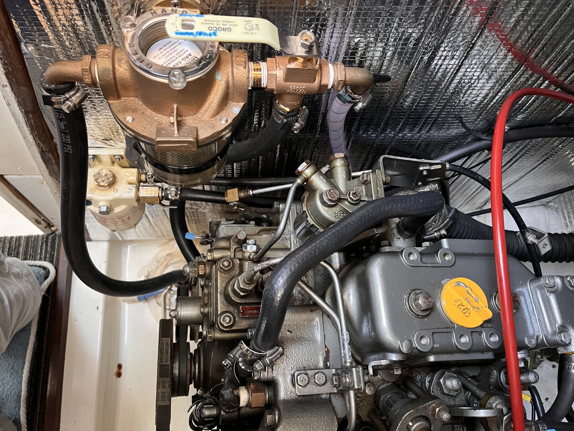

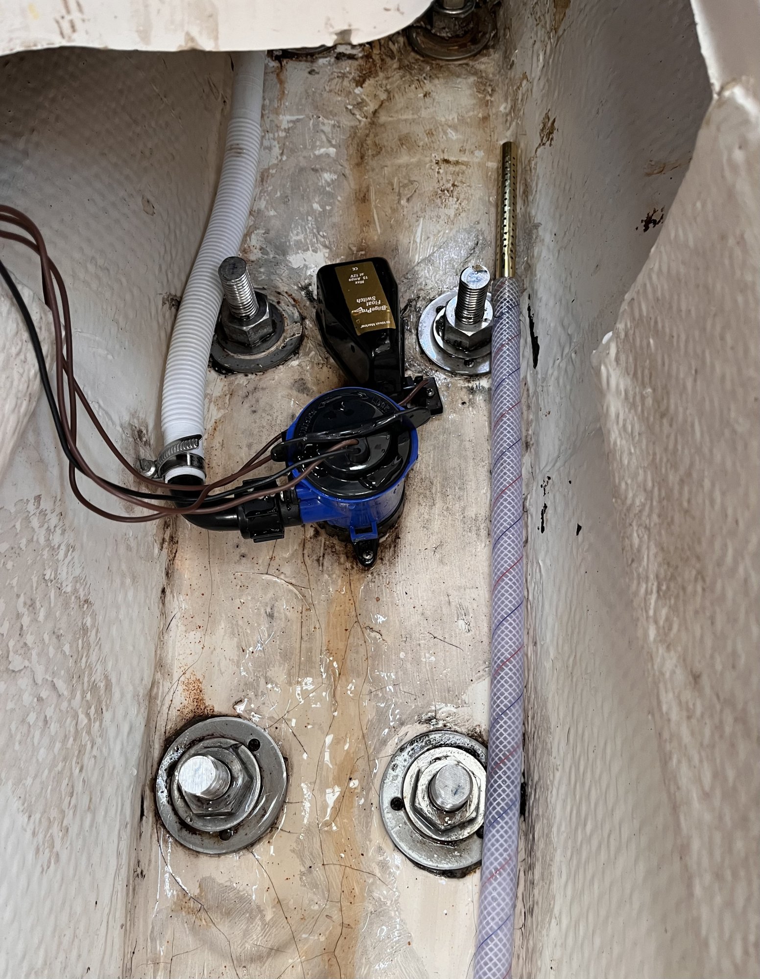

I like this system so much that I did the same thing with my engine this summer. Just used it to winterize the engine yesterday and it’s so quick and mess free.
What I did was add a three way valve to the engine side of my raw water strainer and run 15 ft of 1/2” hose from that to the bilge with more than three feet of hose laying loose in the bilge. To winterize, just pull the hose out of the bilge, stick it direct into jugs of antifreeze and flip the valve lever. Engine winterized in less than five minutes with no mess to clean up.
This system also allows the engine to function as an emergency bilge pump. For that purpose, I made a custom stainer for the end of the hose with a six inch long piece of brass pipe. I drilled 128 holes 3/32” dia in it and closed the end with a cork. The strainer is just friction fit into the hose, no hose clamp, so it’s easy to pull out for winterizing, which is the primary purpose.

For the engine and air conditioning cooling water, I have the same Groco Water Strainer that Dalliance shows in his photo. I bought a second cap that has a hose barb installed into it. I put in this cap and connect the hose to a bucket with a spigot mounted on the side at the bottom. I put the AF in the bucket and run it through the strainer into the engine and into the air conditioner strainers.
