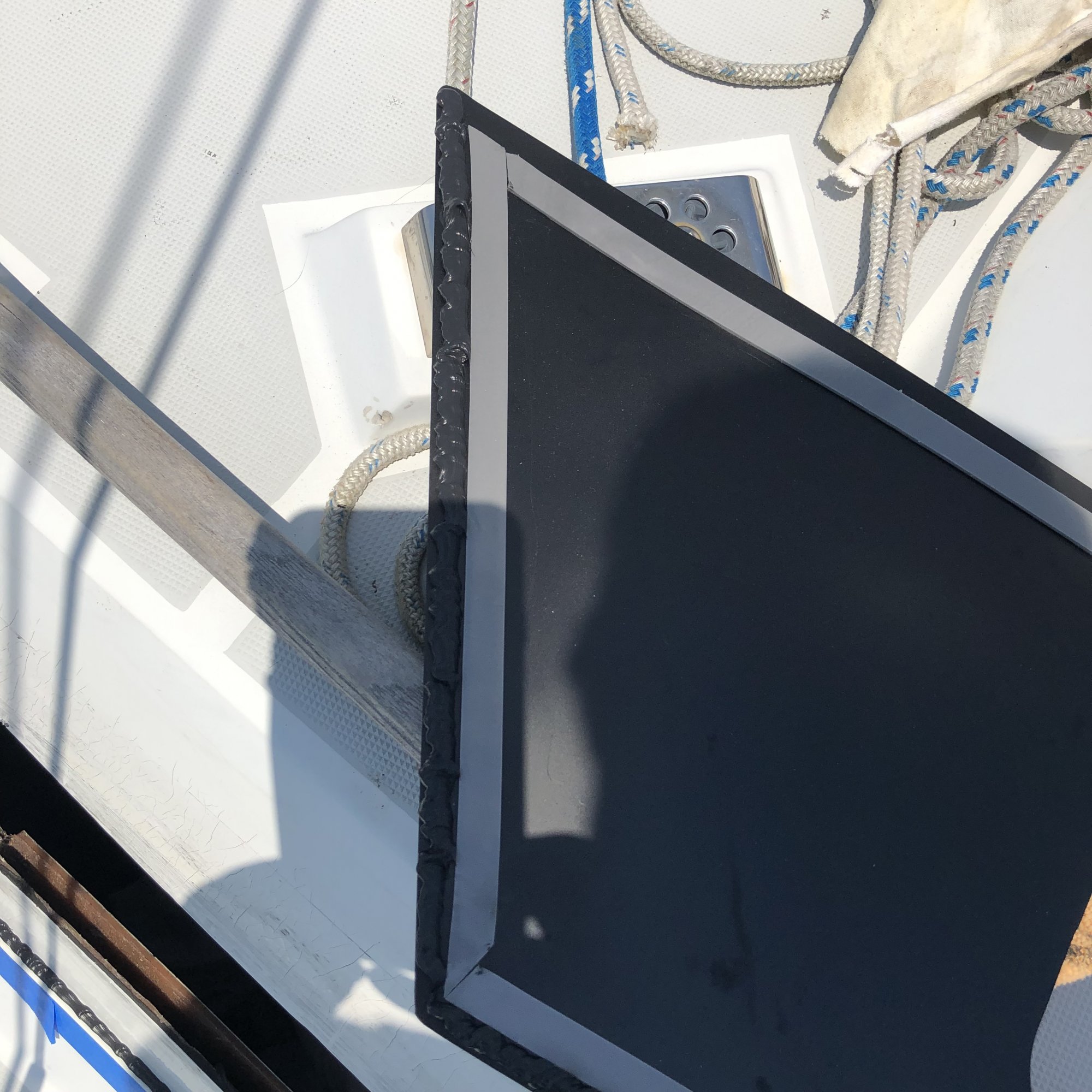

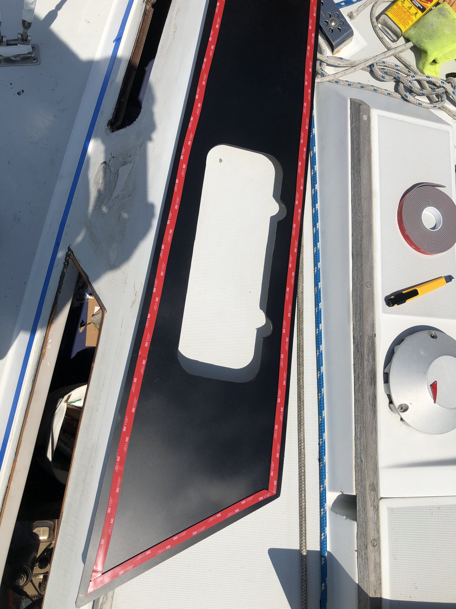

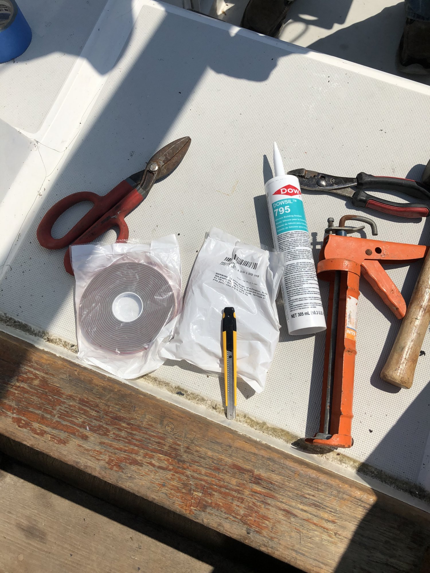

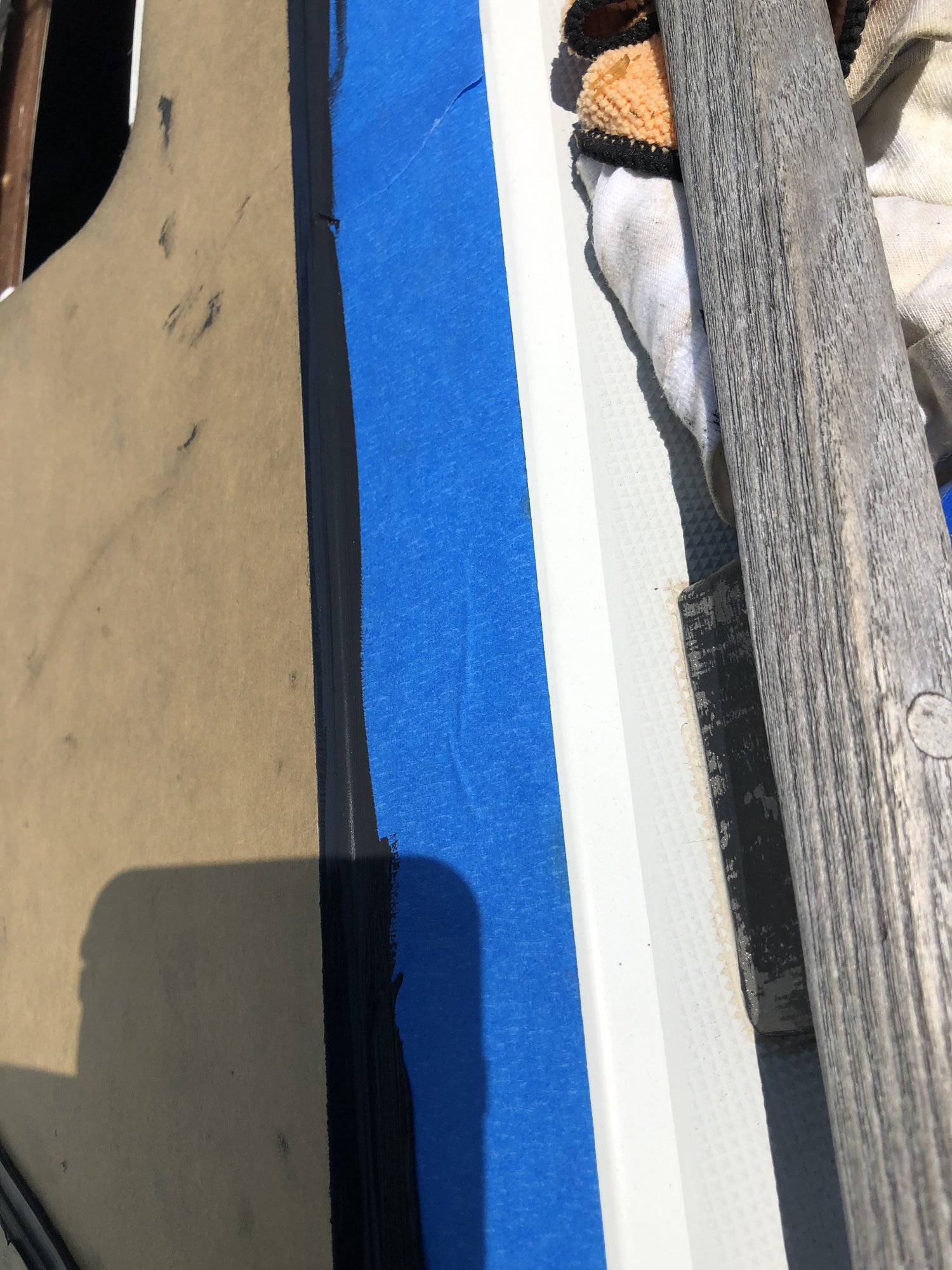

Greg, I did all but one of my fixed ports a few years ago, 1 left. I bought them from Rudy. Big change from the old days on how you mount them. No more screws, they lead to cracks as time goes on, and were only used to keep the window in place while the Dow 795 sets up. Better way is to use 3m VHB double sided tape to keep the window in place, and the 795 around the perimeter. No screws. You do need to spray the areas of the port that don't carry light into the boat. The windows from Rudy come with brown paper adhered to them. Cut out the part of the paper that needs black paint, spray them up, then remove the rest of the paper backing and mount. I have pics from when I did mine if you want.

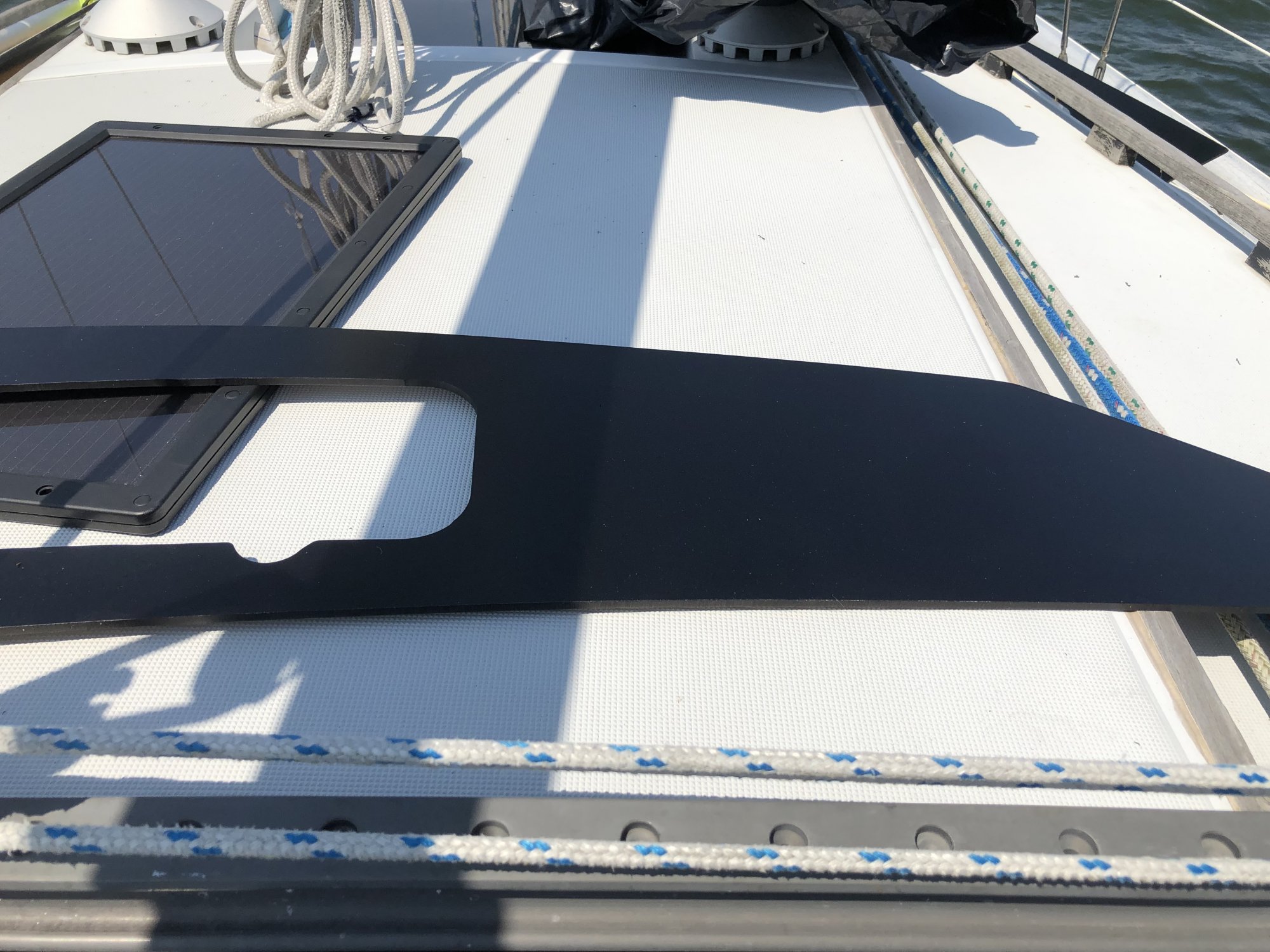

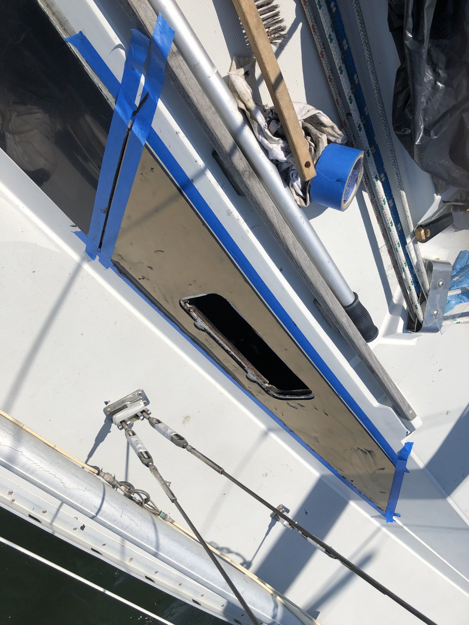

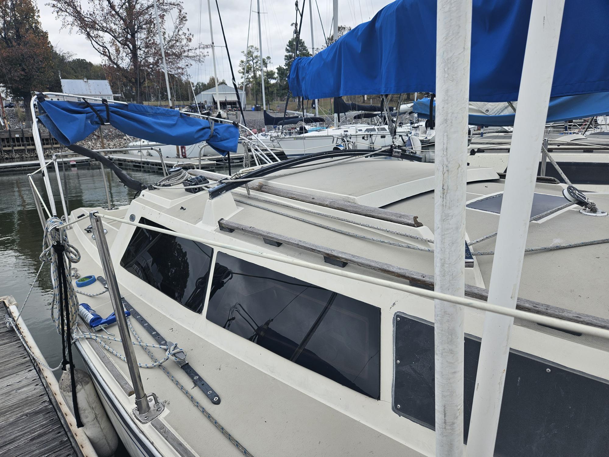

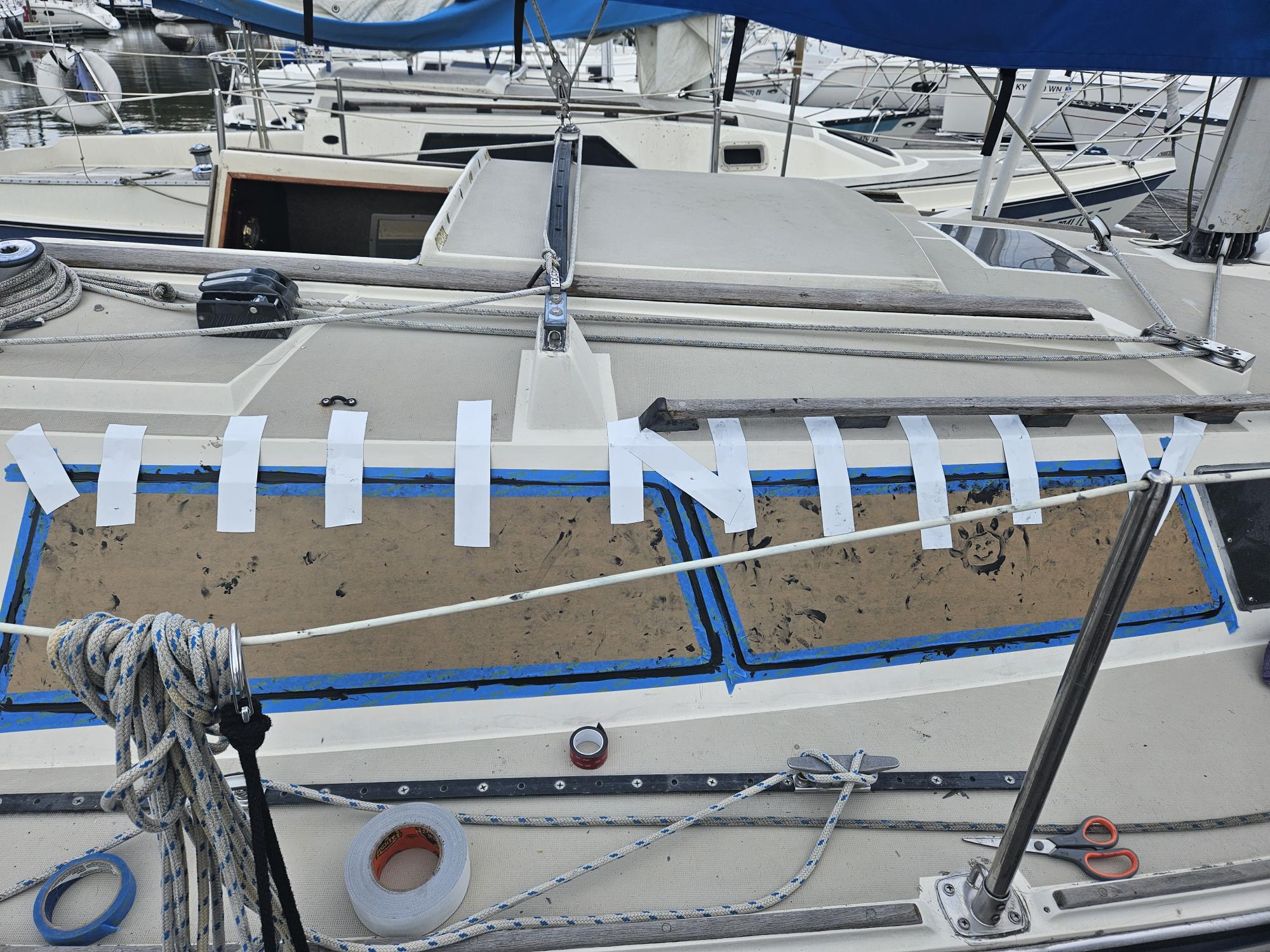

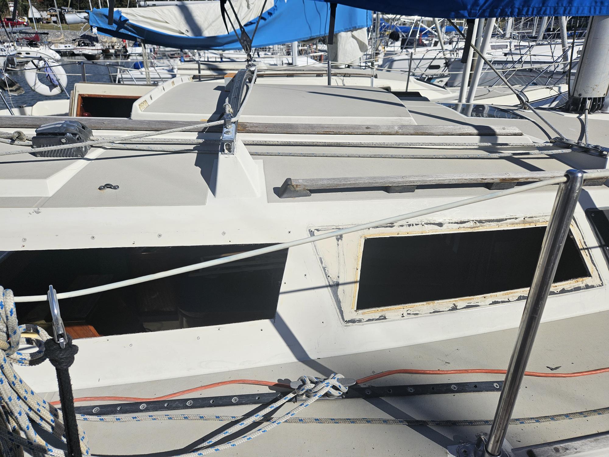

I attached my photos below. It was not really as difficult a process as I had feared. With some emotional support from friends, we got the job done with no issues. The only mistake I made was not pulling off all the paper from the inside before installing. Some remnants are visible on the perimeter that I will have to remove with tweezers. Otherwise, they look great!

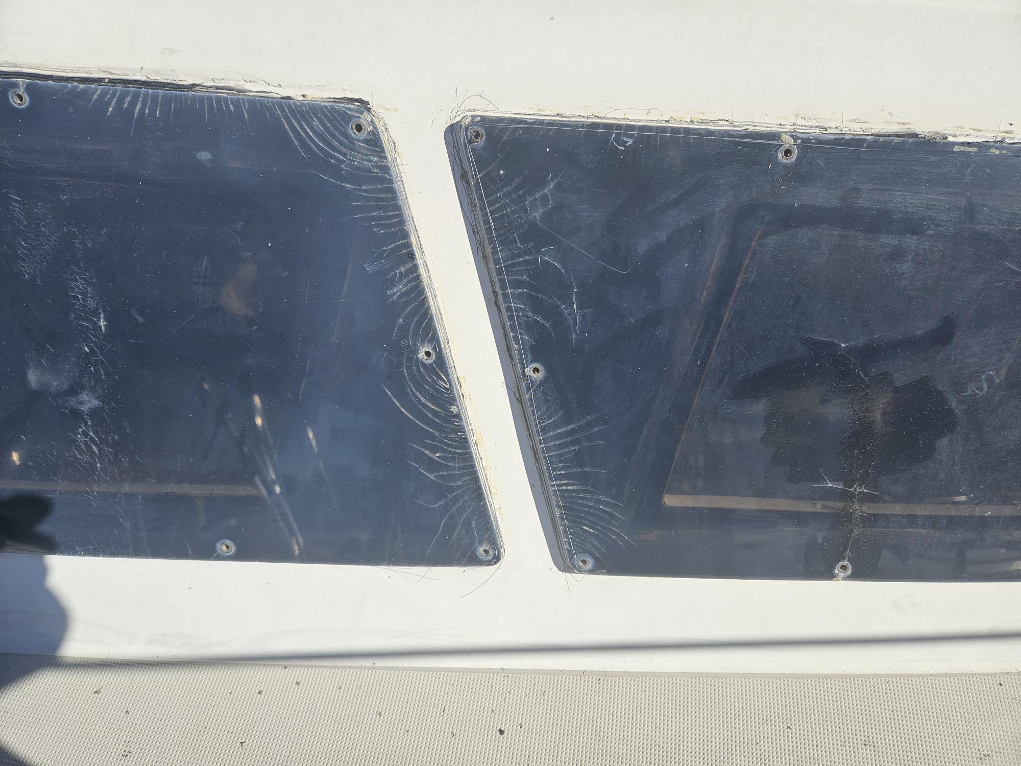

A few of the pointed tips are cracked off, and there is some crazing, but I can still see out!

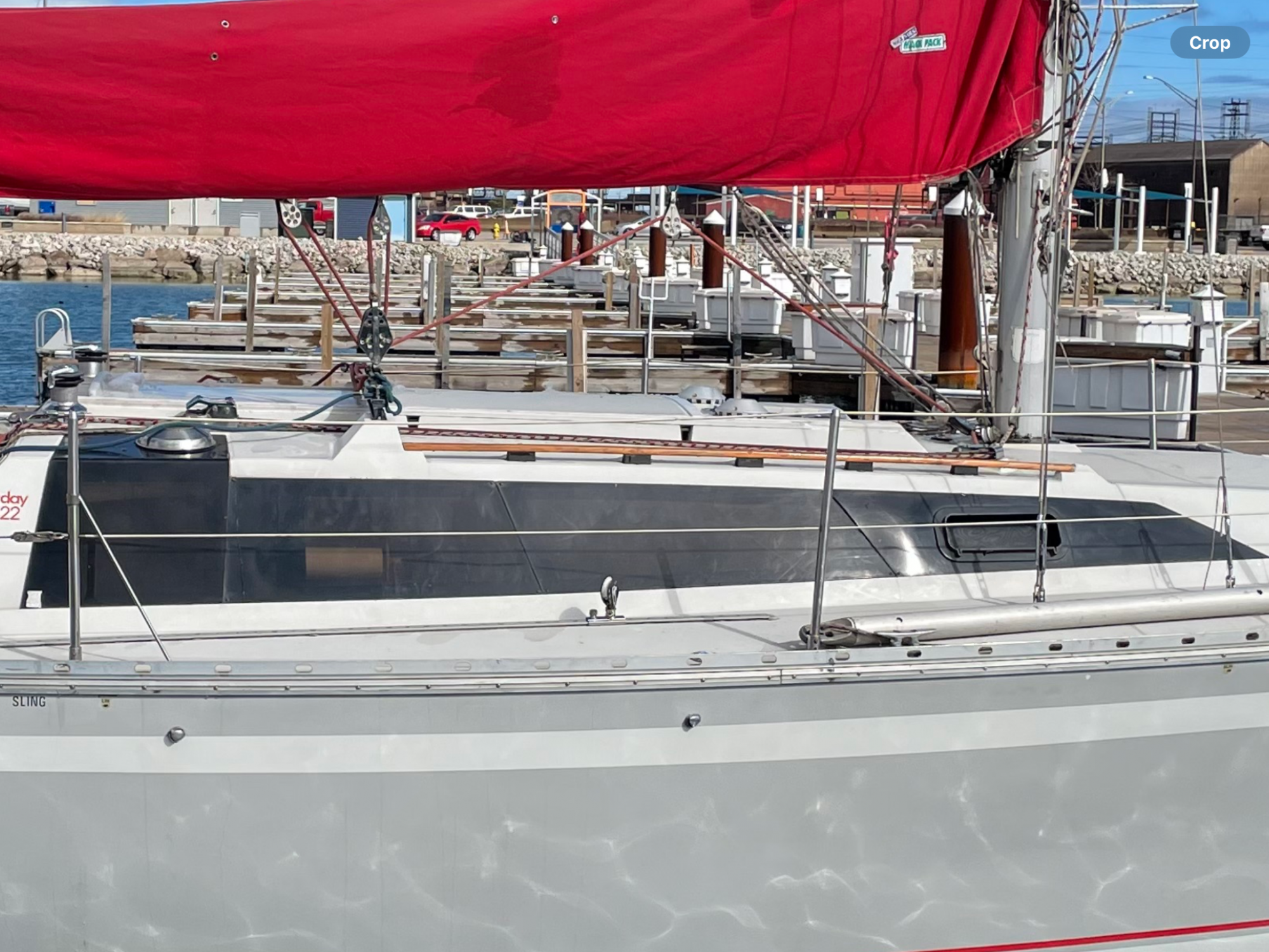

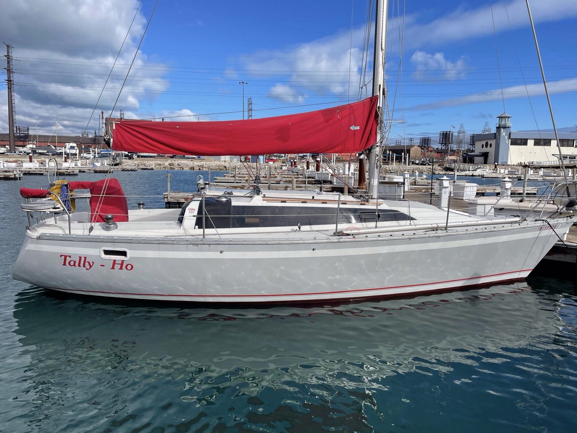

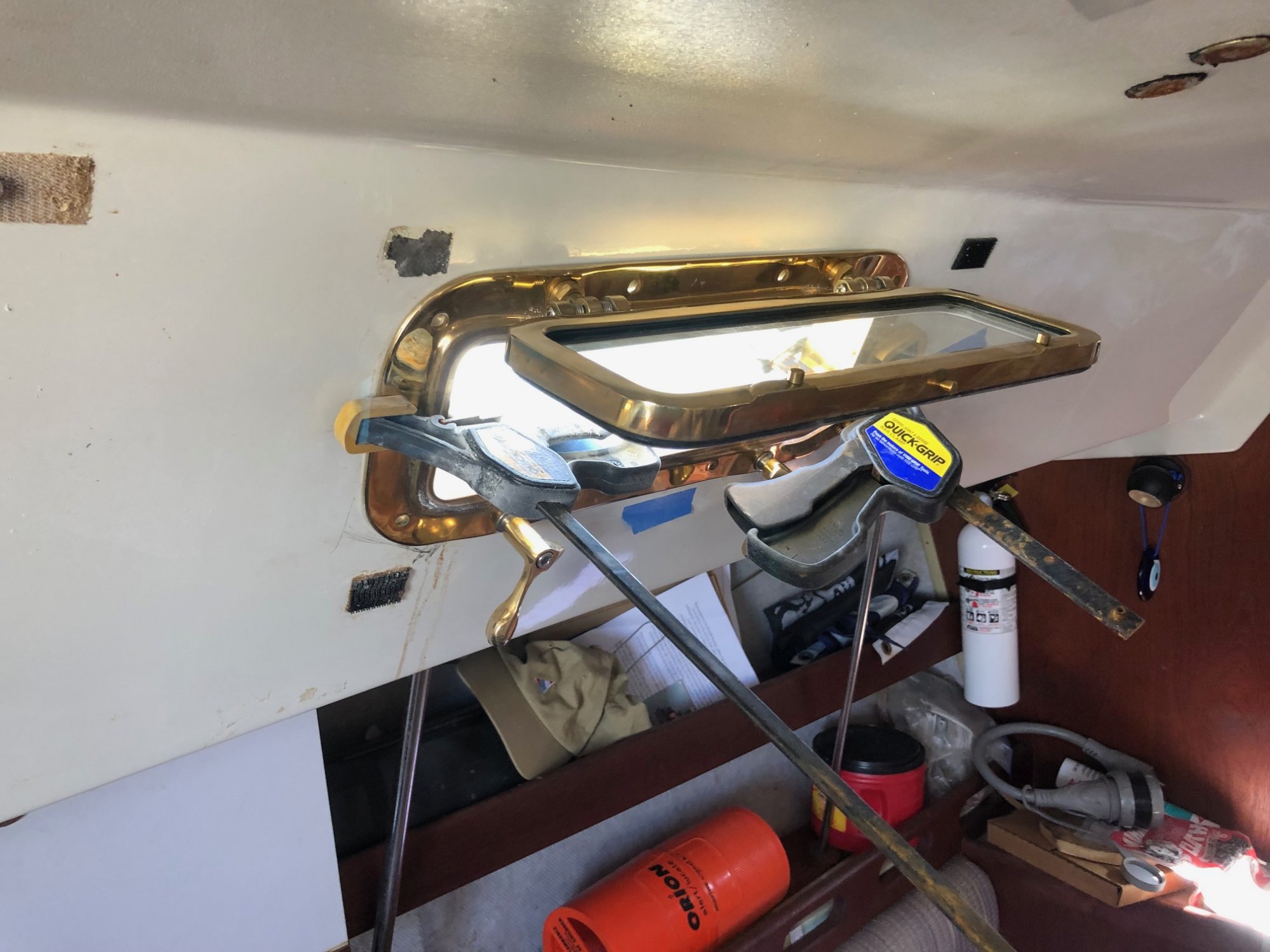

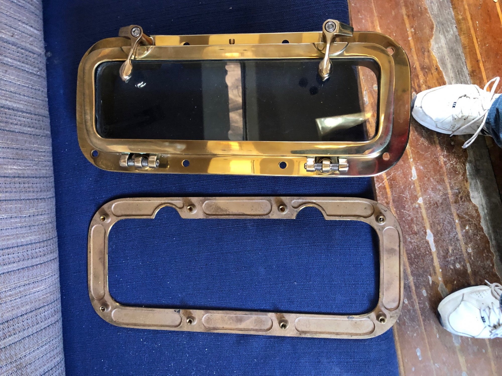

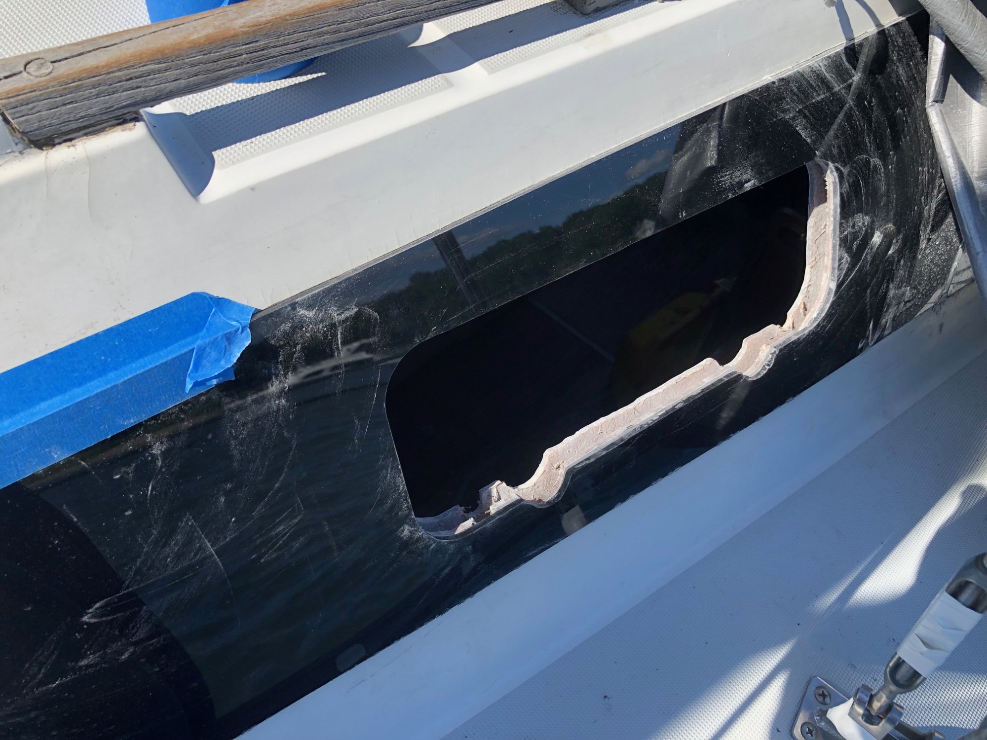

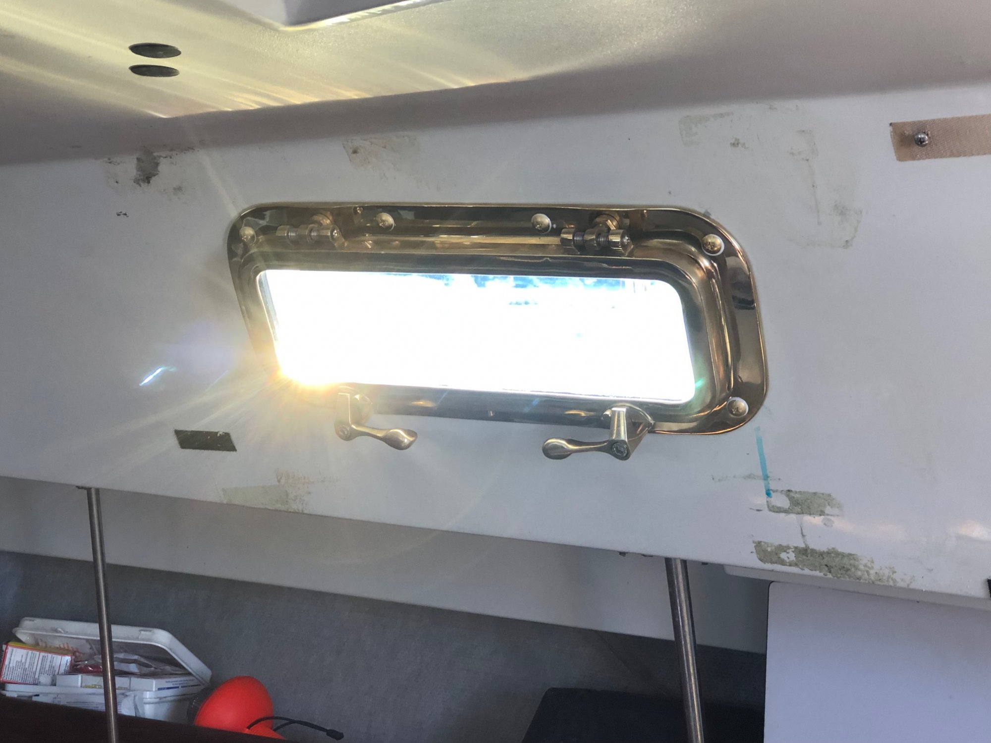

I replaced 3 out 4 fixed windows, and replaced the plastic Beckson ports with some nice bronze ones from New Found Metals. Here's some pics. Took a few days, and was messy, but came out great! I just took some Brasso out to the boat today to get that polish back on the port lights! Rudy cut the holes out for me free of charge for the bronze port lights! Good man...

I added pics you can see, and yes, I went with bronze ports. I also had some leaking from the forward starboard window, and not a drop since I replaced them!

Looks very salty! Nice work.
