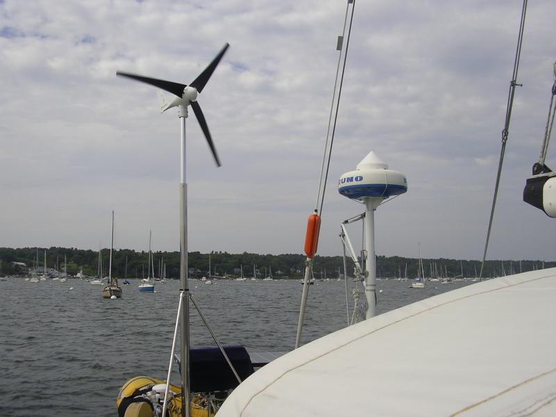

Hi all,
We have added a MarineKinetix wind generator to supply more energy to batteries aboard our boat. All the work was primarily done by a very knowledgeable individual from Compass Marine. I did pull the line from the transom to the engine room with the help of my wife and only had to pull the last ten feet two times, twice. The only slow-down was when I asked questions (I had two years of them stored up). By the time I left the boat it was turning out 4+ amps at about 11 Kts at the masthead. This should keep the drinks cold and its a lot quieter than the generator. Thanks Rodd.

After a little sail today my daughter & I went around the anchorage to check out all the wind gens. Three were in brake mode (not spinning) and six were ripping away (we did not get to all of them. Your was by far the quietest. Barely audible from about 15' away. The next quietest in the anchorage was the Superwind but it was a bit louder. A couple of AirX types were borderline obnoxious..
When I went back to reprogram it I could not hear it in the cockpit and physically had to look at it to confirm it was spinning.

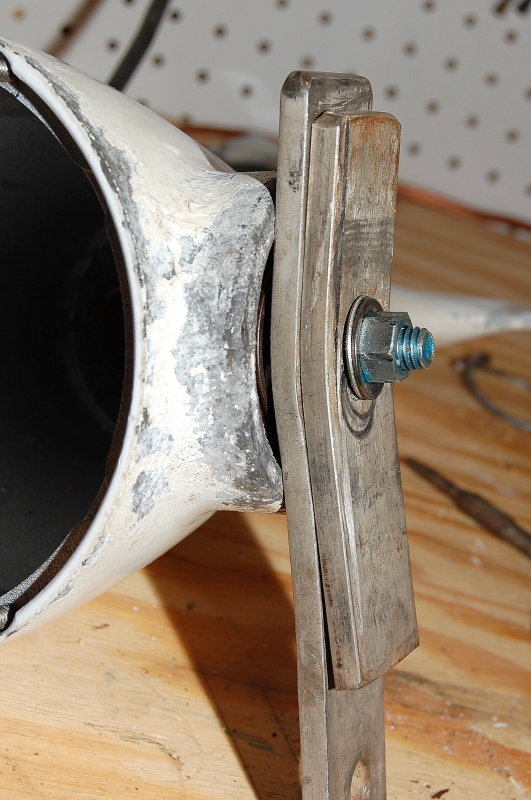

The bearings in this one were so corroded into the housing that it physically bent two pieces of 1/4" stainless just trying to press them out... "marine grade"??????:doh:
