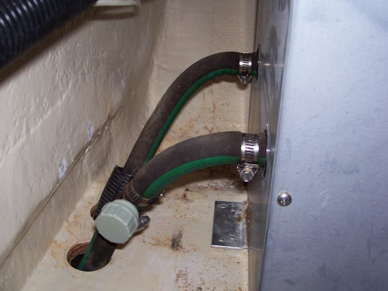

On my 2000 Hunter 340, it came with a Seaward S600 heater, I have replaced it twice and always with the same model (6 gallon). This was due to the very limited access space it is located in. I have about 3/8” (maybe less) of space from the top of the unit to the under side of the settee seat. All the other water heaters available are just too tall for my use.
Check your heights and widths in your location before buying.

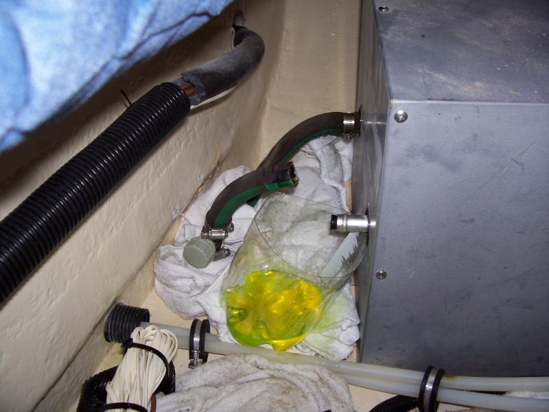

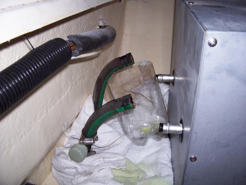

I didn’t get a whole lot of coolant loss when I disconnected the lines from the back of my heater. Maybe a cup or so. And that’s easily replaced at the engine. I don’t think you really need to cap the ends as you say and it may not be possible anyway once you loosen them from the heater.
Just have a good supply of absorbent towels or padding under them. Engine antifreeze is a mess to try to clean up.
Here are few photos of my replacement for you to see the amount of fluid and location as a reference.
I don’t have a mixing valve, probably should, we’re just very careful of the water temperature. It is hot!
Hope this helps you out.

Sailcapt340 - thanks for your input. What a great idea to use a ziplock / plastic bag and towels to catch the coolant!
Thanks Again. Chris
