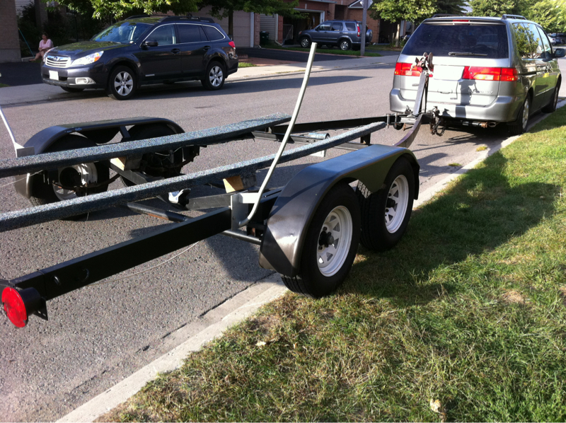

I'm pretty sure that my trailer was upgraded from stock macgregor by PO. It now has dual axle, electric brakes and load equalizing hitch. It tows very well.

Fred... What make and model is that? How does the board sit/ride on the full length bunks?

I am planning to retrieve my trailer from summer storage in a week or two. I will take some pictures of the axle mounting and bunk details at that time.

I have a non-Mac trailer that a yard put together for me when the original rusted out (and stranded me suddenly).
Our car doesn't tow a lot of weight, so am going to go aluminum on the next one. Anyone have suggestions, besides two axels, what to consider? I planning on scrapping this one next year.
