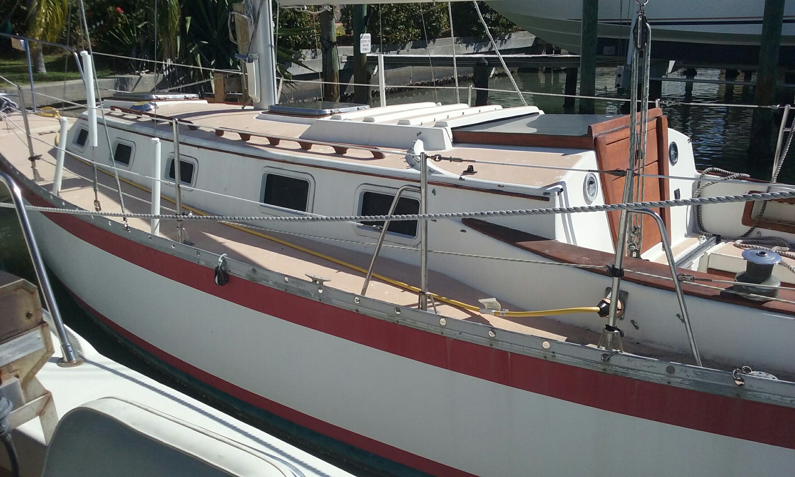

Endeavor 32. Neglected now, but looks like it will clean up nicely. I'd like to see the "after" pictures when the time comes, and a proud owner.
