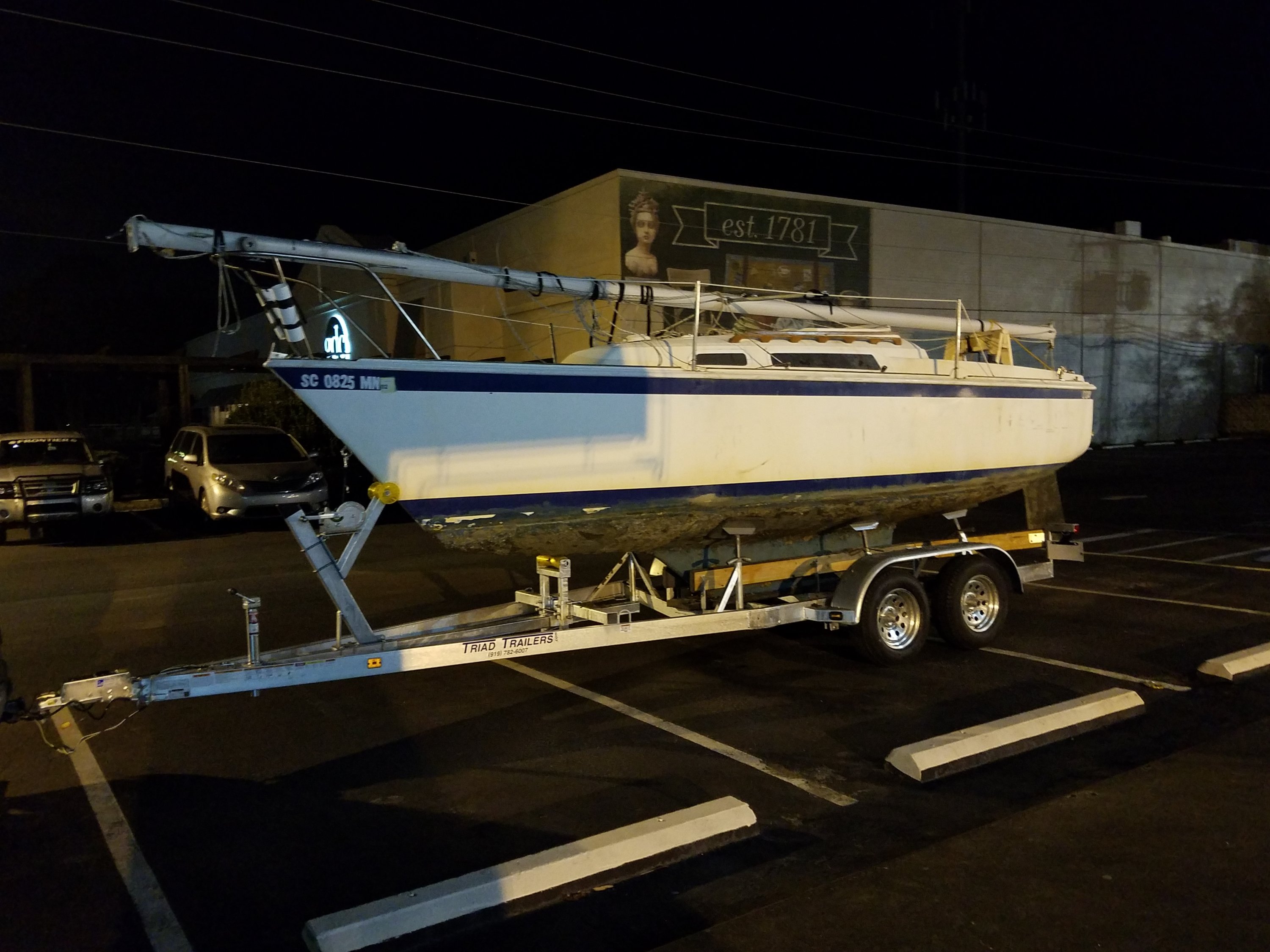

Hi, we recently bought a 1978 23-2 to learn to sail on. She is in pretty good shape, but one thing that needs looking at is the centerboard. I will have to lift it off the trailer, but as I have never seen the underside of the keel I am unsure how much clearance I would need. For the sake of safety I would like to set it on blocking at the front and rear of the keel, is there room to do this or does the CB slot extend too close to the front and rear ends of the keel? I appreciate any advise or recommendations you could give... 20170205_203235.jpg
