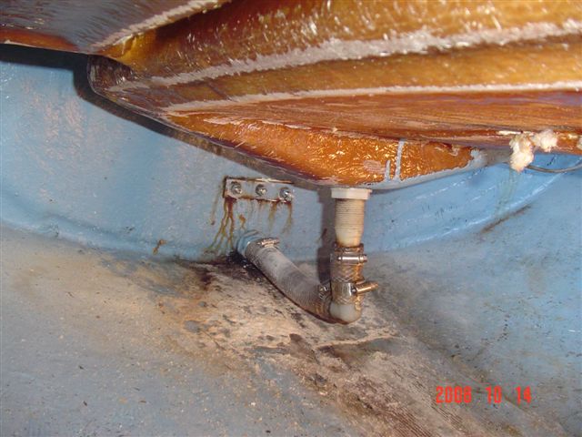

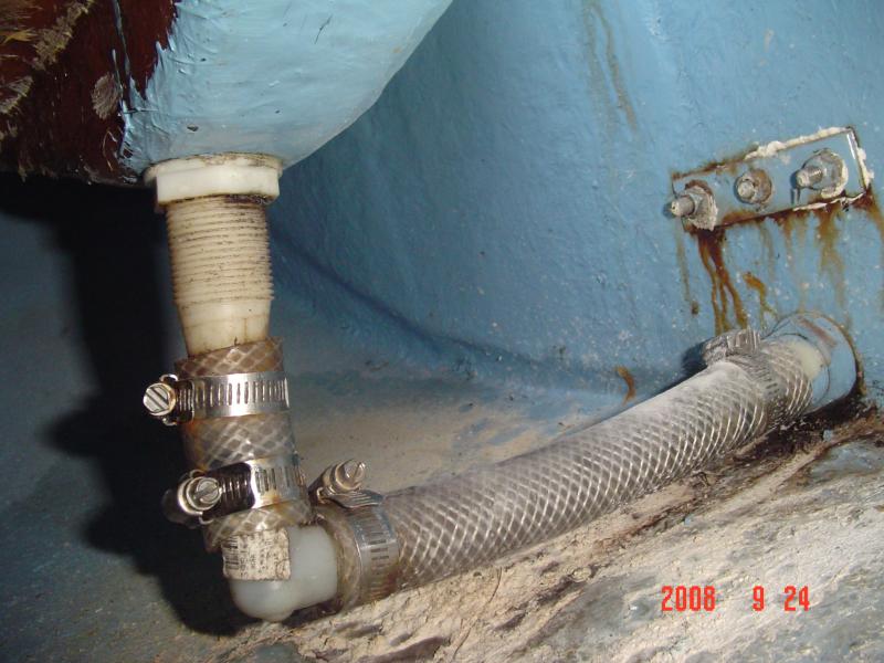

I am curious how the factory put the cockpit drain down in there if no one can fit down in there? Maybe had the boat on its side, lol. Yeah, a deck plate would provide much easier access. So you put the deck plate on the vertical section (transom) above the drain??
I'm not sure how they installed the hoses in that area but your O'Day 222 has a single sheave block way up inside the centerboard slot for the centerboard pendant line to ride through, and this sheave/U bolt assembly was inserted through the bottom of the lead keel with a long tool.
Yes. I cut a hole in the center of the inside transom for access to the hose. I think it's one of the smartest things you can do on this boat. It allowed me to remove and rebed my gudgions all by myself without any help. It also assists me in installing and removing my outboard charging wire twice a year. So it's an access plate that can be used quite a bit.
I made some changes to my hose. The original hose was a bent rubber hose and I used a regular reinforced vinyl hose with a 90 degree L fitting and four stainless steel hose clamps. This stuff can be purchased at any hardware store, Home Depot, or Lowe's.

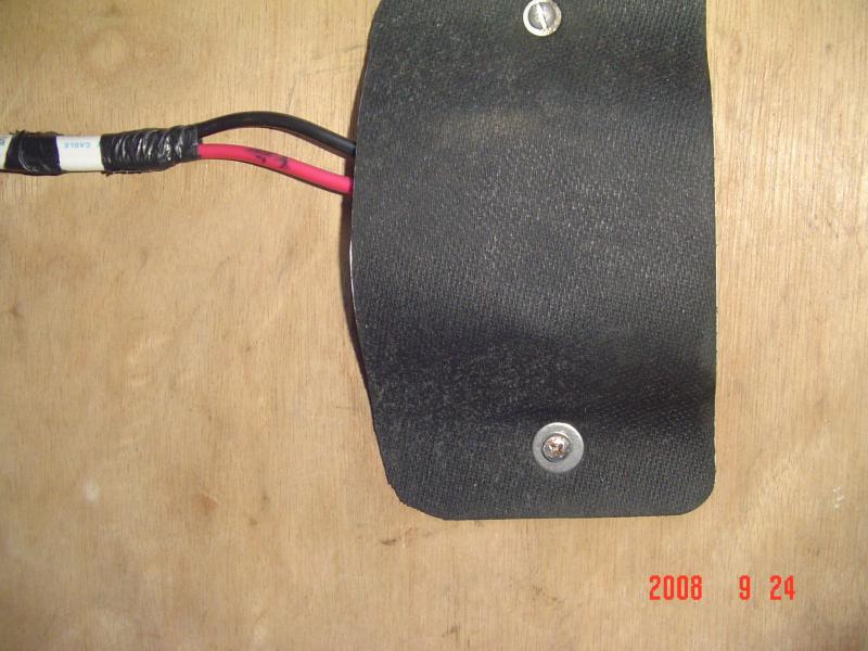

The outboard charging wire in the pics is a #10 copper stranded duplex cable that I installed on the engine. It runs over the top of the transom through an outlet hole and around to the bulkhead just under the lazarette cover. I mounted a term block for this wire and covered it with a PC mouse pad to prevent any metal from coming in contacts with the wires. I crimped some eye connectors to the wires with another set of wires going to the house battery from the other side of the term block.
Where the duplex wire enter the outlet hole on the inside transom, I pulled enough wire through so that I can get at it through the access hole to run a few beads of tape around it. Then I pulled the cable back up to the tape and added some caulking to the cable at the outlet to keep moisture out. The term block is a better connection than any marine outlet and plug that can be bought at "Worst Marine." It never gets corroded and has great current carrying capacity to keep my battery up. At least I never need to bring my battery charger down to the dock like I did years ago before I made this change.
