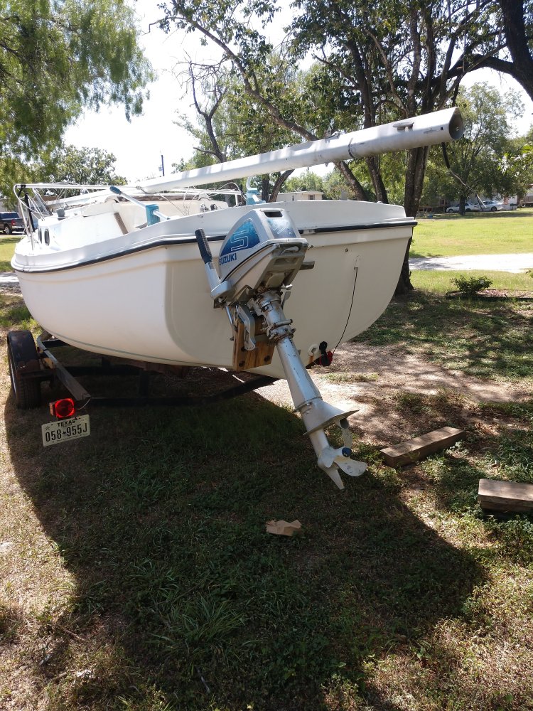

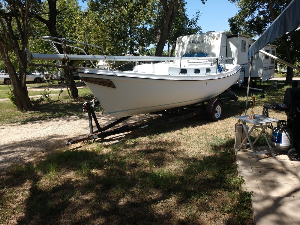

Just aquired a bit of a project boat
Surprisingly seems mostly intact for the little I paid. But For being 38 years old, it's not perfect.
I joined this fourm to hopefully find some information. I haven't found a coast guard capacity plate. And currently its equipped with a 1984 5hp 2stroke Suzuki outboard. I presume that is within specs.
It appears to have a self bailing cockpit was this a factory thing. I'll probably reseal the through hull fittings, and change the hose if I can squeeze in there.
I found foam floatation blocks not sure if the factory packed them in specific places or just tossed them in random places. I'm actually curious if I have them all after all these years.
As for making it knock down ready looks like the cock pit battery hatch can be sealed shut from the inside cleat. But what keeps the poptop from possibly opening mine doesn't appear to latch closed
I'm thinking about adding a automatic Bilge pump. I'm not sure
Where I should place it. To drain excess water that may appear. I have not dropped it in the water yet to find a low point. I'm assuming near the mast foot should be the lowest area.
Maybe there's a few extra things I should look at like the swing keel setup, do those pins need replacing. Or are they good for nearly ever. Maybe it's a good time for me to add some lighting protection too
As for battery I've had two sailboats with battery setups that seem to rely on the holy spirit holding them in place. I don't get a good feeling seeing the battery power cables holding the battery in place. Any suggestions.
You could install some keepers.
Yes.
Likely under the keel winch.
Yes, those bolts need periodic inspection. Lightning protection is a crapshoot at best.
Figure some way of strapping the battery in place. Maybe even a battery box.

Yes a major flaw in swing keels is your damned if you do or don't lock the swing keel. But in the event of a knockdown that keel swinging can do major damage compared to a bent pin Does the 23 even have a swing keel lock pin. Maybe if I knock down mine the black widows will let me check :). So far I've noticed, besides the keel plowing into the trunk that if the hatches are left open the unsecured foam can float out. Im a bit short on photos at the moment. In her current condition she won't win a beauty contest. I still have a bit of examination to do. Interior looks like I'll need to fix a few things Its tough getting in and out with the mast laying down, and Previous owner, still has some things I need to clean/trash out. Maybe I'll find some electronics. I have accessories mounted for a 2004 era GPS/Fisher finder. Haven't found the unit yet, not sure I will. Not sure I want too after looking at the newer units with chirp Like the raymarine dragon fly series. I'll need to shoot some photos. Looks like factory sails, no tears not much wear.

May I suggest you mark all the mast stays and remove the mast until all the hard work is done. I see a trailer in the background and that would be a good place to store it, either above or below to keep it out of harms way. Stuff something in the open ends to keep critters out.
A support under the the back or the trailer or the boat will keep the bow from pointing skyward should you move to far aft.

I'm excited, I definitely will be doing some rework on a ton of stuff. Leveling blocks sound like a good idea. I may add some forward wieght on the trailer. Not sure if itll work yet but I'll need to tear into the trailer with a wire wheel and paint. In the long hitch tube I might be able to fill it with lead and cap it in concrete, and add a front jack.
It would probably help a little on a slippery boat ramp. And add some downward force. I also have a place nearby that does hotdip galvanizing. I might look into that but it sounds super complicated getting in done I'd have to strip the leaf springs, axle, ball hitch, wood, paint, and rust. And have it off the trailer...
