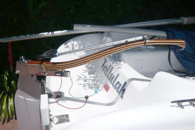

I used an Ida Sailor tiller made for a Hunter 25.5 to upgrade my H15's tiller. I ordered it with their 4 coat of varnish option and then added 4 more coats myself. As I keep my boat in my driveway I remove the tiller after every sail.
