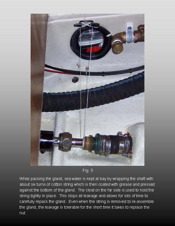

Most likely the only way to correct this problem is to learn to pack the gland yourself. As previous posts here show, many boatyards are notoriously poor. I would suggest this is your problem.
Even if your boat is still in the water, packing it wet is not a formidable problem. However, I would suggest having an assistant nearby the first time you do this.
This is a very clever solution, but it may or may not be needed depending on the rate of flow in relation to your bilge pump. On my last three boats, my bilge pumps easily kept up with the flow and so this would have been unnecessary. But your boat may be different from mine, so keeping some string handy (with some attachment points) seems like a good idea, at least the first time you do it. This looks like an elegant and simple way of handling it if you find it necessary to do so.
