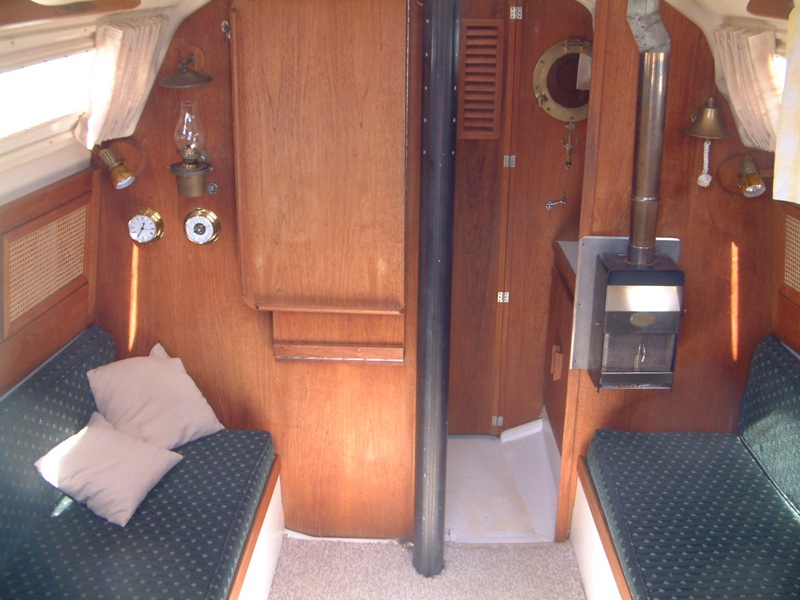

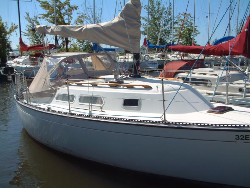

We had a Force 10 solid fuel fire place installed on our last boat, a Paceship 26. It was there when we bought the boat and we used it occasionally at the beginning and end of the season. I fed it small chunks of wood and it produced a good amount of heat but required constant attention and you had to be very careful that any wayward embers did not land on the cushions.
An interior and exterior pic is attached.
Matt

Matt,
your setup looks similar to how I was thinking of installing mine, the only difference is on my bulkhead the table is on the starboard side, so I was thinking I would mount my heater over the port settee. How often would you get wayward embers??? Was that something only when adding fuel? Also what is the backing material behind the heater?

The backing material behind the heater is a thin sheet of stainless steel, mounted in .25" standoffs to provide a little airspace between the bulkhead and the sheet. There is at least another inch or 1.5. inches of agap between the heater and the stainless.
Embers were not a big issue only every once in a while when addine more wood to the stove. What we did to save the cushions was to take an old towel, fold to fit, and put it on the cushion below the heater.
We sis get the occasional bit of staining on deck, but never enough for it to be a bother. Come to think ofit, most was confined to the chimney top. It would loose it's shine and be a duller color.
Hope this helps a bit.
