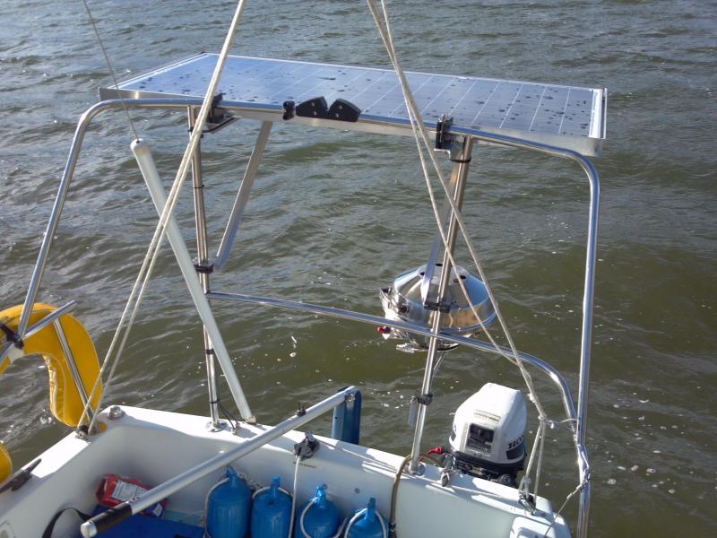

newly installed 130w solar panel works great!!!
this past weekend was the first trip with solar power.... it is a wonderful thing!
with the battery fully charged when we left on friday, we used power well in excess of what we would ever normally use so that I could check to see how fast the battery would recharge the next day.... i estimate about 22amps used friday evening with some usage of the twin tube florescent thinlite... it gives a tremendous amount of good soft light, but at a high 3amp draw.
by 1
clock saturday afternoon, which was very sunny and hot, I noticed the blue sky MPPT charger was in float mode.....
on sunday the weather was not as sunny, but as we didnt use as much power saturday night, we still became fully charged by noon on sunday.... and monday,(today) was about the same even though it rained ALL day.....
the solar power will change the way of life on our boat, as I can already feel the addiction building
