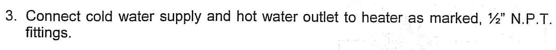

The Whale manual indicates:
  • The requirements for NPT (National Pipe Thread) are spelled out in ANSI B1.20.1
  • Creating a leak free NPT connection involves the use of thread sealant tapes
I would confirm that you have undamaged NPT threaded fittings. If suspect replace. Use thread tape sealant. Assure that the hoses and their fittings are not leaking. Pray.
I used brass ones and a lot of sikaflex 291 sealant. I'm not sure it's really leaking... Last night I spent a few hours and it didn't have any water in the bilge.
