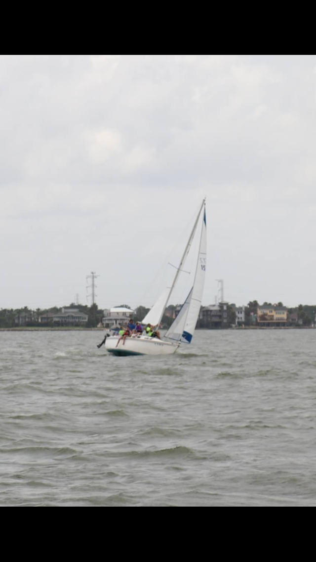

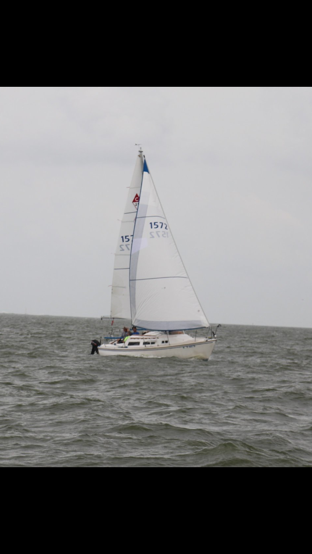

Sailmakers here in the Gulf take forever. Ordered my Genoa in January, and it took until June to get it. My, how they were quick to make that main!

I got my new main with loose foot. I just recently read the regs for class racing and captured footed is required. It makes no difference to me, but if I were interested in racing, I'd need a second mainsail.
Just something to think about.
-Will (Dragonfly)
Likes: Simon Sexton
Oct 19, 2017
7,985
BTW, I almost forgot. Great looking boat and nicely trimmed sails. Good to see you out and having fun Simon. Thanks for sharing.
-Will (Dragonfly)
