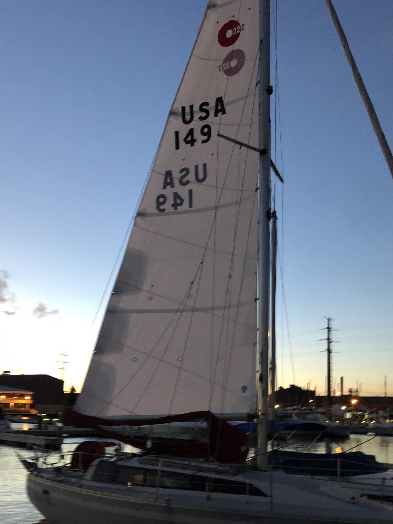

I got a new loose-footed main from North Sail 2 seasons ago. I wanted full-battens, so they recommended a Tides Marine Strong Track…since the battens would create some pressure pushing into the mas.

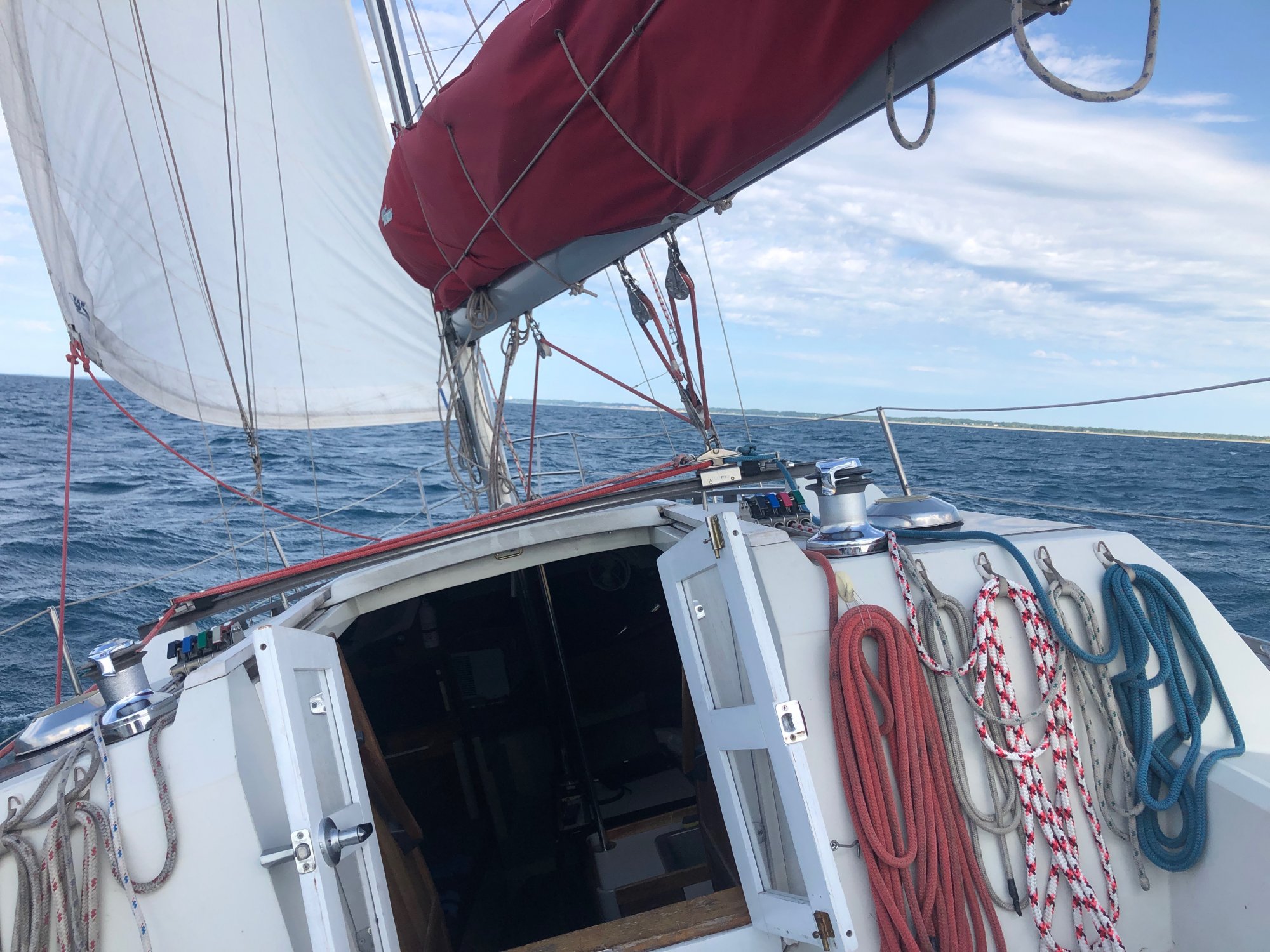

I like the whole set up a lot. Sail shape is easy to maintain (I am lazy and don’t spend too much time on sail trim), raising and lower sail is much easier, and I think I get more power out of light winds with the loose foot (better sail shape all the way down to the boom).
I do have a Mack Pack sail bag and jacks, so in light air, I pull the jacks forward to the mast and roll the bag down and out of the way so the sail can take the right shape. In strong winds, I don’t bother...boat makes hull speed pretty easily.
Enjoy the new sail!
Greg

I had the Mack Pack before I replaced the sail. I had a bolt rope in the foot if the old sail. But no issues with the new sail.
