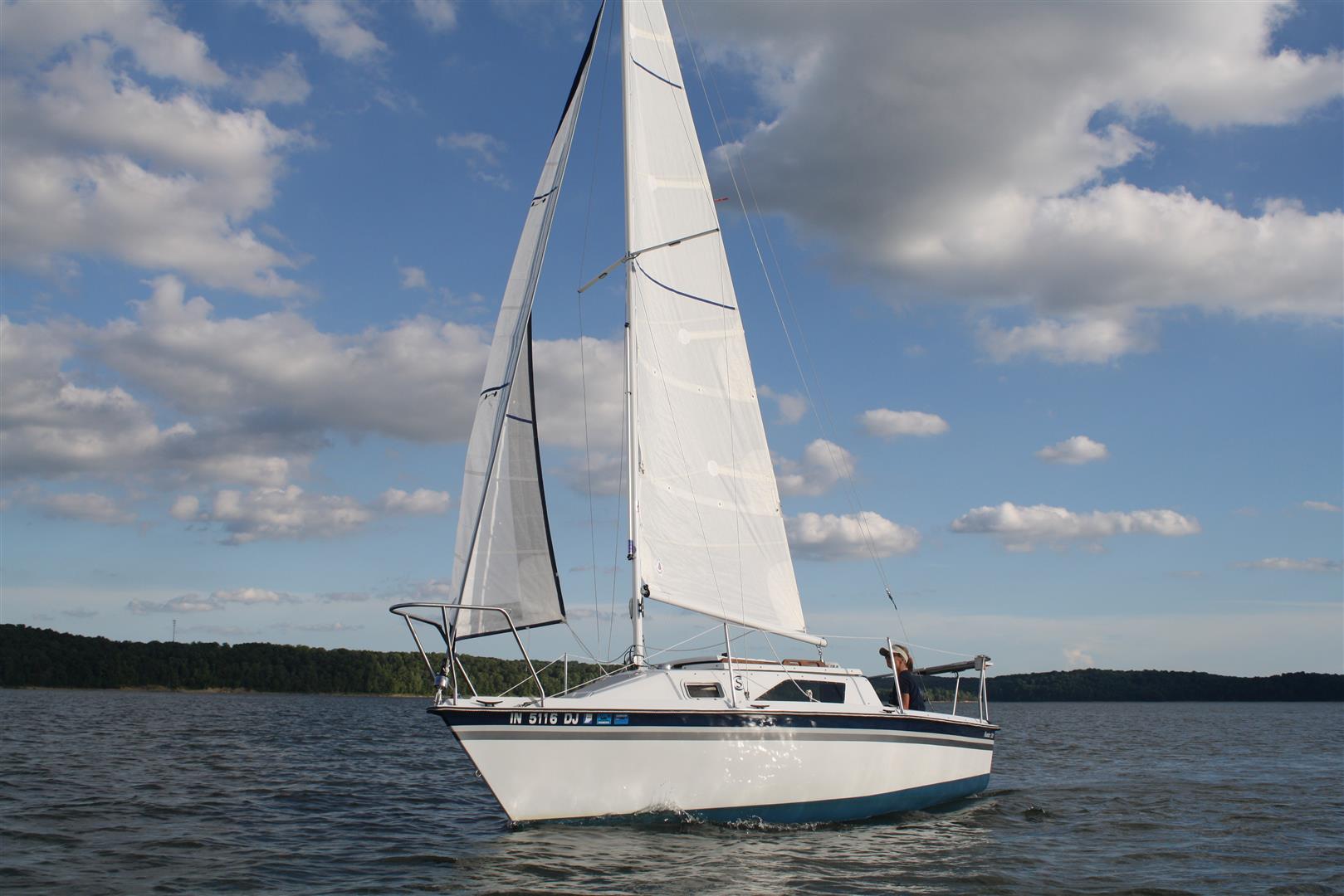

1. We, me, loves having the boom come off the mast at a 90 degree angle instead of hanging down in the cockpit. While we may have lost about 18" of main sail at the clew we sure can't tell it but I am very happy we chose to do that each time we tack and I don't have to duck. Plus it just looks so much better.

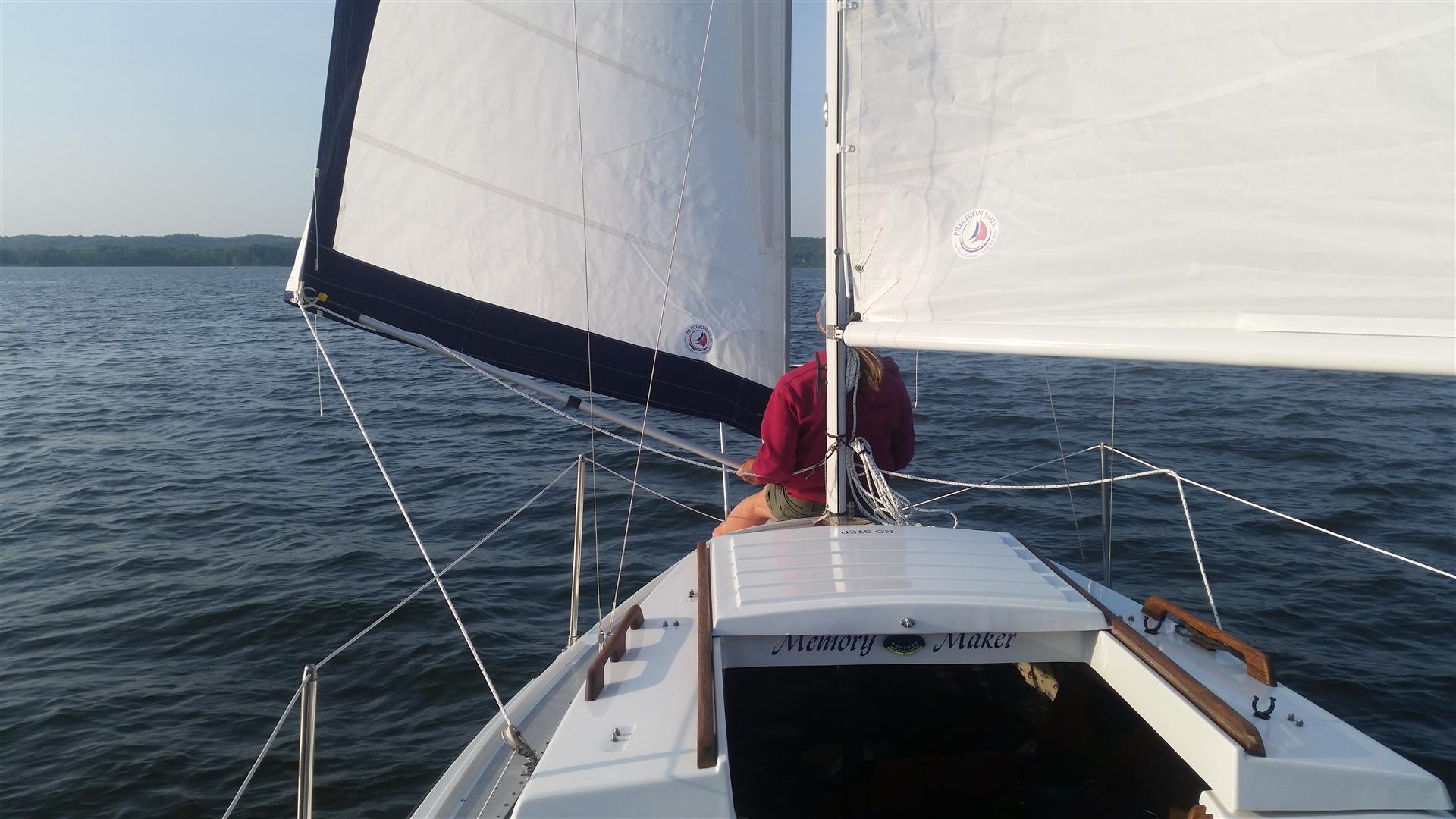

4. Downwind performance is much better with the larger headsail and tighter main but it needs help to achieve that. The headsail curls and flops around more now in light air on a run so we have resorted to using our boat hook as a whisker pole till our actual whisker pole arrives. Here is Admiral Cindy enjoying the ride last night.
We can't pole it out all the way as our pole is not strong enough but even still it is a huge improvement. We made one long run downwind to our slip last night in very light air and made better than 4 mph the whole way. Without the pole the headsail would have been constantly luffing and falling in on itself.

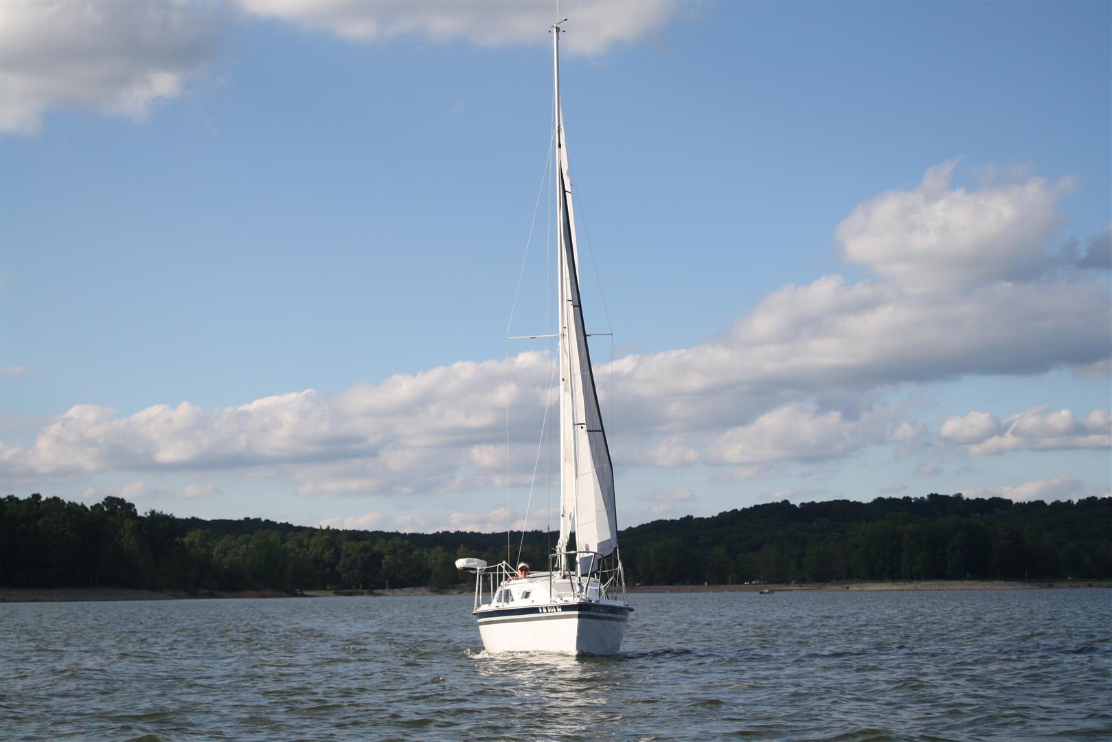

If your really observant you noticed there is only one halyard on the mast. That is because the old jib halyard got hung up on the sheave block pulley when I was pulling the new halyard through and broke the connection. It was oversized to begin with and the thread I sewed them together with made it too tight. I will fish the new one when we drop the mast to head to Canada in July.
