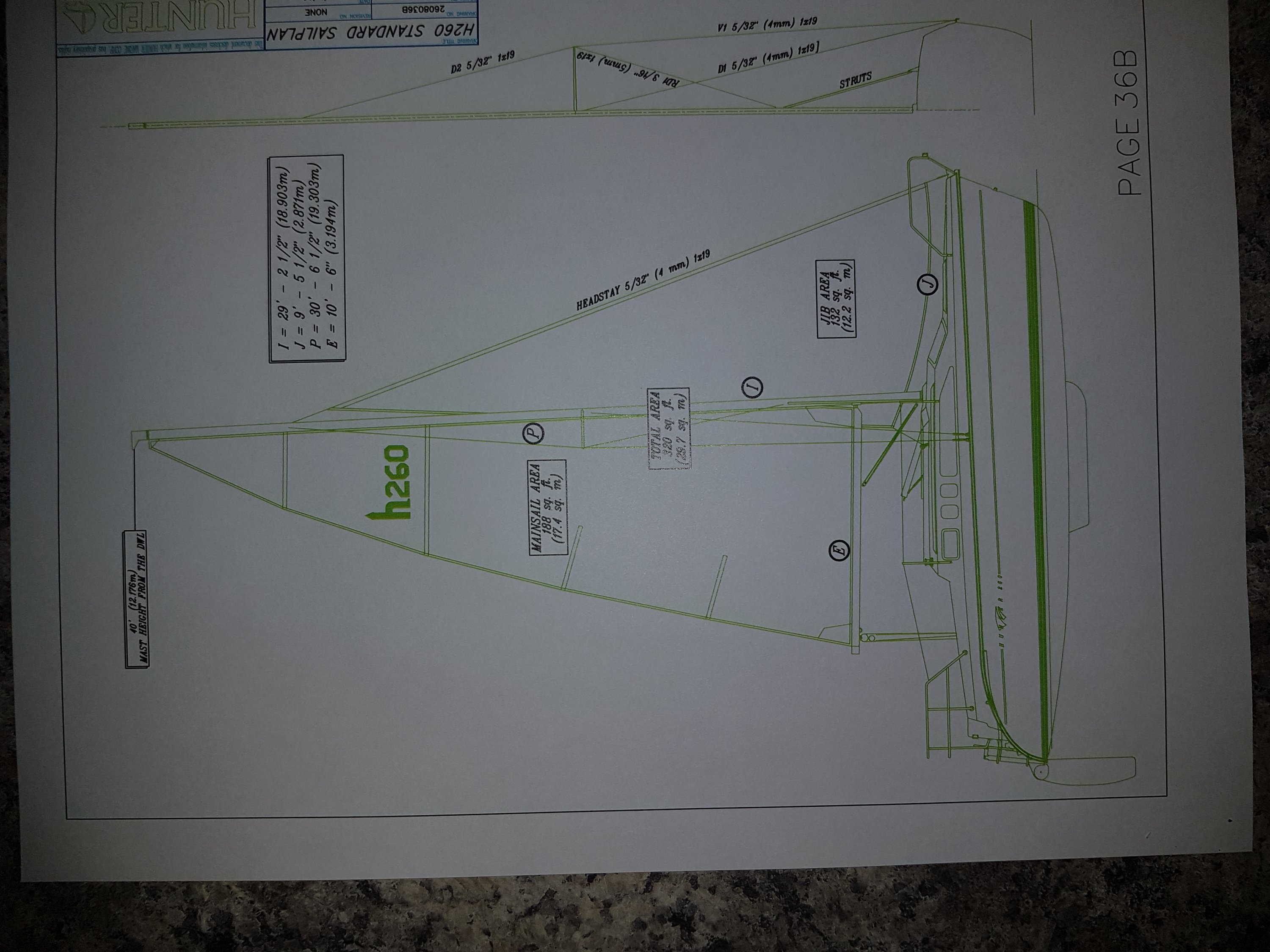

I am ordering new sails for my Hunter 260, both a new main and new head sail. With my boat tucked away or the winter, I cannot get the physical measurements that the sail maker requires. I have sent him the dimensions from the manual and I'm wondering if those measurements correspond to actual sizes. For instance, is the 'E' dimension the mast to the end of the boom or is that the dimension of the foot of the main sail?
Can I rely on the dimensions from the manual to order these sails? As far as I can tell there were no modifications to the mast or boom.

Did you tell the sail maker that the dimensions you gave them were your JIPE dimensions and not the actual sail dimensions? They should be able to work off of your JIPE. All that info is well known by a good sail loft. When I ordered my new sails, I said I needed them for a First 235, not a problem with them.

So, what is your sailmaker doing to deserve your business? Obviously not measuring your boat like a good local loft should do. Sorry to be so blunt but it's for your protection. If you provide dimensions and they're wrong, it's going to be your fault and you may not have recourse in the event modifications have to be made to make them fit correctly. Don't depend on measurements from others either because some stock looking boats have had rig and spar modifications over the years. There are many measurements that a designer would need to know besides the IJPE dimensions. Roller furling and genoa lead locations are just a couple that come to mind that aren't taken into consideration with just the IJPE dimensions. Measure twice and cut once! Proceed with caution.

The deminsions in the manual and under boat information for the 260 is spot on but a lot will depend on the furler and how attached at the deck or raised. Best advice is the suggestion to measure the sail or better yet, send it to the sail loft for sure. Yes it will cost but if the loft has the sail and screws up, that will be on their nickle. Also the forum store does sell the main and jib for the 260 so you might want to check there and they do work with you. For the jib on a furler, do get the sunbrella edge and you will need to tell the sail loft which side the sail furls out so the cover is on that side.

If not, the jib will be a particular concern. First you have to factor in the shorter luff if a roller is used, and the BIG issue is the max size of the sail as the rig is non-overlapping. Of particular interest will be the position of the clew to get a good sheeting angle to the tracks, and the hollow of the leach to keep the trailing edge of the sail off the rigging.
The main is simpler, but any mast rake will effect the angle at the tack, and he will also have to know how much pre-bend is dialed into your rig. Also how much roach? More will be more powerful, but might snag on the backstay in lighter airs.

Only up to a 110 job lapped can be used on this boat due to the spreader bars , deck and chain plate arrangement. You have more or bigger main for power vs a standard boat main
