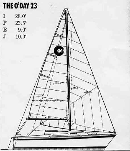

The way I see it: There's no rule prohibiting it. A copy of an old O'Day brochure has a diagram that at least suggests large genoas were available as original equipment. At 135% I don't believe it's larger than any other headsail used by O'Day 23's at the club while racing, and they've never been protested. So anyone who complains is protesting not the sail but the fact that I'm winning. Or maybe the material.

There is no such thing as an O'day 23 'One Design'. Such a rule would mandate the one or two sails that can be used for racing. For most OD boats, it is a 100% and if a second is allowed, a 135,140,or 150. As nothing like that exists for the 23, you should be allowed to use the biggest sail that PHRF allows in your region without a penalty. This is either a 150 or 155%. That picture shows at least a 150%. The trick is getting the right sheeting angle to the block.
