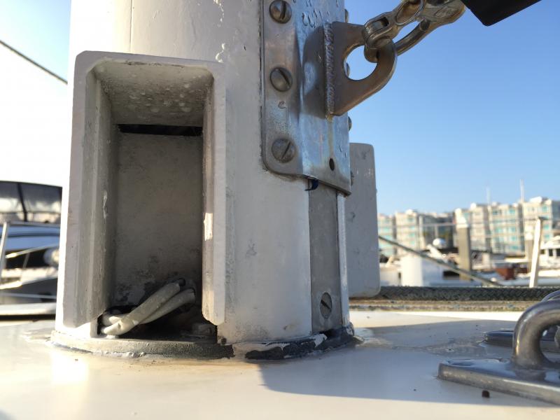

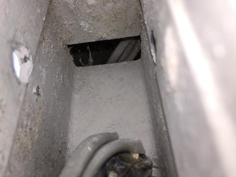

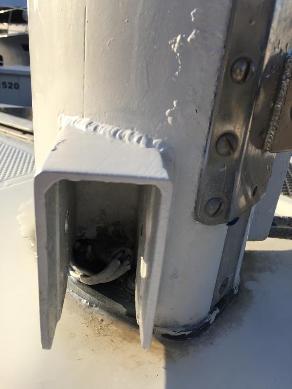

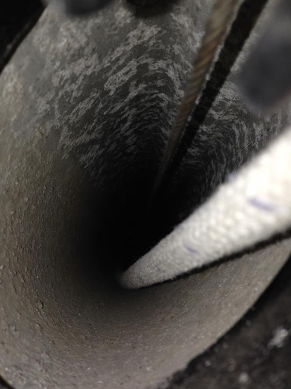

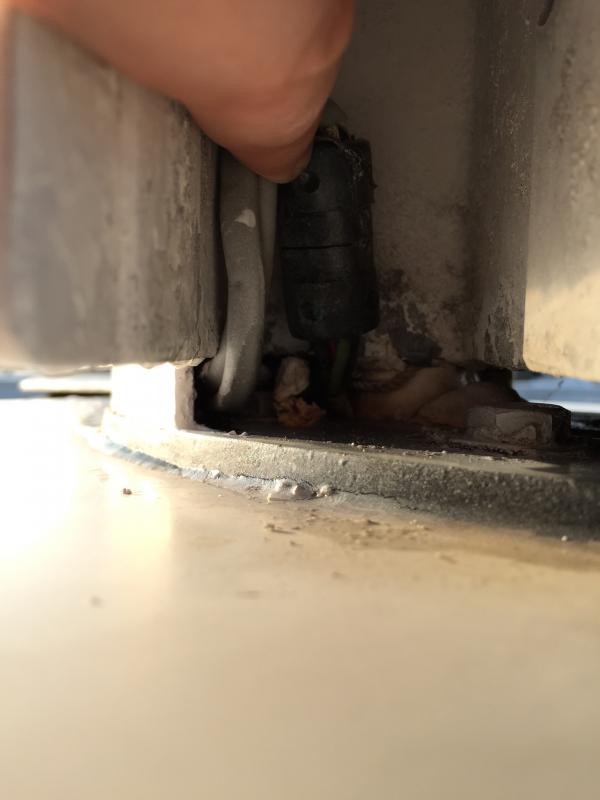

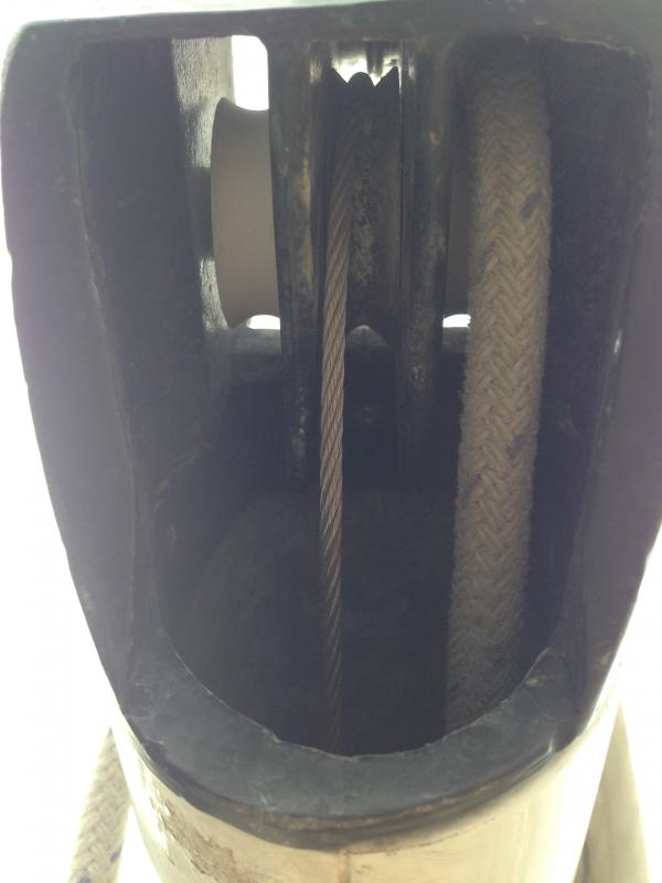

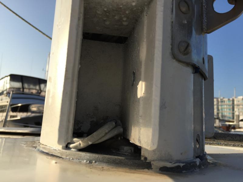

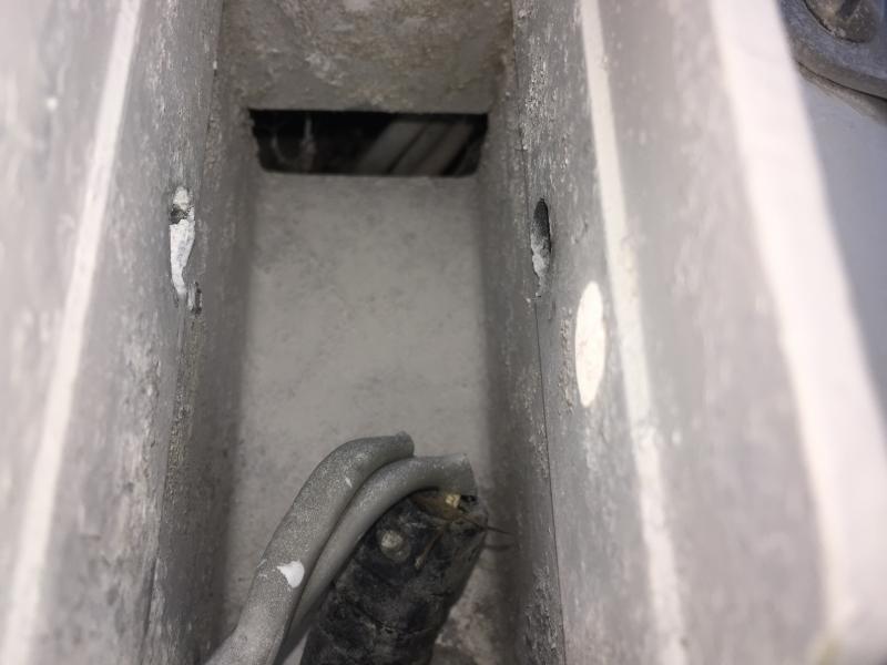

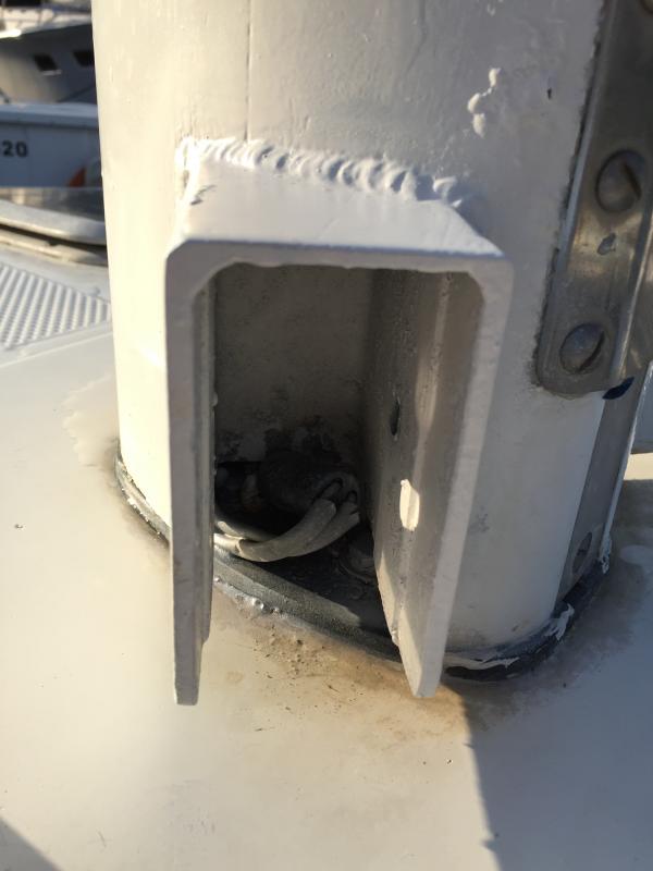

Sorry for the delayed response. I discovered a few issues when attempting to run the new halyards. On the starboard side of the mast a have a headsail and main sail halyard that I currently use. I would like to add a back up set on the port side. When I removed the bottom sheaves to access the port side of the mast I found a wiring harness and connector taking up a lot of room in there. (see pictures)

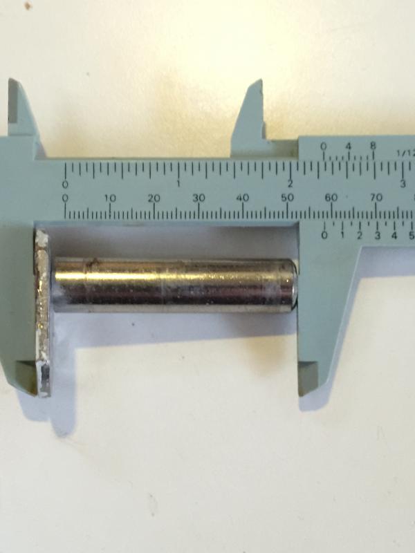

I subsequently broke off the tab from the axel sheave in the process. I've already order the replacement part from RigRite PN K-11669 Sheave Axle Pin w/ Fixed Tab 1/2" x 2 1/8" for Mast Base $69.
Also, as I look around in there it appears to me that the halyards run down a dedicated channel inside the mast, sport from the wiring harness. Is this true? If so then I wonder if the wires I see are a result of the mast being improperly stepped last time. It doesn't look like I can proceed with running new lines unless I relocate these wires.

Wow that looks way different than mine. I take the mast down every year so I have had a good look at what is inside. It almost looks like the mast was stepped so it bent the piece of conduit that comes up through the deck that provides a passage for the wiring.What is the orange stuff in the one picture?

Not sure what the orange stuff is. There does seem to be a 1/8" line of twine in there thats rapped around the wiring harness. Maybe to pull it through.
Is there supposed to be a conduit that runs the length of the mast for the halyards to pass through unobstructed?

Oddly enough, I'm not sure what the wires are used for. I don't have a lot of electronics aboard. Only thing on the mast is one steaming and one anchor light.

You probably can't get a dental mirror up in there to see what's going on. If you were to separate that connector, you also probably couldn't get it back together. That would allow you to perhaps figure out with a voltmeter if it is active and for what. I know this doesn't necessarily help, but mine is rigged differently. That screw below the vang attachment point secures a cover over the enclosed wiring chase where all my wires go. The mast has to be removed and that piece (after removing the vang attachment and gooseneck) slides out the bottom. That is followed by the sail track. Under those is the wiring for my steaming light, anchor light and VHF antenna (that's not your wire). Your's looks like someone else added something that runs down the inside of the mast maybe.. Can't tell if it goes backup to loop into the short piece of PVC pipe that is stuck into the deck, keeping the rain out. You might check inside the boat for the wires that emerge at the bottom of the compression post inside the settee. See if they match what you are seeing.
One thing you may not know is the conduit for the steaming light runs fore and aft up on the mast. Its a tube that is welded to the backside of the front of the mast right behind the steaming light. It is also welded to the back of the mast and there is a hole into that wiring chase. Your halyards pass on either port or starboard of that transverse tube so they don't bind when under load.
If you do clear the area enough for new halyards, you can drop a messenger line with a steel nut tied to it down from the top and retrieve it with a magnet. Try and heel the boat some so it drops on the (in your case) port side of that tube.
You could try and remove that screw on the wire cover and see if you can slide it up a couple of inches to look in there for those wires coming down. Its been too long since I did my mast and I don't recall if there is a gap behind the gooseneck that would allow that.

That wiring harness might belong to wiring for wind instruments at the top. Perhaps an antenna wire for UHF, VHF. shortwave, ...?

It looks like the same wires are in the channel where the halyards would run. So even if I cut out the part i see there is probably more that I can't see that will get hung up on the halyards. If I understand correctly, all wires should be in the wire chase or dedicated conduit.
