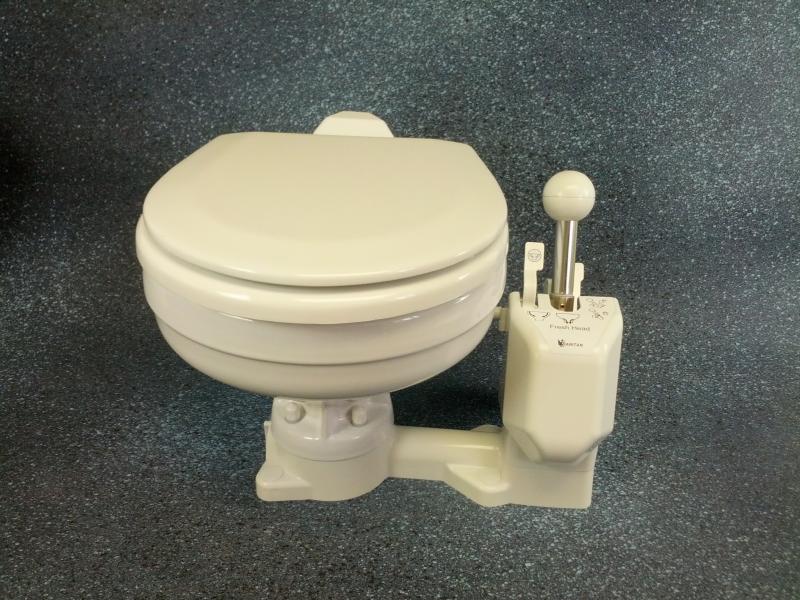

I see the ad for Raritan's new fresh water head (pressurized), but I can't find any info on it. I am wondering if the water supply to the head is isolated from the fresh water supply? Or does this new design "fix" that issue? Nothing o. Their website I can see.

Raritan's new "Fresh Head" is the first ever fully manual toilet designed to use pressured fresh water from the onboard potable water supply...the water supply does NOT have to isolated from the boat's fresh water system. According to the advance word they sent me in May, "There is a vacuum break in the back of the toilet bowl. The user simply pushes the lever on the left to allow whatever water they want in the bowl, the handle then operates a diaphragm pump to discharge the waste. The lever on the left is to lock the diaphragm in place similar to the Jabsco twist n lock."
They also told me that they intend to offer it as a "conversion." The base is the same footprint as the Jabsco manual toilets and there will be just a pump conversion available. They're still working on the price for that. They've promised to send me the owners manual as soon as it's available, but I haven't seen it yet. I do have a photo. I'll post more info as soon as I can get it.
