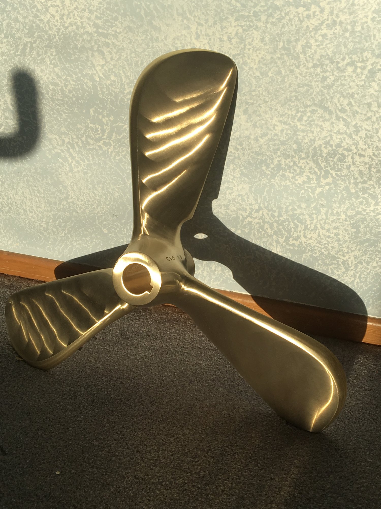

Props and Paint... When this shiny boat bling showed up on my door step, I had a gleam in my eye.
I wanted to do everything I could to protect her/it. I read about special paints and ways that they are applied. I consulted everyone I met and received a series of conflicting comments / ideas.
Over the past 5-6 years I have enjoyed the friendship of a professional diver. He slips beneath the waters beside my boat 3-4 times a year. Yesterday we were chatting about props. He took me over to see the reflection of this beauty in the clear water under the boat.
"Don't ever paint it. It is looking great. Use it. I'll keep it shiny as long as you keep buying zincs to protect it from galvanic corrosion."​
Paint sloughs off as your prop thrashes against the water. It leaves a disrupted surface that marine creatures use to attach themselves.
It is your boat and your prop. My 2cents are the wisdom of a guy that pulls up the skirts of many boats to rub their bottoms.
