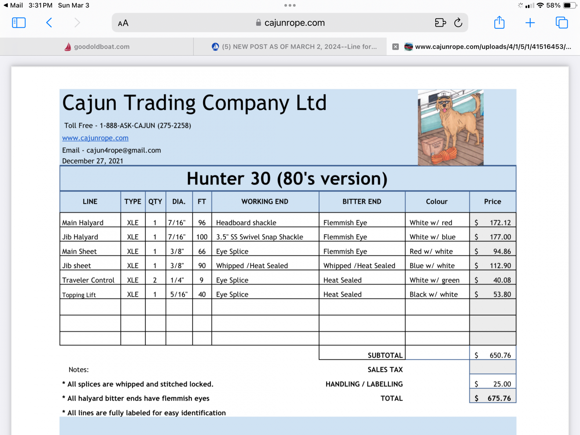

I found this on Cajun Ropes where I have purchased line before…
it shows 40 feet…seems way to short.

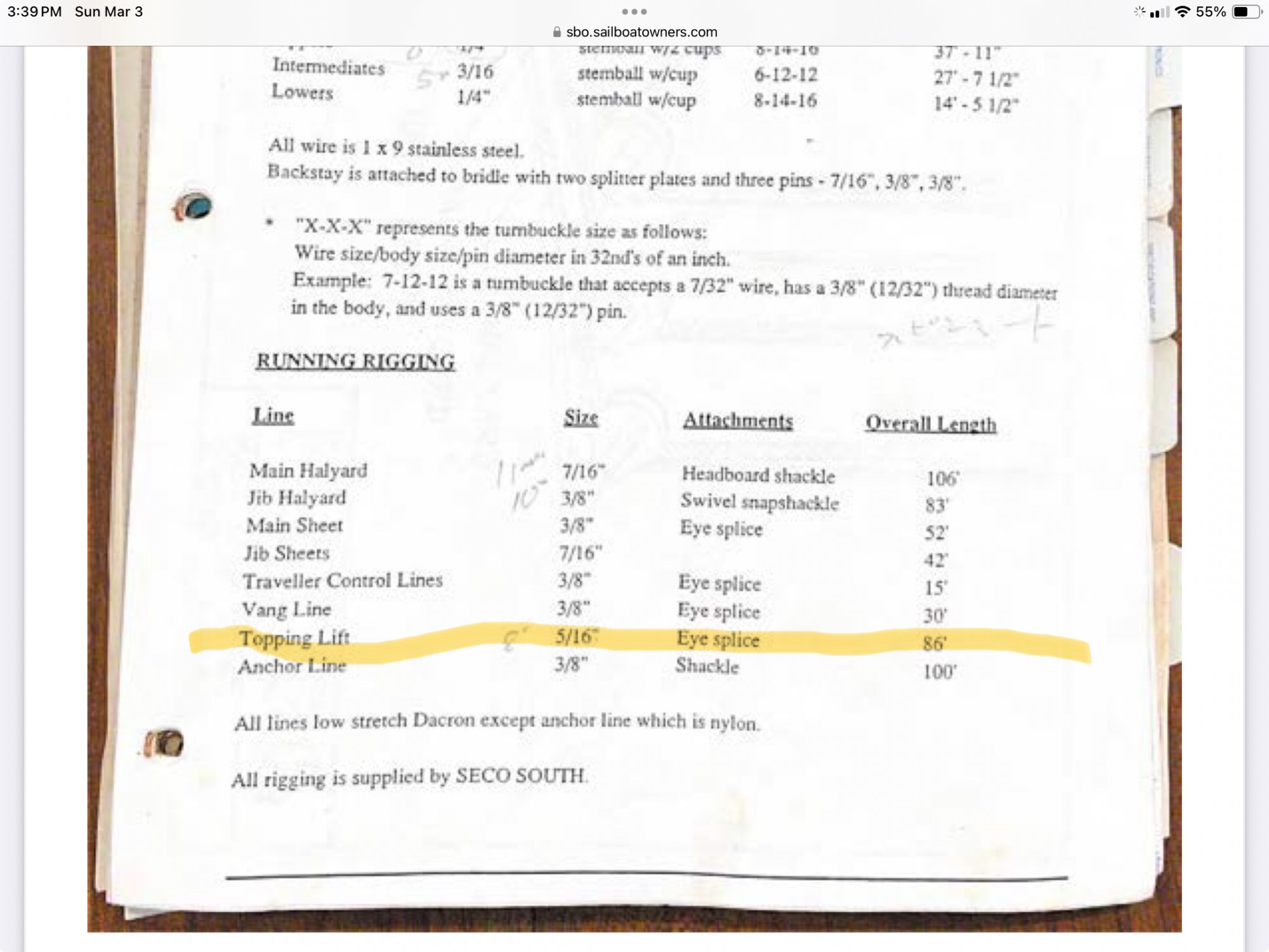

On SBO, I found this manual for a 30T…
It shows 86 feet, which sounds more like it to me…
