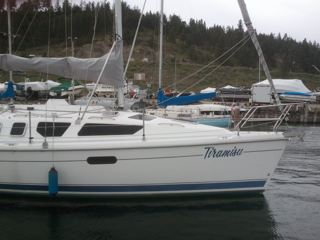

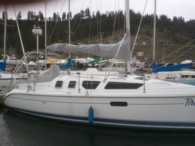

I agree with Robert although I think it was just a typo. That is not a 34.
That being said, I still think a survey is a must. Checking the hull and rigging are the stuff an expert should look at. Also an engine survey unless you know or have some expertise there. Me personally.. I am going to want to see the stuff the PO boasts the boat has. Mine supposedly had a macerator. It in fact did not. I would want to see all the electronics actually work which you can do on a sea trial. Look below for any water damage to the sole around the compression post. That is where they tend to leak. Also make sure the counter weight in the salon table is not frozen. By the look of the weather in the picture, I would make a thorough inspection of the ports and all areas around them. Look for evidence of water leaks. Look under all the cushions in the berths for any signs of mold. Light the stove. Turn on the water pressure and have a sip. How does it taste? Smell? Find and excercise all the through hulls. If this boat has a holding tank make sure lines and head do not smell like HEAD! Those could be permeated lines. Generally look for stuff that you might look for on a used car but understand where your strengths might be in handywork versus walking away. To mention just a few things!
