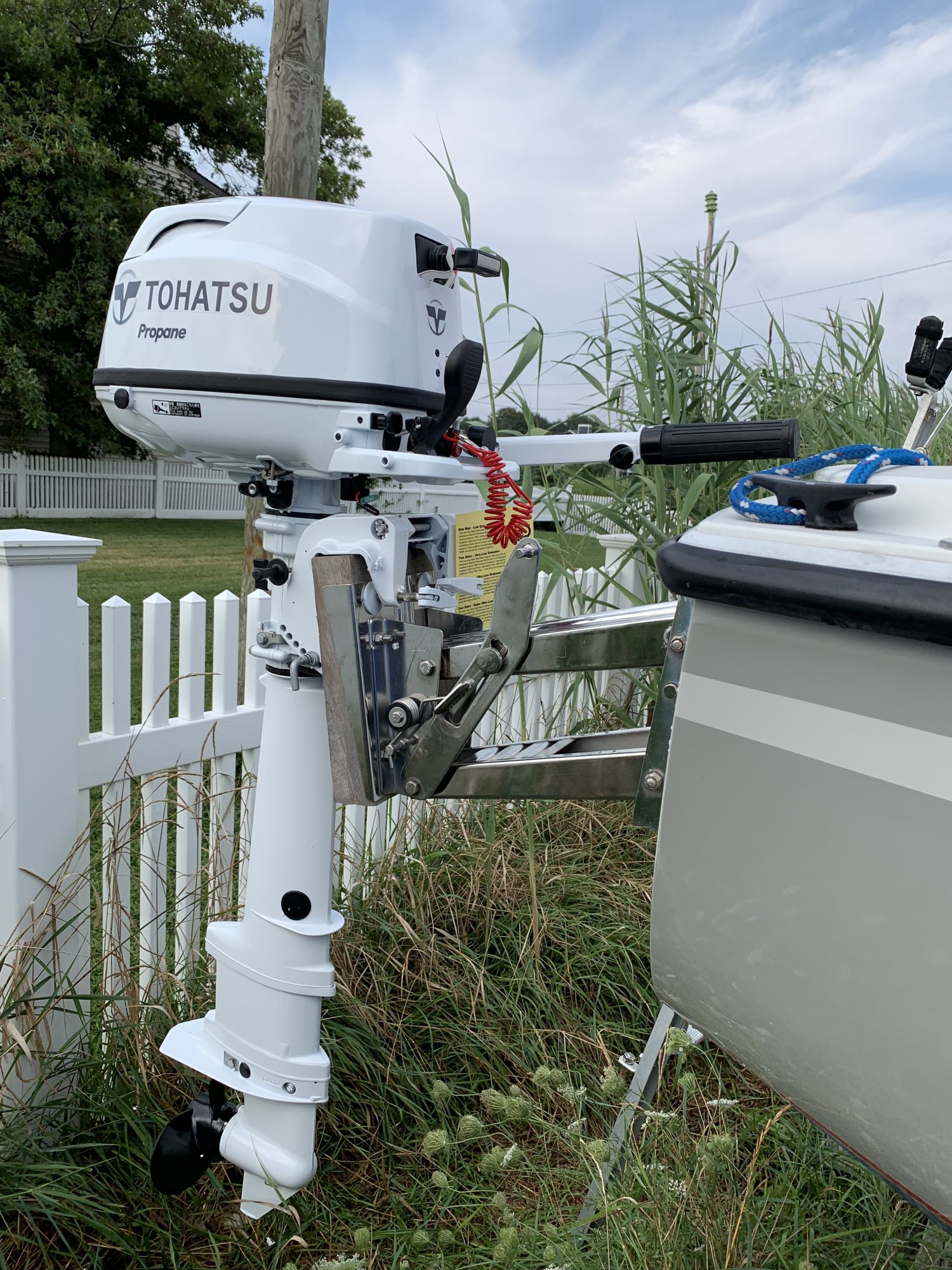

I just got the Tohatsu 5hp SailPro Propane version and it’s been great. Very quiet and super efficient on propane, plus you never have to worry about ethanol or fuel system problems. And since propane never goes bad or has water issues, it’s a reliable fuel source. You just need a safe place to store the tank that’s well vented low and doesn’t come into the cabin (which my O’Day 192 has).

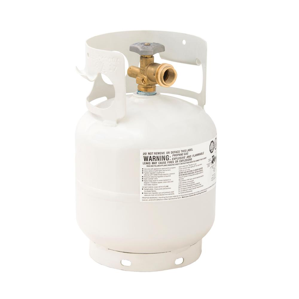

How big of a tank do you have and how long does it last? Thanks!
I have been running a Tohatsu Propane for a year and a half now. I like it, but it has limitations. If you want some detailed information, PM me with your questions and I will get back to you. The very mention of propane and motor seems to start a flaming discussion (no pun intended), so I'd rather message off line.
Mike
Jul 28, 2018
57
Catalina 22 TX
With two 1lb bottles in a dual carrier, my test ran for 28 minutes full throttle, then gradually decreasing RPMs for another 30 minutes.
I also have an 11lb Viking fiberglass tank which I estimate would run 5+ hours.
Oct 21, 2015
73
Catalina 22 Lafayette, IN
I see similar results. I run down a 1lb bottle in about :45 minutes to an hour.....but I'm almost never running more than 1/2 throttle. I have a 5 lb. bottle as well. I have run it 2-3 hours at 1/2 power, and it's about half empty (I weighed it).

My Tohatsu Propane is very quiet, but I’m also comparing it to the old motor: a 5hp air cooled 4 stroke (basically a lawn mower with a prop). That air cooled could wake the dead at idle.

At idle its much quieter than my 2004 Tohatsu 4 stroke it replaced. Almost no need to stop it, just leave it purring. At speed, it's like any outboard, though probably still quieter if one were to measure it.
