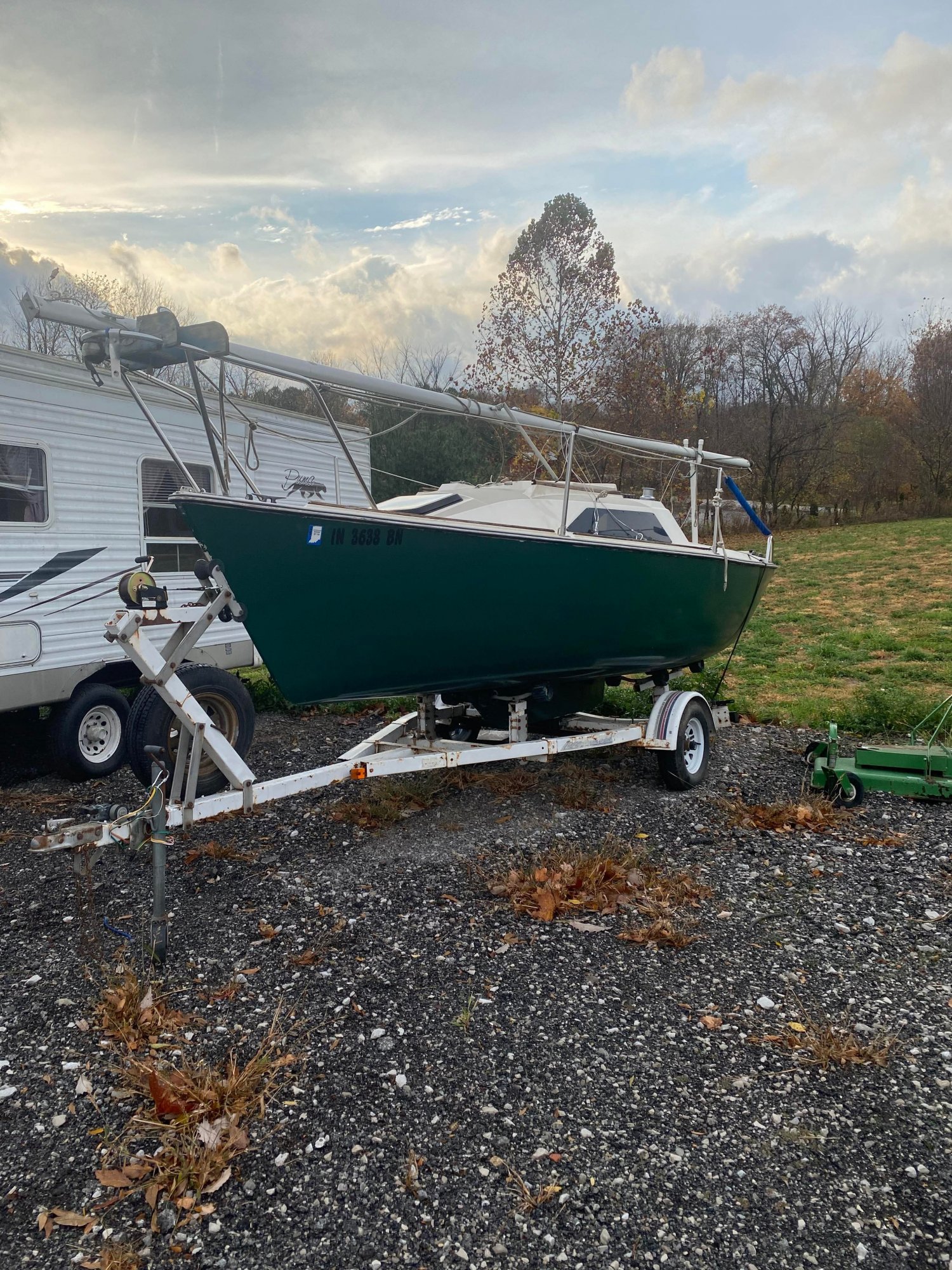

Hey all! I bought the O'day 192 I was looking at and I'm real excited to get working on it! A couple starting points:
1. Can anyone who has this boat please send photos of their rigging. I have the general idea, but any photos are helpful!
2. One of the first things I noticed is the mast seems to be back leaning. Is this normal or do I need to adjust the turnbuckles to straighten her out? The backstay seems loose, while the forestay was having a hard time reaching the forward pin. The inner shrouds felt real tight while the outer shrouds seemed either about right or maybe even slightly loose. Not an expert here so please feel free to talk to me as if I know absolutely nothing!
Lot's more questions to come I'm sure, but this seemed like the best place to start! I'll be posting lots of photos as I work on this baby so stay tuned!!!
