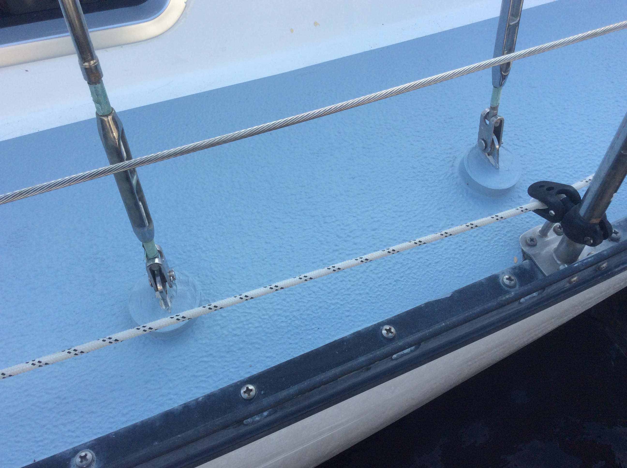

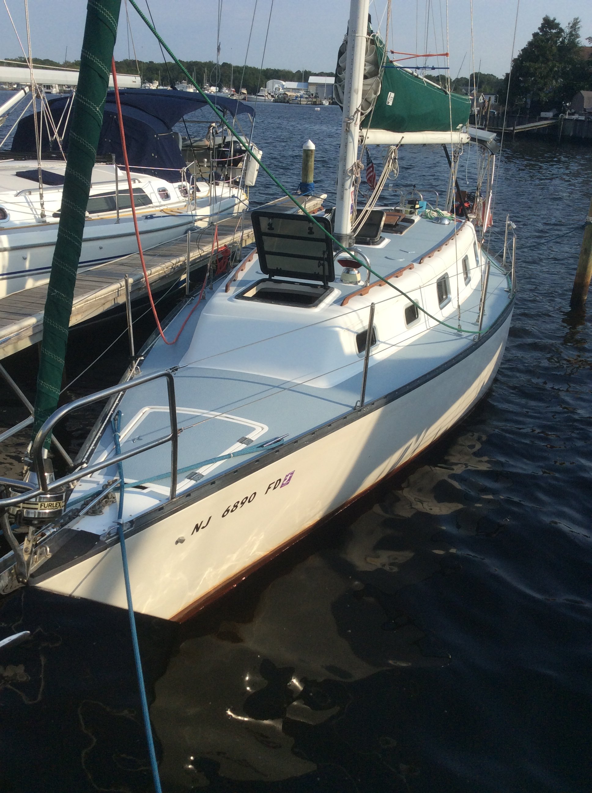

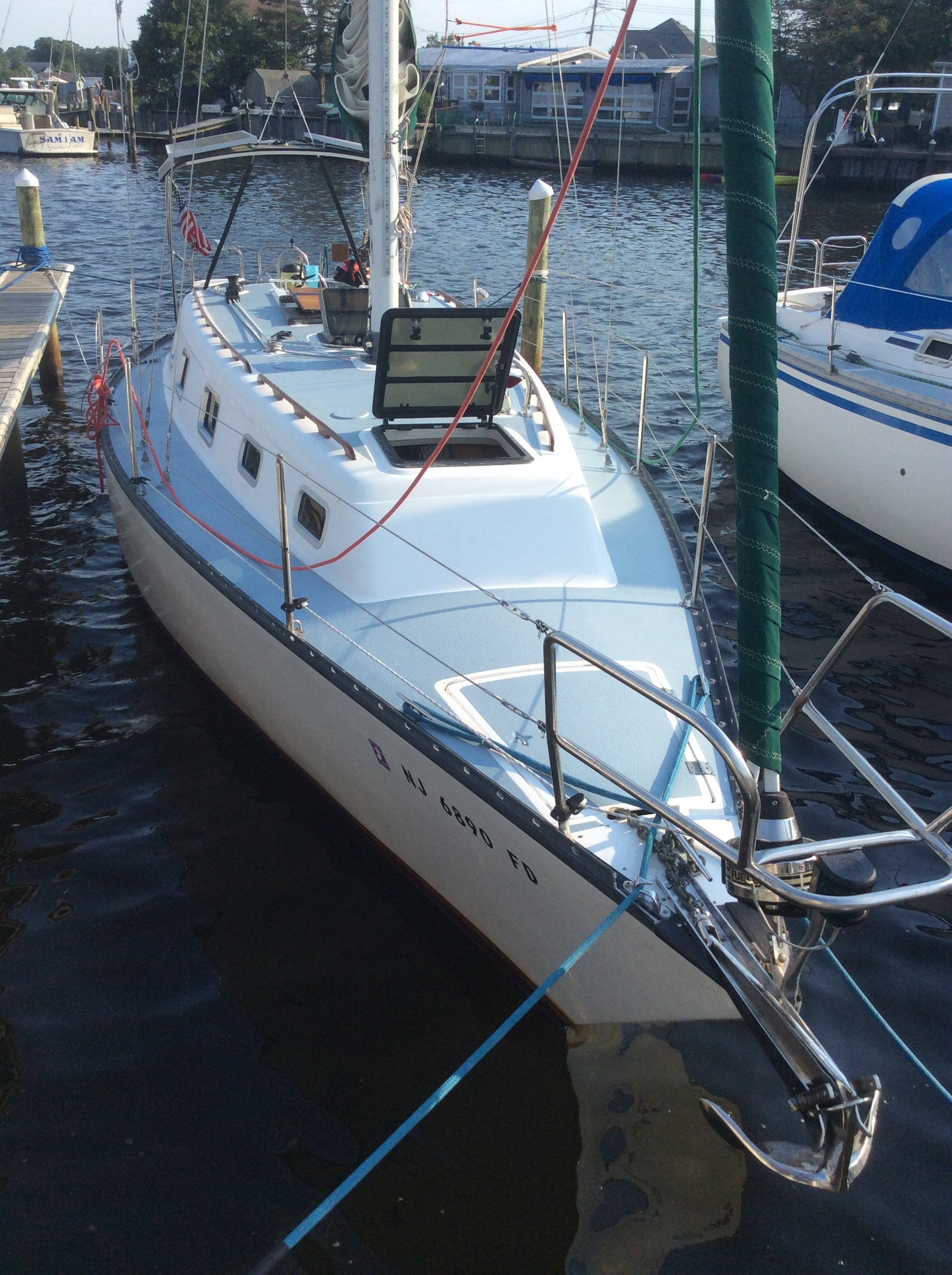

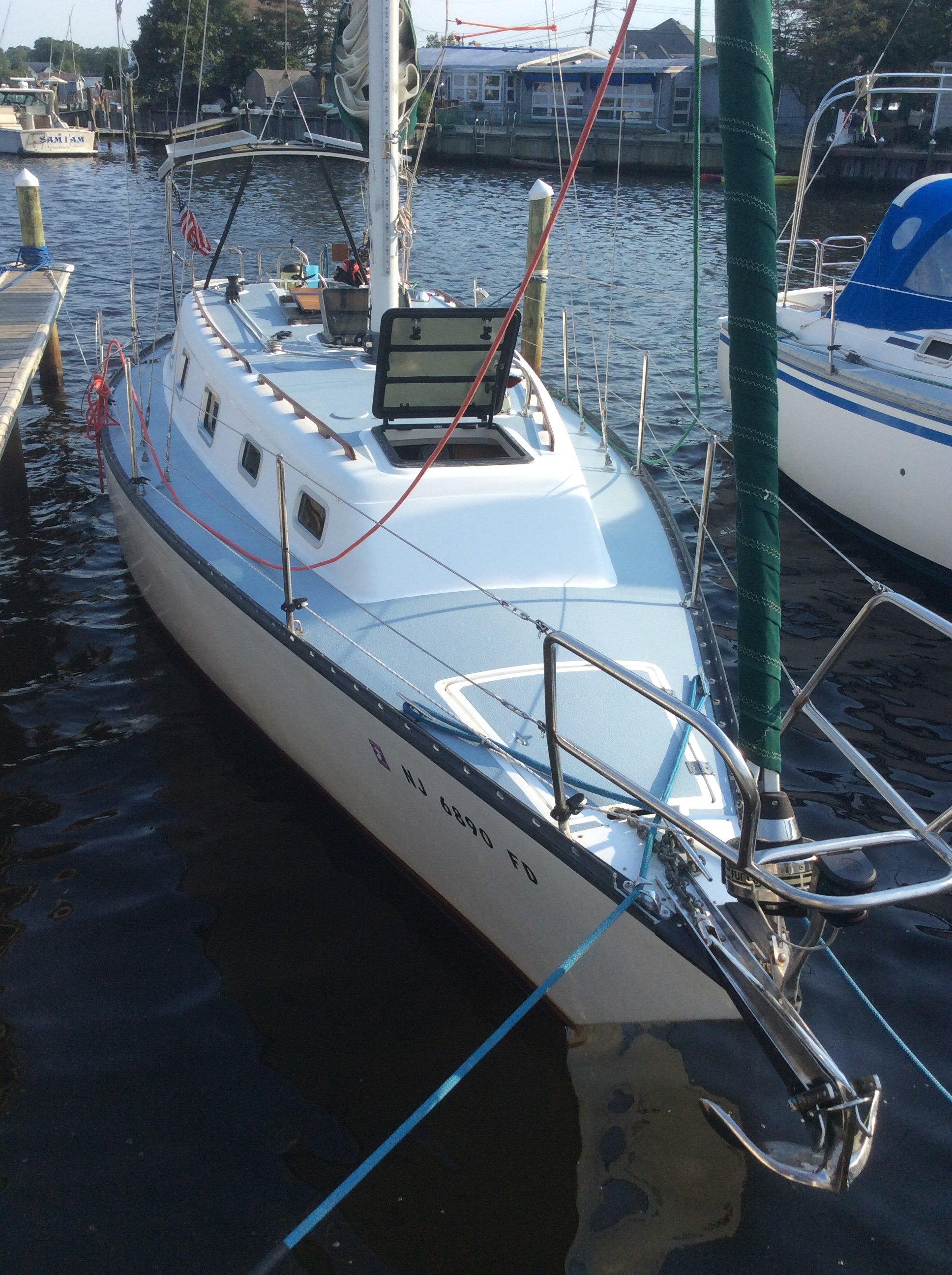

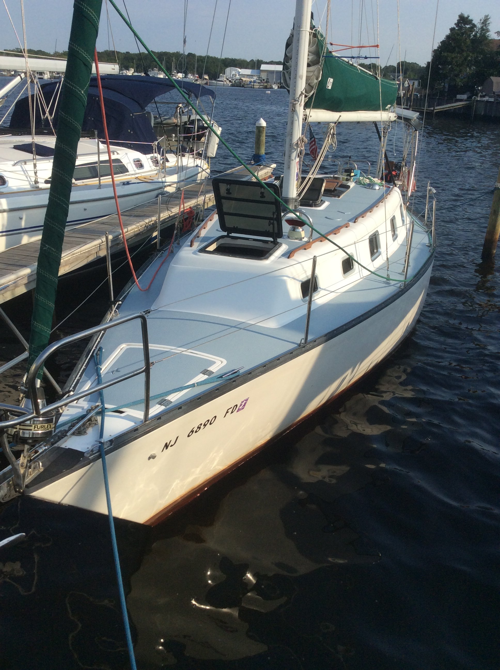

Completed the nonskid refurbishment and grab rail refinishing. I used Total Deck gray from Jamestown distributors. It appears has a slight blue tint that seems to be turning more gray over time. Total Deck is a polyurethane with the nonskid grit mixed in. I tried to keep the color and surfaces painted close to original.

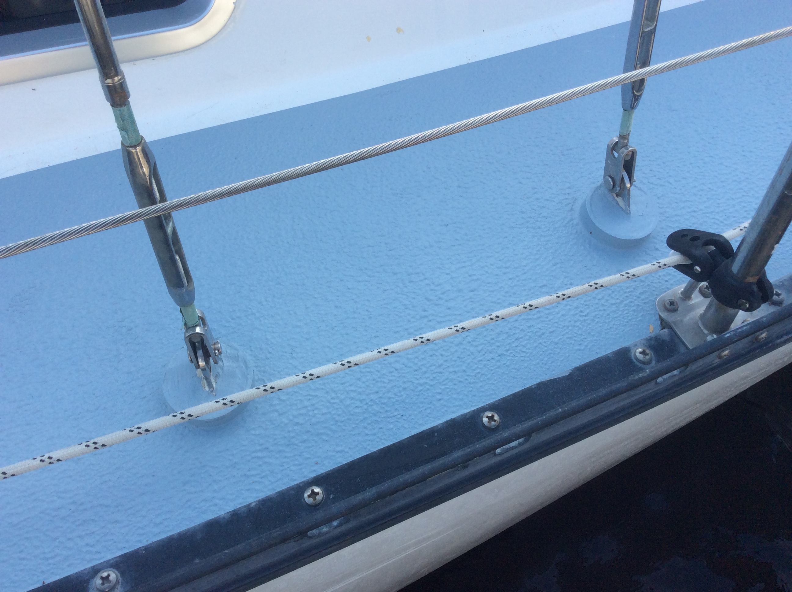

Last fall I installed coffer damns to the chain plates as described in a Good Old Boat article. They work well. No leaks.
1,065
Haven't seen that article. I am curious: what are the "coffer dams" made of?
Sep 26, 2011
228
Hunter 33_77-83 Cedar Creek Sailing Center, NJ
Hi Jim,
The outer casing is a 2" pvc union that is cut in half and epoxied to the deck. The chain plate has adhesive lined heat shrink tubing slid over it and heated to activate the adhesive and shrink the tubing. Then the void between pvc and tubing is filled with Bond and Fill caulking. The caulk bonds to the pvc and shrink tubing.
Nice work. No leaks is the goal. I also have chainplates in my decks that I refinished during a mast restoration project this winter. Reinstalled using buytl to seal the deck hole. Beveled the deck hole with a dremel bit to hold the buytl. Slipped a metal cap on the plate and screwed it down compressing the buytl around the chainplates. Concern was stainless can develop pitting rust when exposed to water trapped in an airless environ. The heat shrink on the plates should be watched. Water can come down the wires and needs to be shedded at the deck.
Alctel
Dec 13, 2013
264
Hunter 36 Victoria
How do you mean metal cap? Do you have a pic you could share?
Jun 21, 2007
2,117

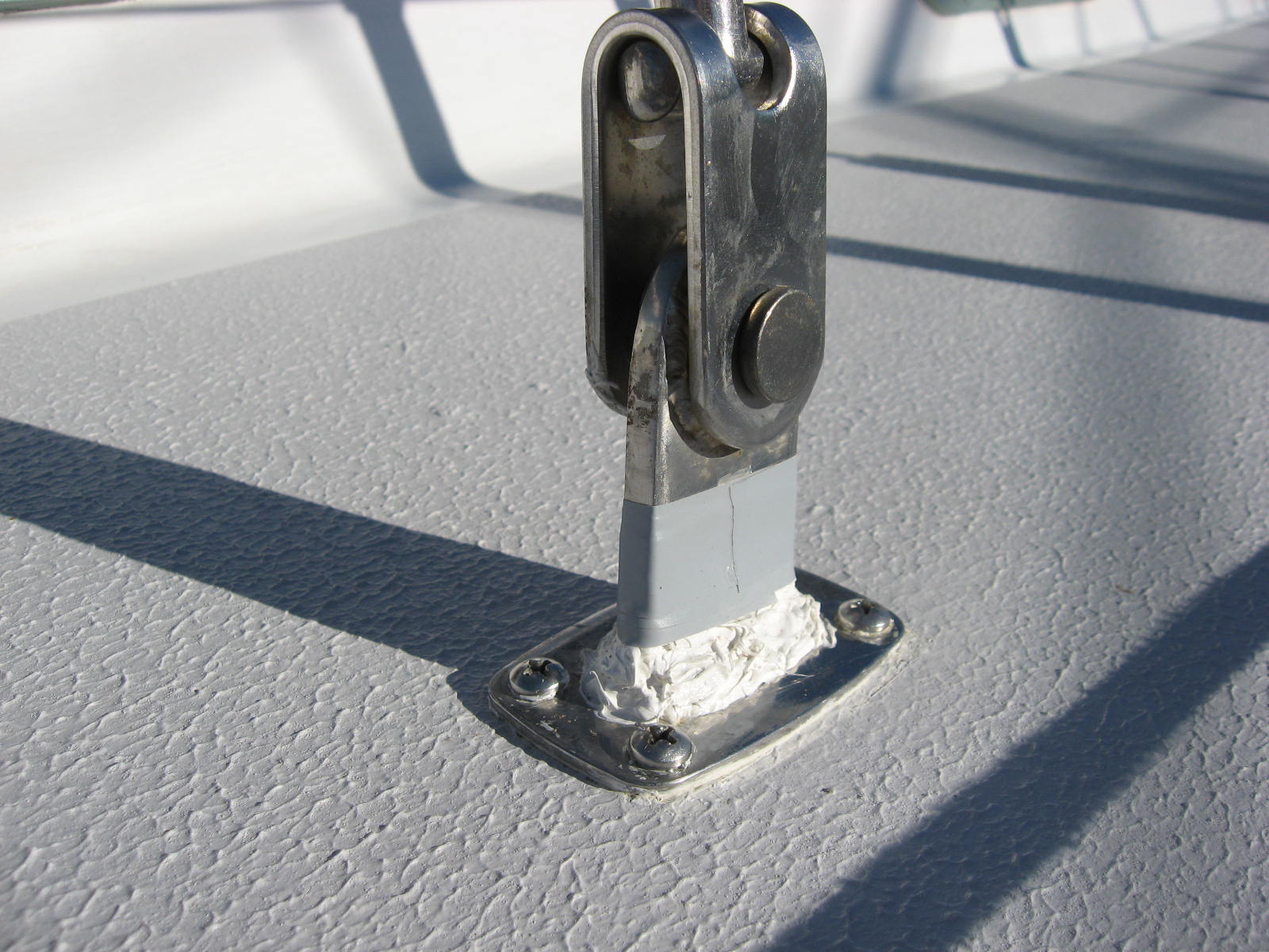

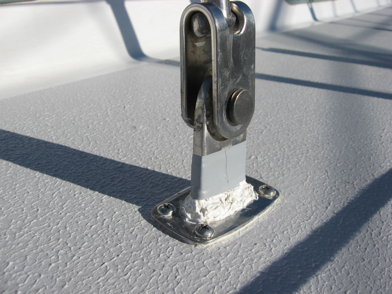

Alctel: Here is a picture of a chain plate/deck interface on my 1980 built Cherubini Hunter 36. Believe it is the original design. For the first several years I owned my boat, I did have leakage issues. Despite raising up the deck plate, digging out the caulk and then repacking. Still leaked. I saw that the main reason was that with constant movement of the shrouds, the seal between the caulk and the vertical chain plate would begin to separate. On the third attempt, I decided to do it a bit differently as in the picture. First I sanded (with 600 grit wet/dry) the area of chain plates to which the caulking would be applied. Then I wiped with acetone to remove all traces oil/salt/dirt. Then over several applications of caulk, I built up the sloping mound. After it set firm over the next couple of days, but before I took the boat out sailing, I tightly wrapped UV resistant electrical tape around the upper caulk/chain plate joint. My thought was the added pressure of the wrap would assist keeping the caulk bond intact against the chain plate. And even if the bond did separate, water running down the standing rigging would be diverted by the tape. Seems to have worked. Five years now with no leaking into the cabin. Even during last winter's El Nino rains.
I did not use marine caulk for this. Instead roofing metal gutter sealing caulk. I had observed at home that the caulking the roofers used 10 years ago at my house was still firmly bonded to the joints of metal gutters they installed. And it was extremely pliable as well. So seemed like a reasonable product to also use for chain plate sealing duty.

Rich, looks great.
I recently redid my cockpit floor with acrylic primer and acrylic flat house paint with non skid grit sprinkled on. Perfect color match and looks great from the distance but I didn't get the grit evenly distributed so not so happy with it close up, also gets dirty looking too quickly. I think that I might like more of a popcorn texture versus a sharp raised mountain look of kiwi grip.
It is hard to tell on my screen but how would you discribe the texture? Any primer needed? Must have been a lot of work but for you. Fortunately I only have to do a small area.
Sep 26, 2011
228
The texture is the stock Hunter splatter nonskid with satin gritted polyurethane over it. Kind to the feet unlike Kiwigrip. I did use primer from total boat. That primer dries almost too fast but worked great. Taping/masking was the only pain point. I made my own dewaxer solution; ammonia and dawn dish soap.
I used two colors. White on the shoulders and gray for the rest. It is not a true gray yet but may over time. Slight bluish tint. The stock nonskid was gray which is why I went that way.
