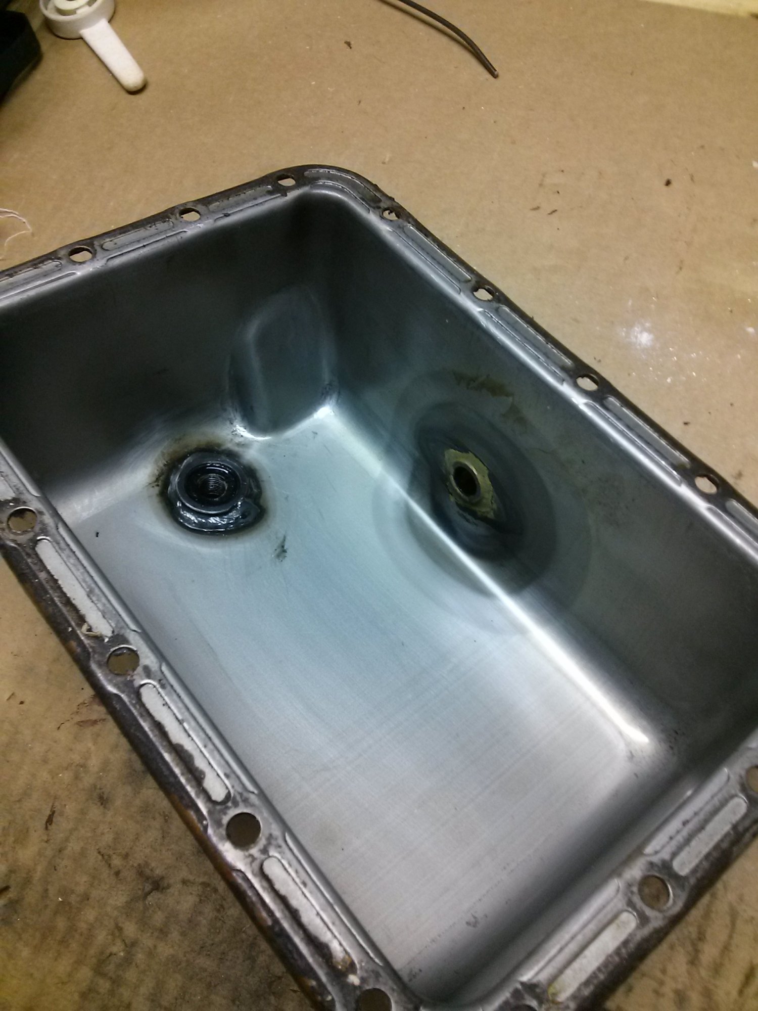

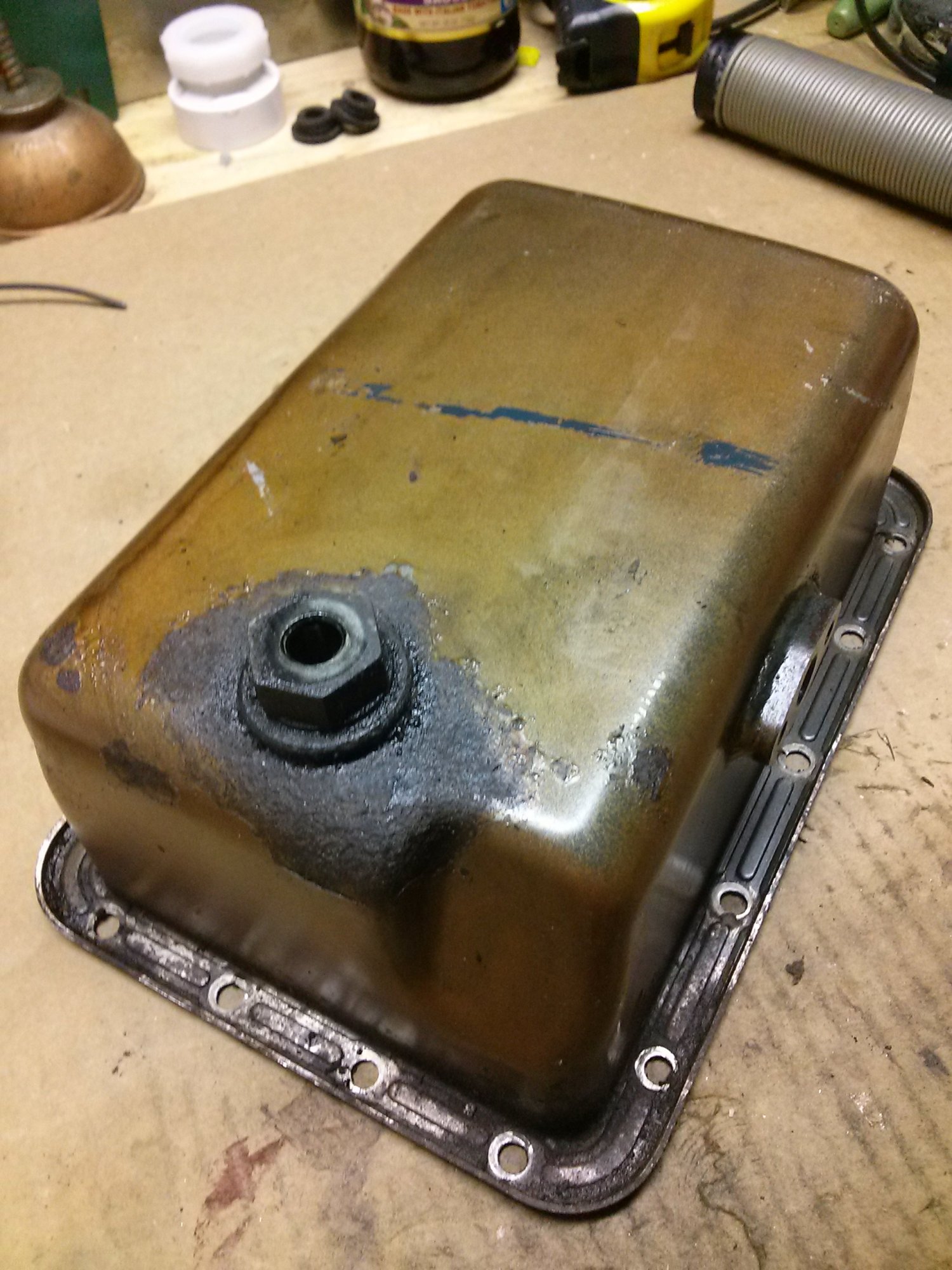

I did this job several years ago on my O'day 35 with the M25. It was a PITA, but I got it done.
Here are two "before" pictures of my oil pan. I wire brushed the rust off, coated it with rust neutralizer, and then faired it with JB Weld. Then I sanded and painted it.

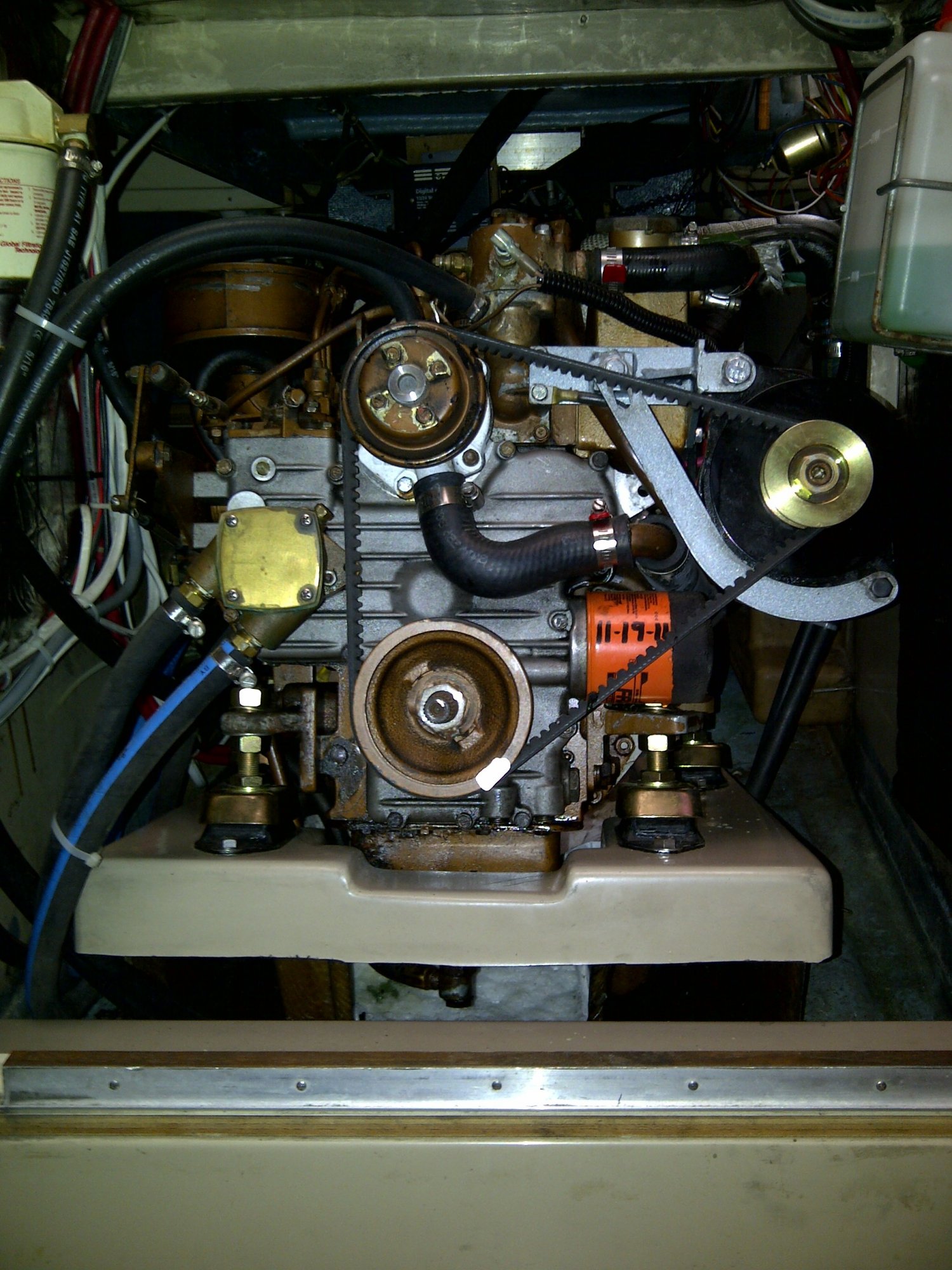

Pic with the new mounts installed, but before I fixed the oil pan;

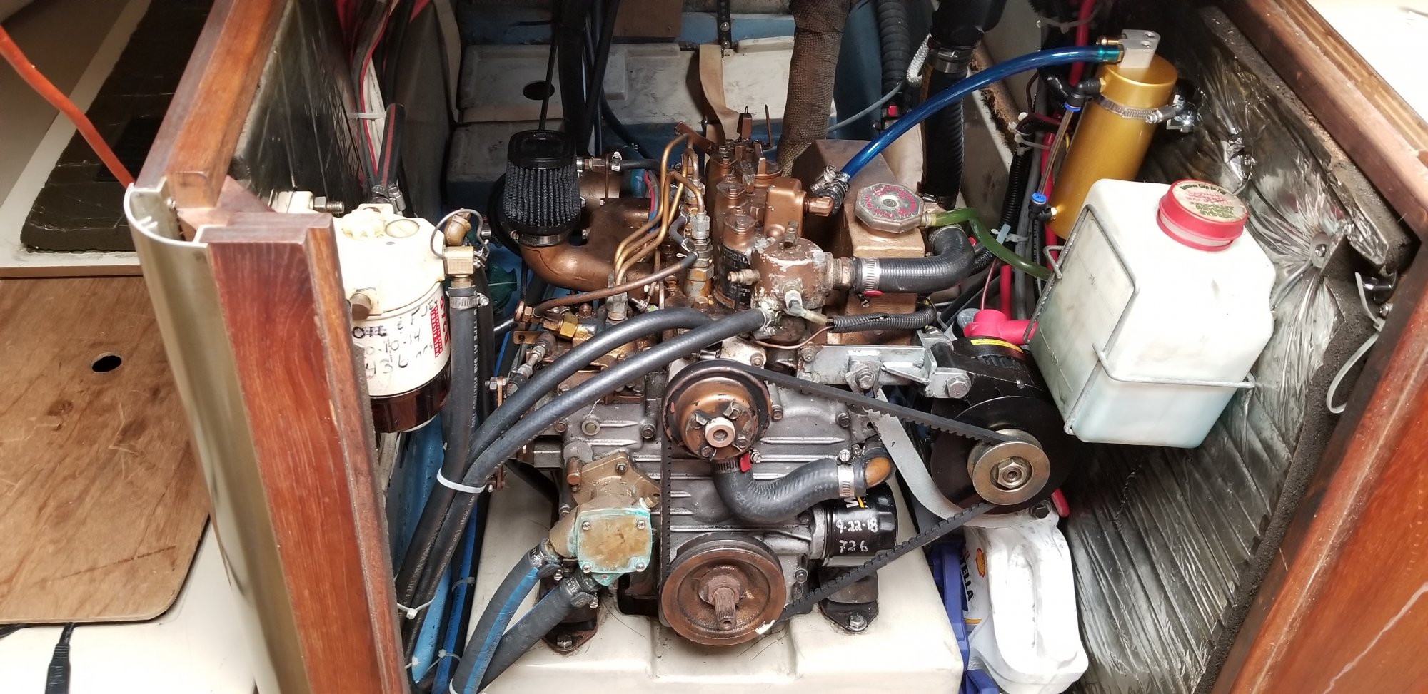

and a more recent pic (2019) that shows the motor mounts, but does not show the oil pan at all;
