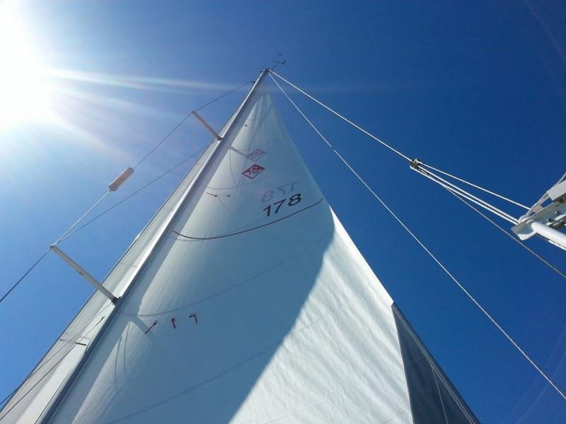

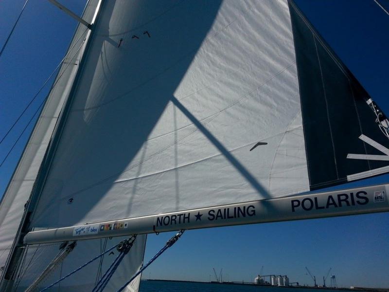

Ok. Happy yesterday has turned into frustrated today.
Sail kept jamming up in the furling system. The very first wrap of the sail on the furler was not going on smoothly. We kept getting a jam when the sail was about 98% out (1 wrap left on the furler). We ended up taking the sail down and re-hoisting it up the second groove in the furler. Minor improvement.
Then on the sail this evening it jammed about half-way out. Was able to re-furl and then try again. Not smooth but it came out. And then not smooth at the end of the day. Frustrated.
The previous main has worked flawlessly and very smooth for the 18 months I have owned the boat. Hopefully once this new sail has been furled and unfurled a few more times it will devlop some curl and become smoother to operate.
