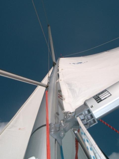

BrianW's point deserves its complement-- the price of raising the boom and recutting sails for it on a small boat is reduced stability, added heel, less sail area, less pointing ability, and with mid-boom sheeting higher load on mainsheet tackle and less leverage.
That said, I would go with a new main. Ask the friendly neighborhood sailmaker his advice while you're there. These guys are usually very sensible, experienced, and frugal.
Roger is right about the vang; but remember that with mid-boom sheeting (so common on small boats with Bimini tops), the vang and sheet bails are so close together that the vang does very little of what it's supposed to do. The farther aft the mainsheet is, the more the boom does its proper job and the same for the vang.
I have a sliding gooseneck on my boat that lets me have the best of boat worlds. When reefing I lower it at the downhaul than raise it the halyard. This helps, more than most people realize, in heavy weather.

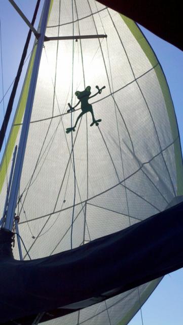

I'd definitely agree with Brian and Dave. I consider the main on a 26/260 as a light wind sail due to it's size and large roach. I reef it at 12kts(10kts if I'm pinching upwind short handed) and the boat maintains and might even gain some speed as the rig becomes better balanced.
If you want more light wind horsepower especially for off wind sailing, last season I added a 4' carbon mast sprit and a 300sq' kevlar gennaker on a continuous furler(boat jewelry). It's a charge to simply roll it out from the cockpit and run 3hrs up the coast like we did last weekend with the wind blowing a steady 12-15 on the rear quarter, the CB up, gennaker out and the main reefed. My gennaker will actually point pretty well too, but not quite as tight as the stock jib. This again speaks about how well the stock sails will work when they're in good shape.
Go with a fresh set of sails cut to the same basic guidelines by a good loft or straight from Doyle and you can't go wrong. If your lucky like I was maybe they'll have enough scrap hi-tech material from a bigger job to sew up an A-sail or a gennaker for you.
Good luck. Mike
