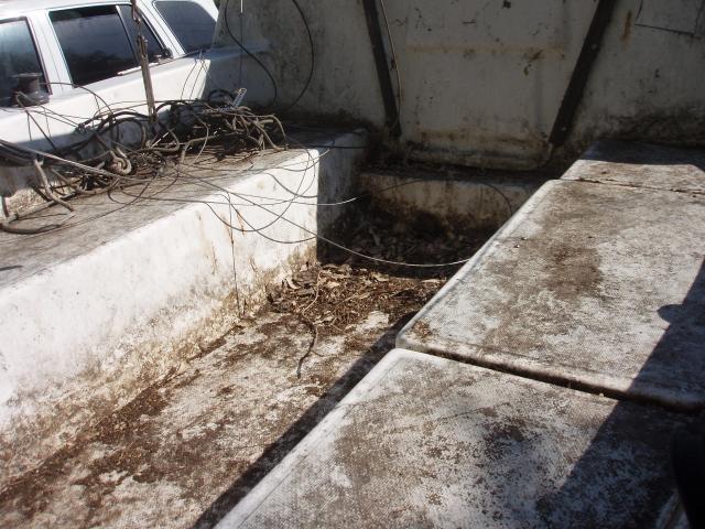

I acquired a Mac 22 that was on a trailer for almost ten years. It was full of leaves and debris, and had all kinds of tree sap and other "debris".

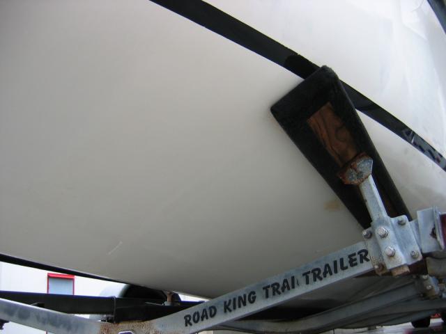

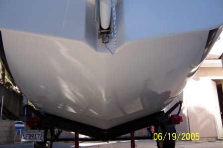

Here's a pic of my boat bottom after I cleaned and waxed it.

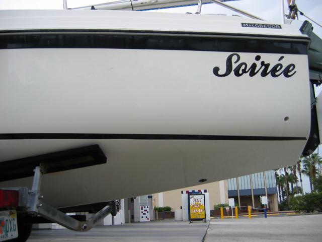

I'm not sure if you have tannin stains too, but if you do, Captain John's Algae and Stain Remover (available at West Marine or direct from www.captainjohnsboatbrite.com) is a great way to remove them. The ramp we use to access the Gulf is on the Pithlachasotee River, which has a lot of stain in it. We sprayed on the stuff with a pump-up sprayer at the car wash, waited two minutes, and rinsed it off with clear water. Couldn't have been easier.

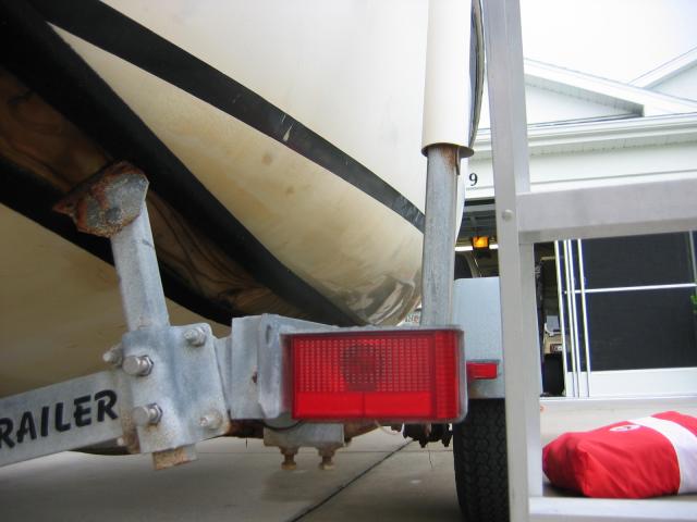

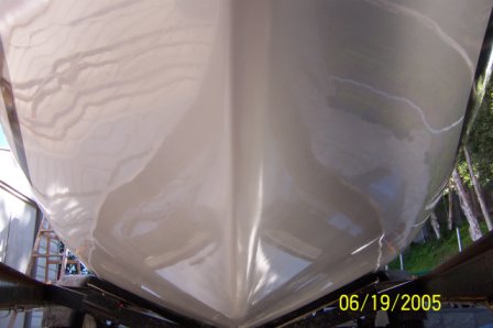

The pics speak for themselves.

I had to get it clean first, though, just to be able to see what I had to work with. The dirt and debris hid cracks around the stern rail and such, and there was so much debris in and around the keel that I could not get it to budge at first. Unfortunately, the last person who used it raised the keel entirely, so the boat sat with its entire weight on winch cable and support structure for about 10 years, which I'm sure didn't help things much.
The cockpit was full of leaves, so much so that it clogged the drain, so 10 years of rainwater caused some to seep into the cabin. I noticed watermark on the floor to a height of about 5 inches - and I believe the extra weight helped conribute to the hull buckling on one side where the trailer bunk ended.

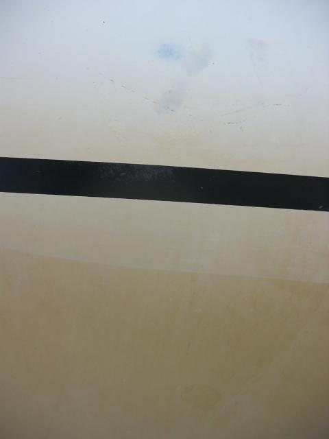

I'm in the process of restoring a 25 MacGregor that belonged to my Father. It has been sitting at my brothers house for the last 7 years. I have really enjoyed all of the above comments and appreciate the information on this thread. Any suggestions on how to make the paint stripe under the rubber bumper guard shine again?

Brent, you might want to try any of the suggestions mentioned here. Most likely, like the rest of the boat, the paint stripe is oxidized, and just needs to be buffed out and rewaxed. So long as the paint isn't too far gone, you should be able to bring a shine back to it.

The blue stripe is not paint, it's gel coat too. I just use some wax that has the ability to remove oxidation, do that once or twice per year. It's very easy to go around the boat while on the trailer.
The boot stripe is supposed to be gel coat too. If you've ever seen the factory 26s video, the process is explained. But for some reason on my boat the boot stripe is just striping tape, I wish it was gel coat.
