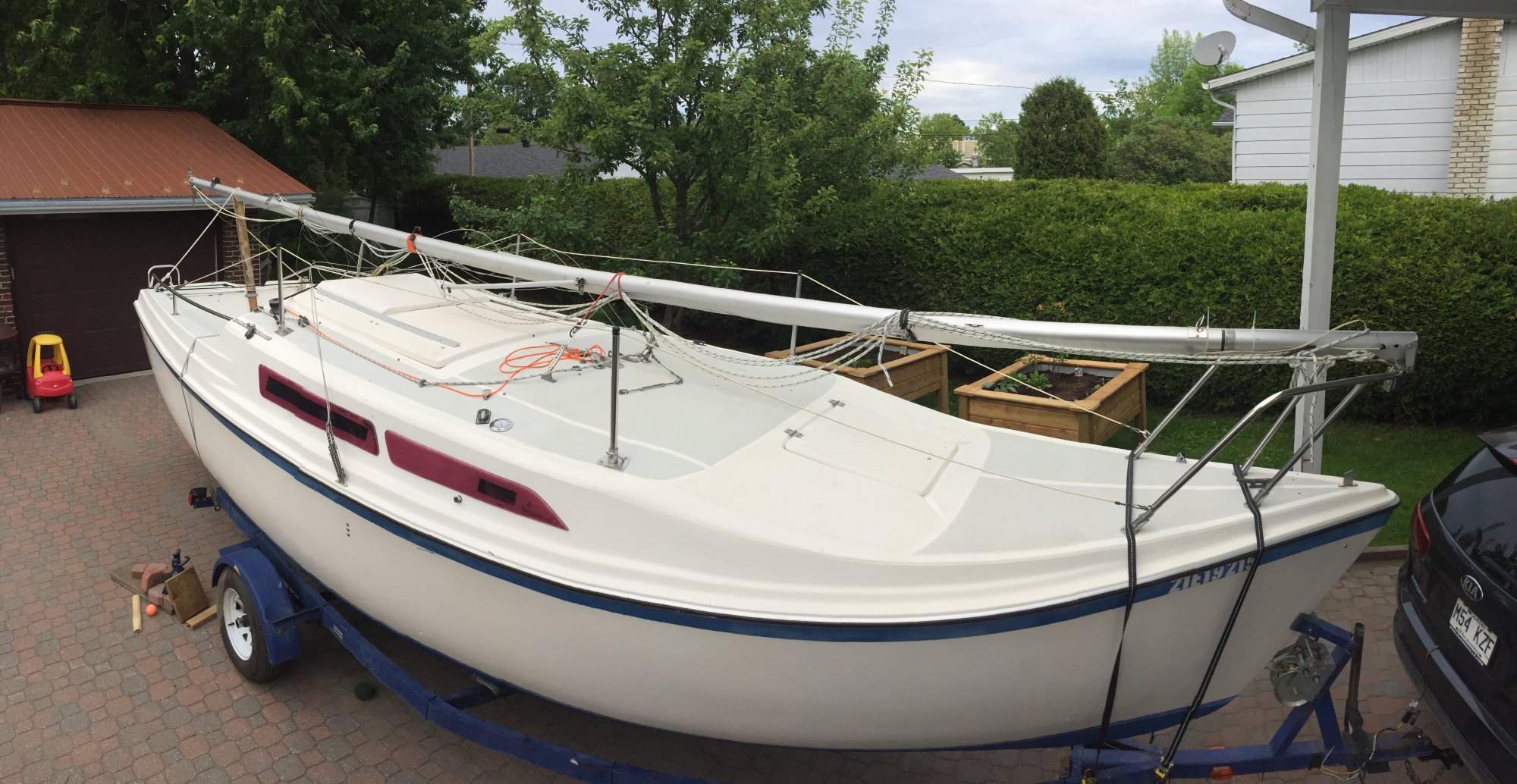

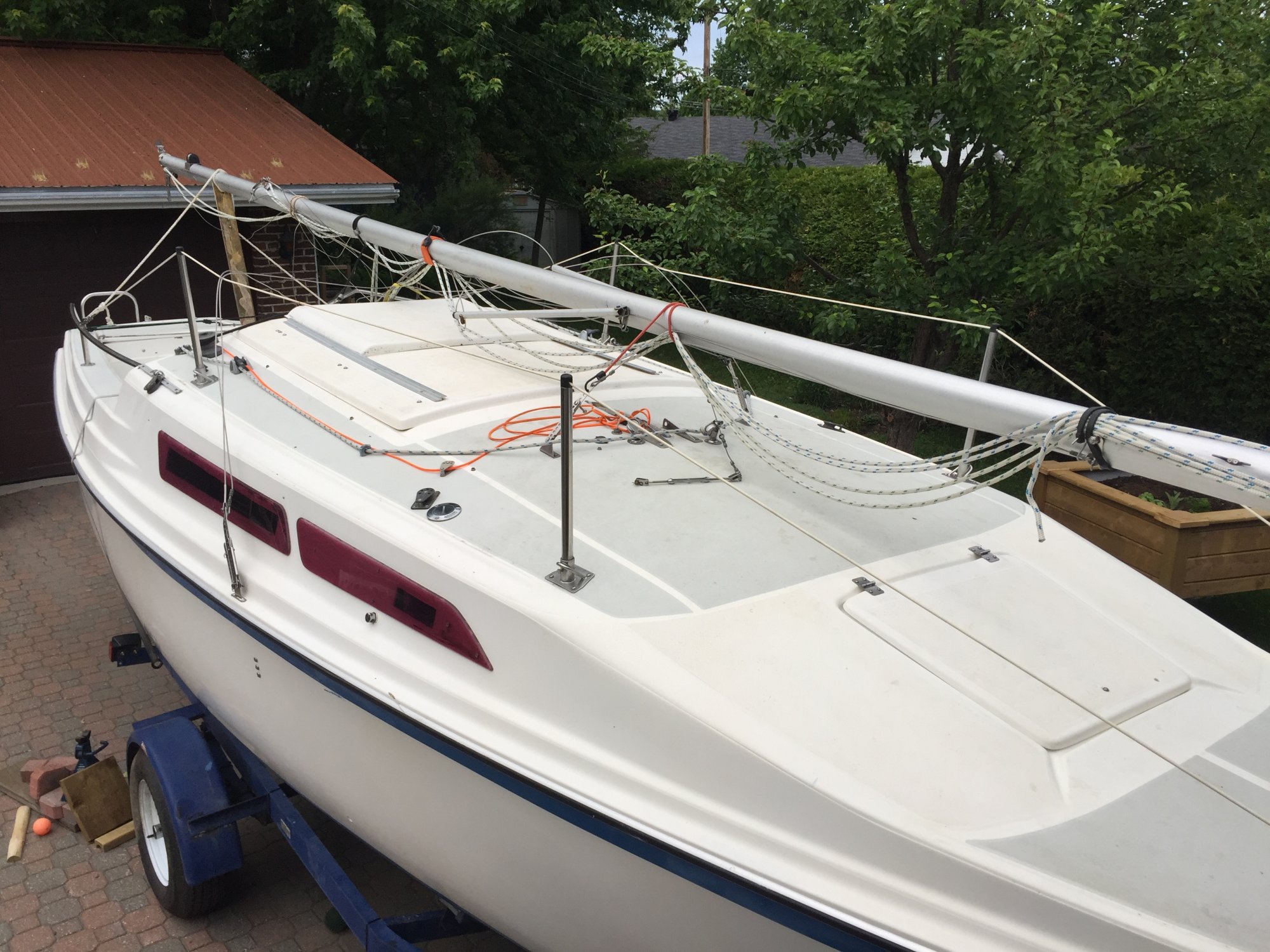

Hi Guys, See the pictures attached. There a too many pulley and "rings" that I cannot figure out where should the jib ropes should go.
As well, just where the mast is attached, there are 2 pulleys that I do not know what to use them for.
I have tried to look on Macgregor owner manual but I cannot find any rop diagram.
Many thanks again for your help!

Mac 26S owner here. I think the rigging is essentially identical on the D and S, so I should be able to help you out.
The reason you can't find some of those items in the manual is that they're not stock. Your boat has blocks and clutches added so the halyards can be run aft to the cockpit--a nice feature that I plan to add to my boat! I can't quite see in the photos but there should be two blocks attached right to the mast foot bracket, or immediately adjacent, one to port and one to starboard. The main halyard runs down through the starboard block, then laterally over to the deck block mounted at 45 degrees, on the starboard side, and then back through the clutch near the winch. The orange line in your photos follows the routing that the main halyard should follow. The foresail halyard is mirror image to that on the port side.
For what it's worth, my boat doesn't have those deck fittings so I just cleat off the halyards to the cleats on either side of the mast, near the goose neck where the boom attaches.
I'm not sure I answered your question but I'm happy to provide any more detail I can, if you need it.

Harder to see with the mast down, but you won't use everything all the time. The eyes where you have the white sheets through are for the jib, which should go to the cam cleats and not through the rope clutch. If you use a genoa you'll use the outside blocks on the aluminum track.

post a pic looking down when standing over the dagger board.
I think that cheek block on the foreground is to raise and lower the dagger board.
how many sails do you have?
and how is the rudder rigged? adding 1" to the leading edge will do wonders to handling.
