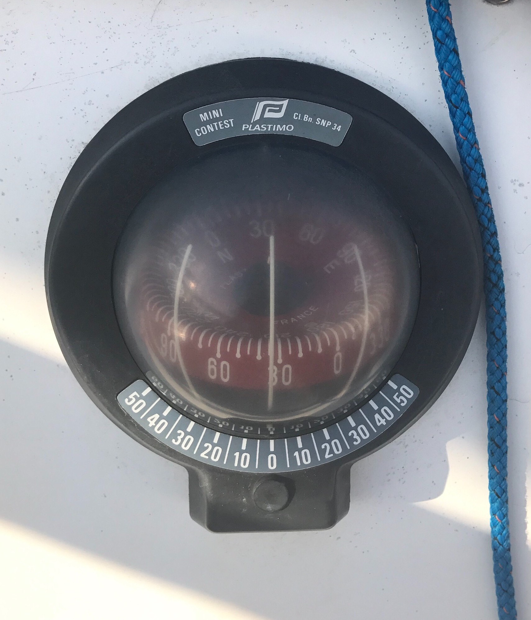

Very nice! Do you have a "before" photo?
My neighbors. Mine looked like this just more yellow.

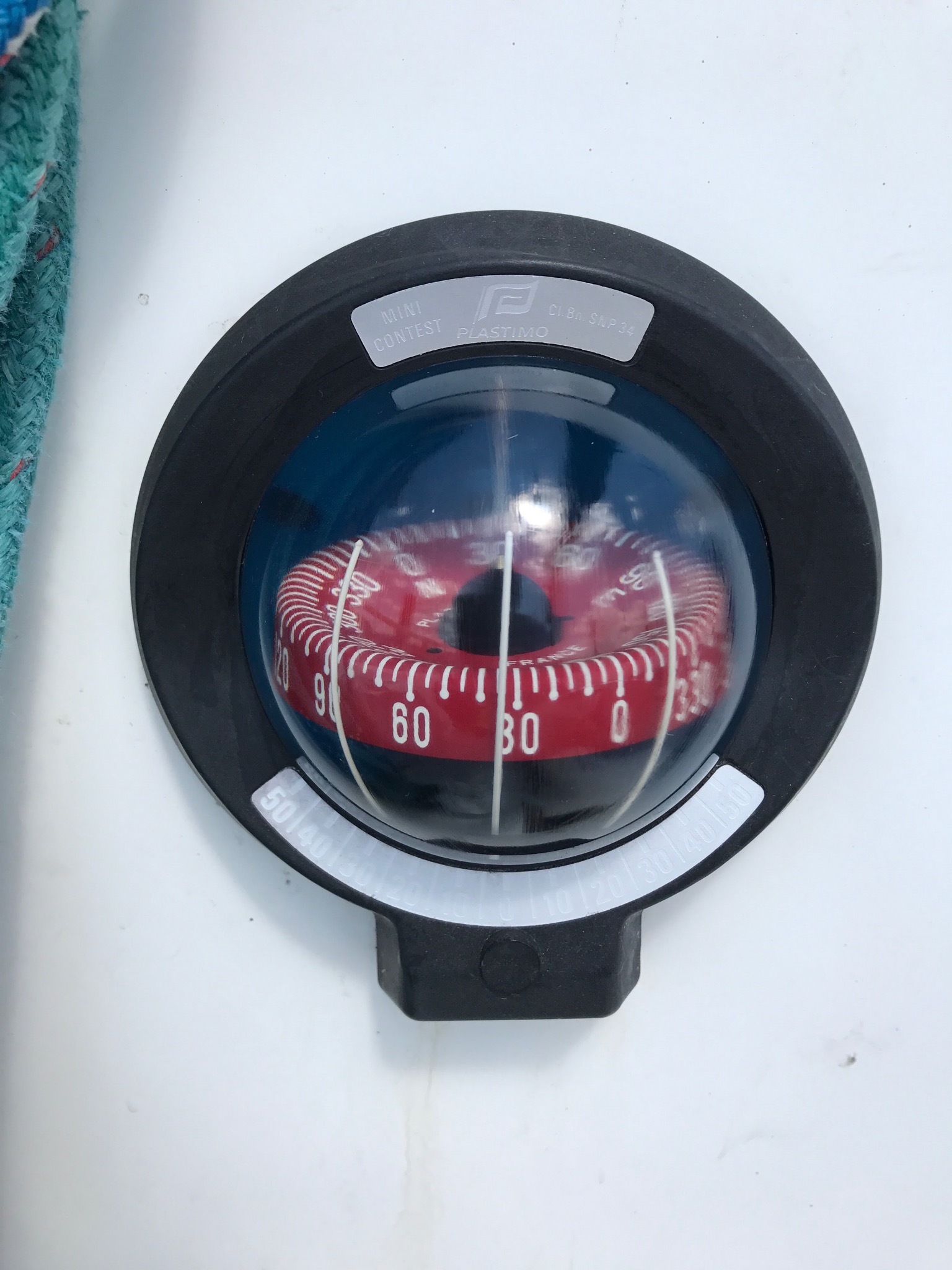

Now. Better pix than yesterday. Note how much more my clinometer lable has UV faded.

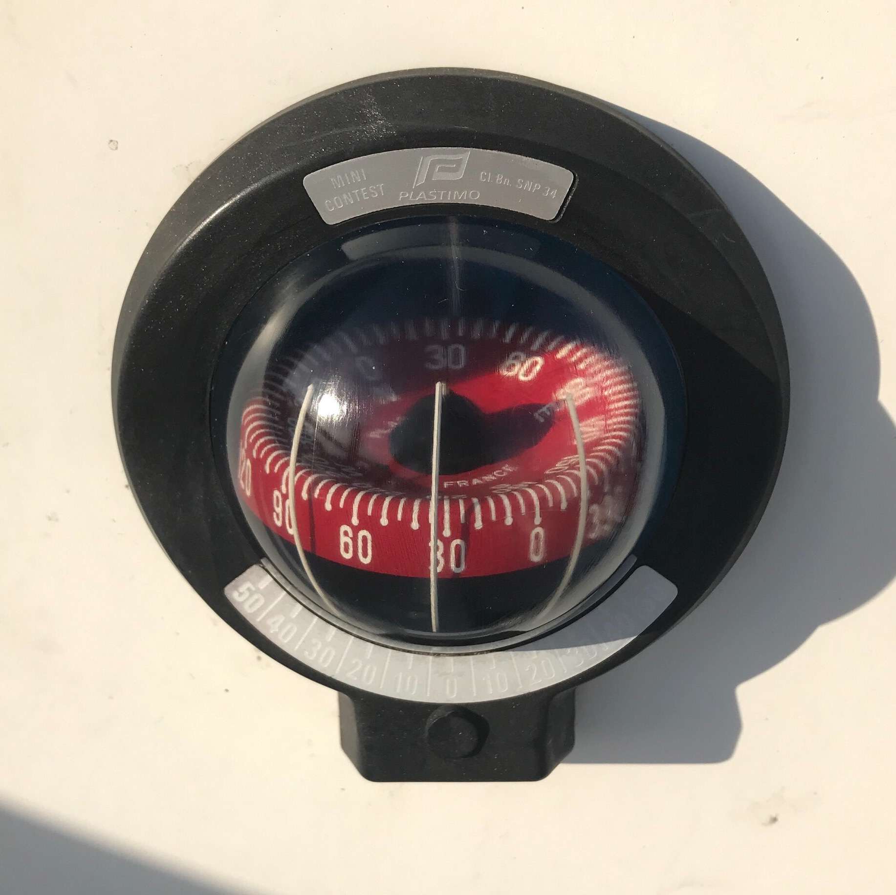

Side by side in our slips... notice now they both read the exact same heading? ;-)

It would seem you guys have no deviation at all on either vessel?
At least not at that heading! ;-)
Mines been swung and has compensators. The one on the Capri I'm sure has not but has no steel to speak of nearby.
Mar 15, 2013
197
Islander 32 mkll Comox Hrb.
Well then, you know whoever adjusted your compass did a good job!:)
