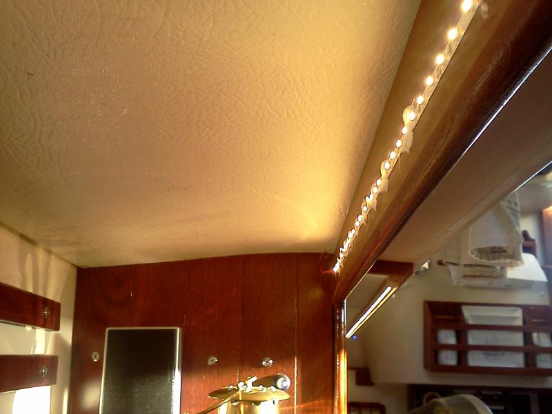

However, I was very pleased with LED tape. I used this product on a Garden Gazebo for soft lighting, so I decided to adapt it to my boat cabin.
I ripped some 3/4 x 3/4 teak strip and made a rabbet on the back side for the tape to reside. Kind of a cornice. The galley was my main area of need. There were wires already from a previous neon fixture there. I Purchased a roll of LED tape, 30ft long in warm white for about $25.00 bucks. I cut the necessary length and after installing the teak batten, I installed the tape on the rabbett using the stick tape it had on it. Soldering new wire tails was no problem. Wire can be fairly thin as it does not draw much wattage. I installed a small round lighted switch and added some drops of silicone caulk on the tape to make sure it does not come loose. Voila. It gives great light along a 6 ft length. I liked it so much, I installed 4ft under the companion way, 4ft on the starboard bookcase and 3ft in the port bookcase and finally 2ft over the head sink. The best part is that It gives great light over a large area and my amp meter needle does not even move when I turn them on.
See the galley picture. The LED lights up all the counter top without any dark areas.

WOW! Really like that LED tape! Very nice! Looks simple to install, too.
Thanks, Jose.
