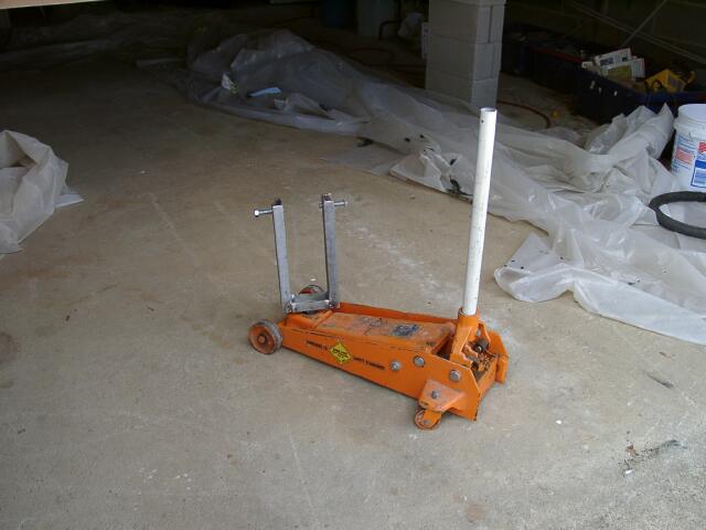

It is not too big a problem to do it yourself. Just put the boat on a nice hard surface (pave or concrete) and lower the tongue of the trailer all the way. Block up the back of the boat with barrels and beams or some other blocking or stand. Make sure you chock the wheels on the trailer. Crank up the tongue until you lift the stern up enough to allow the keel to be cranked down a few inches to rest back on the trailer. Get one of those hydraulic scissor jacks and attach a bracket to it (see attached). Use this to take the wieght off the keel, remove the bolts and gently lower. Just jack it back up again when you are done.
