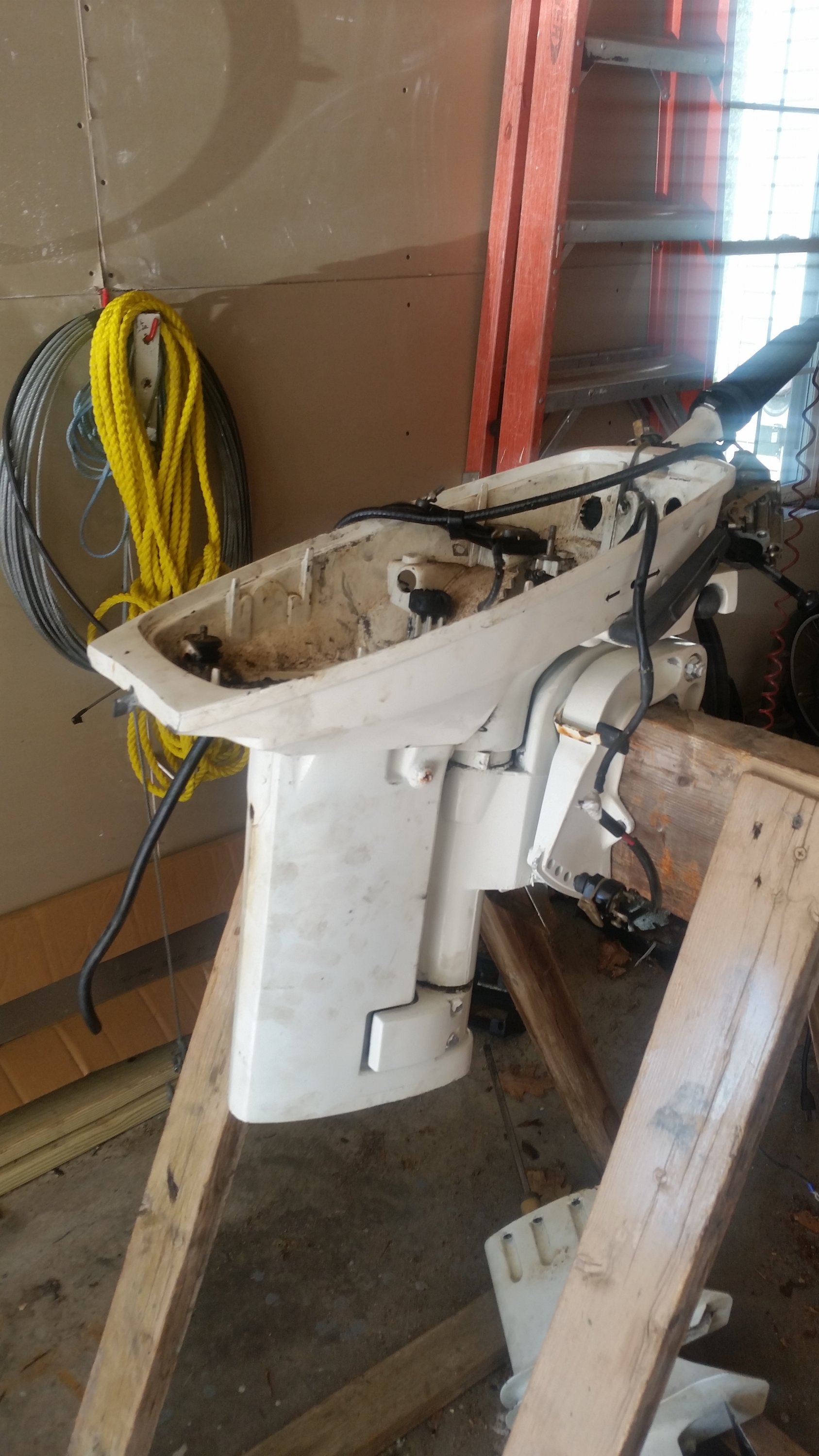

I agree with Sumner. Change oils and impeller. I do a white vinegar flush at the end of the season. I trailer everywhere and all salt water. A couple gallons in a test barrel and let it run till the water in tn the barrel gets hot. You will be surprised at what comes out. When I got my boat the motor looked new but someone had replace the water pump and pushed the bushing on the water tube up into the head. It stared over heating. Of course that was at Martha's Vineyard and many miles and two bays to cross to get to Fairhaven. That ended up being a total tear down.
I also replaced my thermostat last year. I put a heat gun on it and the temp was all over the place. Now steady.
