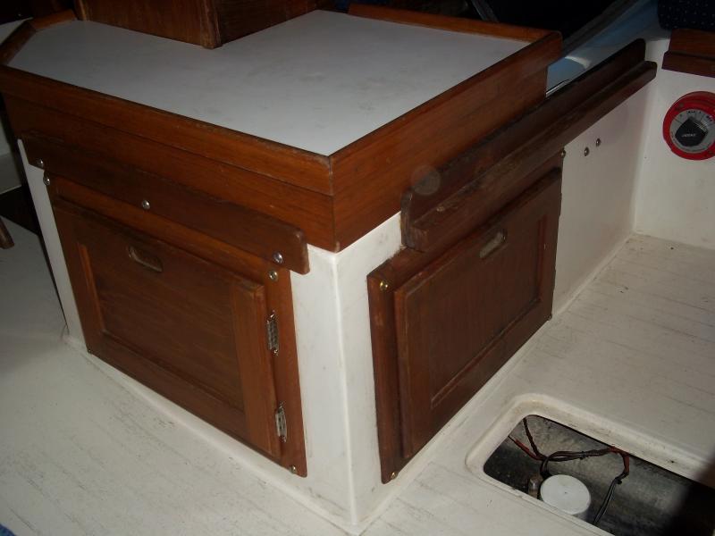

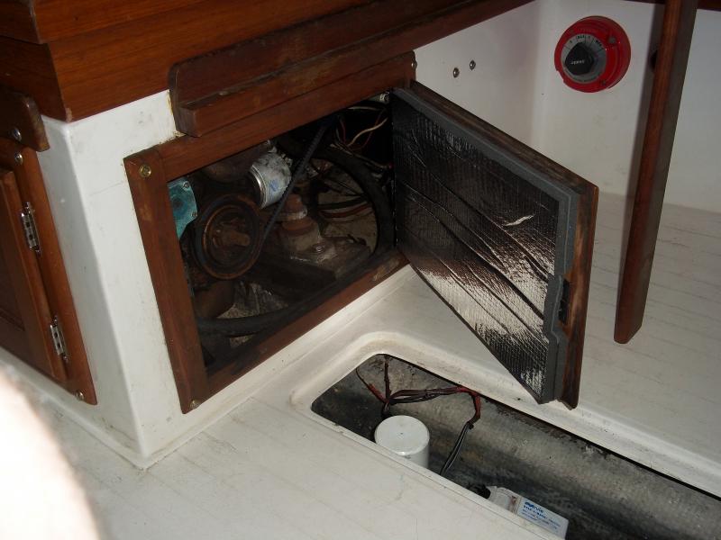

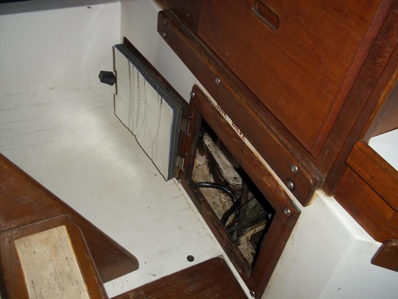

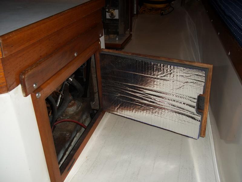

Has anyone else done this? Replaced the
hinges on the engine access doors. Put
them on the sides instead of the bottom.
Now they swing out of the way and you
don't have to put your weight on them,
and they don't fall open. Used magnetic
catches. Works great. I love this!
