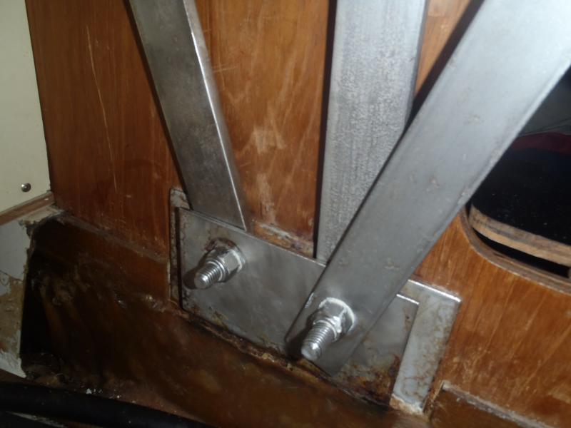

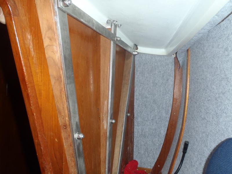

The purchase survey noted that the standing rig was of indeterminate age and should be replaced before operating inter-island. I noted that the swage fittings and some pins had corrosion stains, which is why I called in the rigger - but I'd seen the boat sailed hard before; which is, of course, no gaurantee of future performance. Got her for a steal and think it's very worth it, even with the cost of this maintenance.
The rigger said to pull and replace the chainplates, based purely on age. After removing all the starboard units, one of my friends who was assisting assessed in his professional opinion that the metal was in fine shape (qualifications being a nuclear QA inspector.) I contacted the rigger and he said if they were good, they were good. I've cleaned and reinstalled all the starboard units with new hardware and fasteners, as well as the anchor plate that's glassed in to the hull on that side. I have plenty of pictures if anyone is curious to see.
I do intend (at riggers recommendation) to pull the mast to replace the rig above deck, and will leave the installation and tuning thereof to a qualified professional. The lower shrouds are buried in the mast instead of connected with pins, so it's pretty much nescessary, and def above my level of skill. I can get all the lights and electronics done myself while it's down.
As a side note, I think this vessel has some unique aftermarket additions. The mast is yellow and anodized with something - cadmium maybe? and there is a third chainplate on each side, forward of the stay, for a forward lower shroud. The drawing I've seen of the Y-36's don't have that. It angles from about 6" aft of the forward saloon bulkhead aft to anchor at the same bolt as the main stay. It also doesn't have the topside "hilt" that the other chainplates do. Anyone else have this, or is it aftermarket, and if so, to what end?

Thanks for the update and great pictures. Interesting; she's a completly unkown boat to me, glad to see she's in good hands!
Also very interesting are your forward lowers and chainplate, very different from mine. I've scanned a couple of pages from the orignal manual that spec the rigging, I hope it's of some use. They are in the picture file of my boat.
