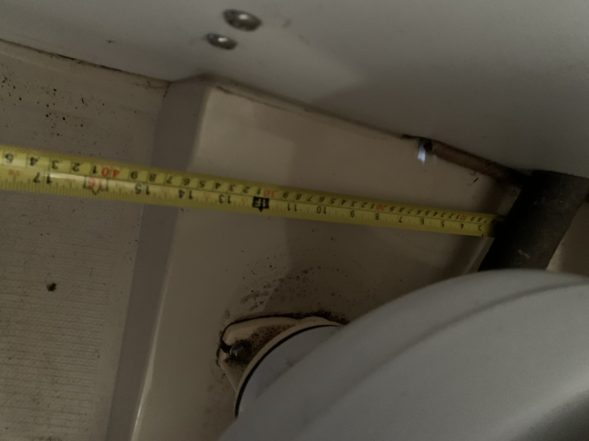

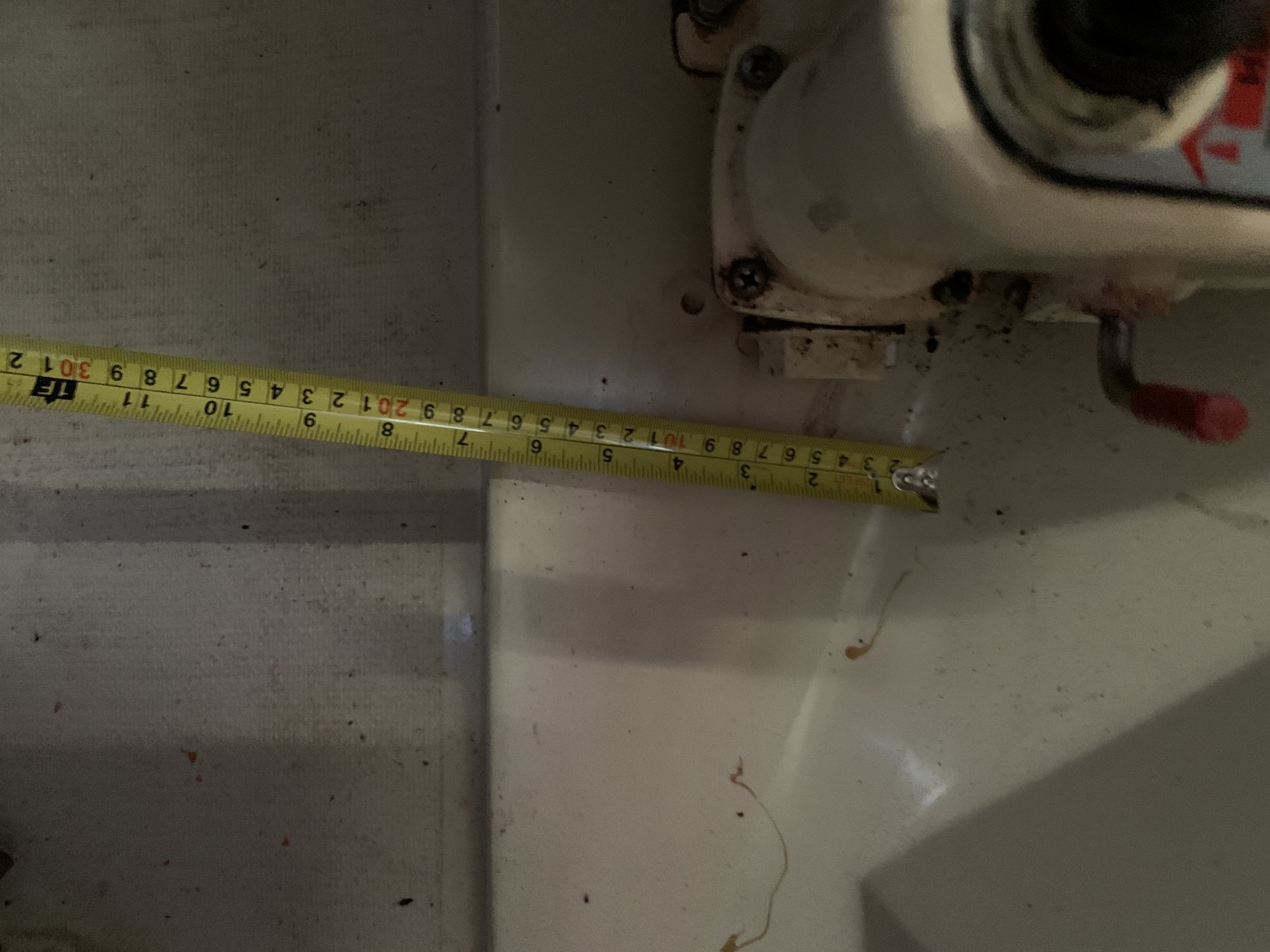

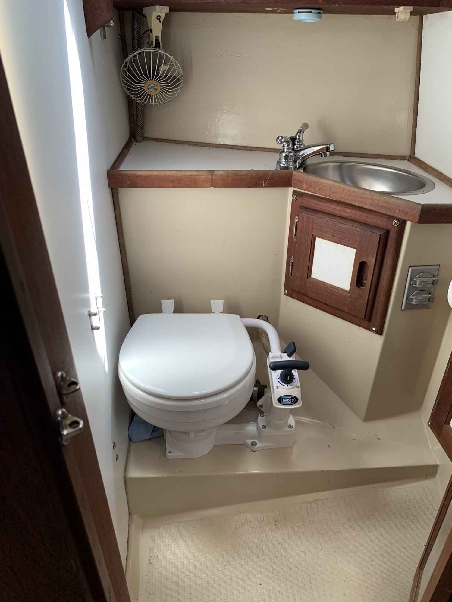

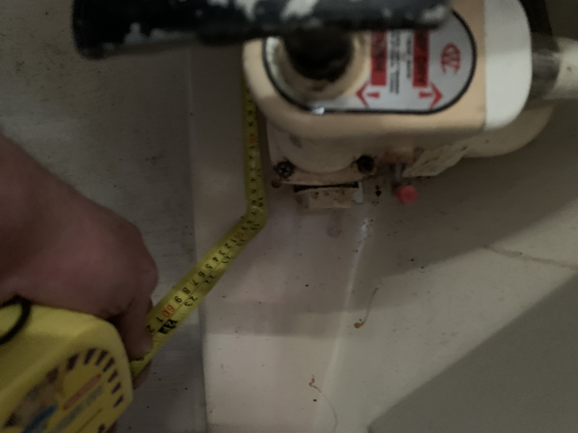

This is the photo I took before I put the new hose on the new head.
Here are the photos I took before I ordered my new head
13,405
There is plenty of room for a standard bowl. The base of the toilet will be the same, the bowl will extend an inch or two behind and in front of the current bowl. The dimensions should be in the manual.
