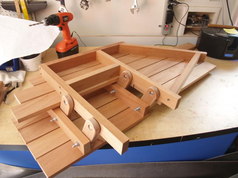

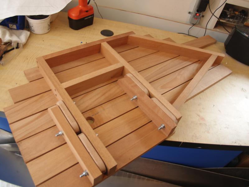

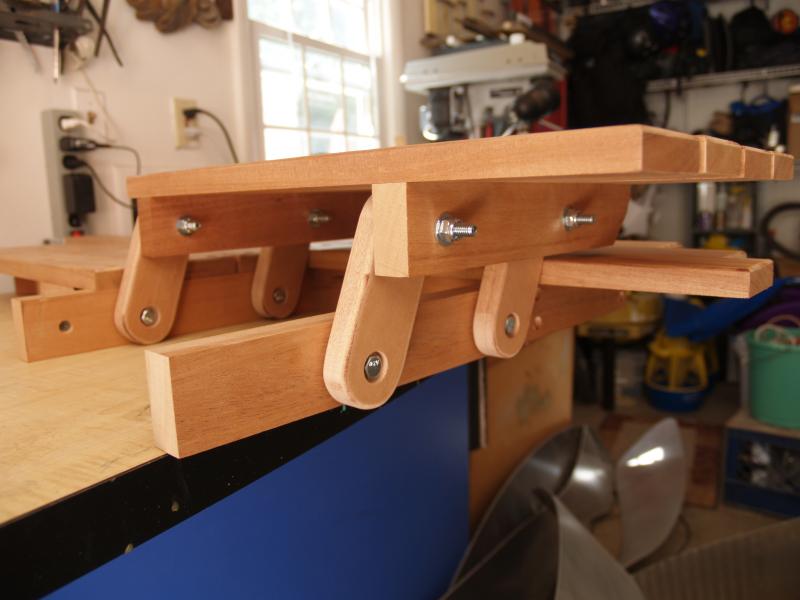

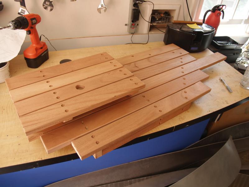

I've done this. I replaced mine with the Raritan PH II and it fits just fine on the footprint of the old one. I needed to drill new holes of course but the fit is good, except that the height is a couple of inches higher. Not a problem if you're tall, but if you're short (like my wife) or have kids, their feet will dangle. I resolved this by building a raised floor grate that fits inside the footprint of the floor pan. I even went a step further and created a section of the floor grate that lifts up and creates a platform for your feet. We call it the "Pooper proper", for proper pooping.

Danny that is some nice wood working you have there...is that Mahogany...
regards
woody
Yup, mahogany. It was a fun little project and dresses up the head quite a bit.
