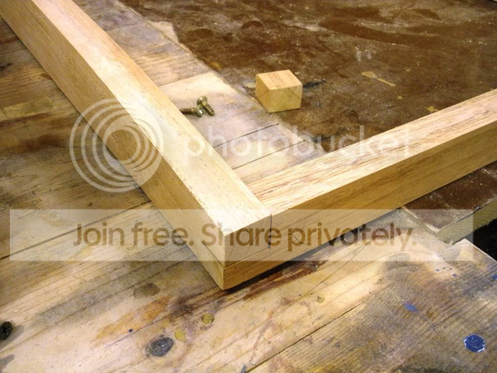

I started working on the hatches for Oh Joy. I picked up a 9'X14"X1-1/4" board of Honduran Mahogany, pricey stuff. This is the forward hatch I'm working on. The hatch a PO had built wasn't built of mahogany and was 5/8" thick as well as the frame not being jointed, just butt glued so it broke one day when I sat my 225 #'s on it to work on something.
This is the frame (I haven't cut the bottom curve of the athwartships frames yet) after roughing it in.

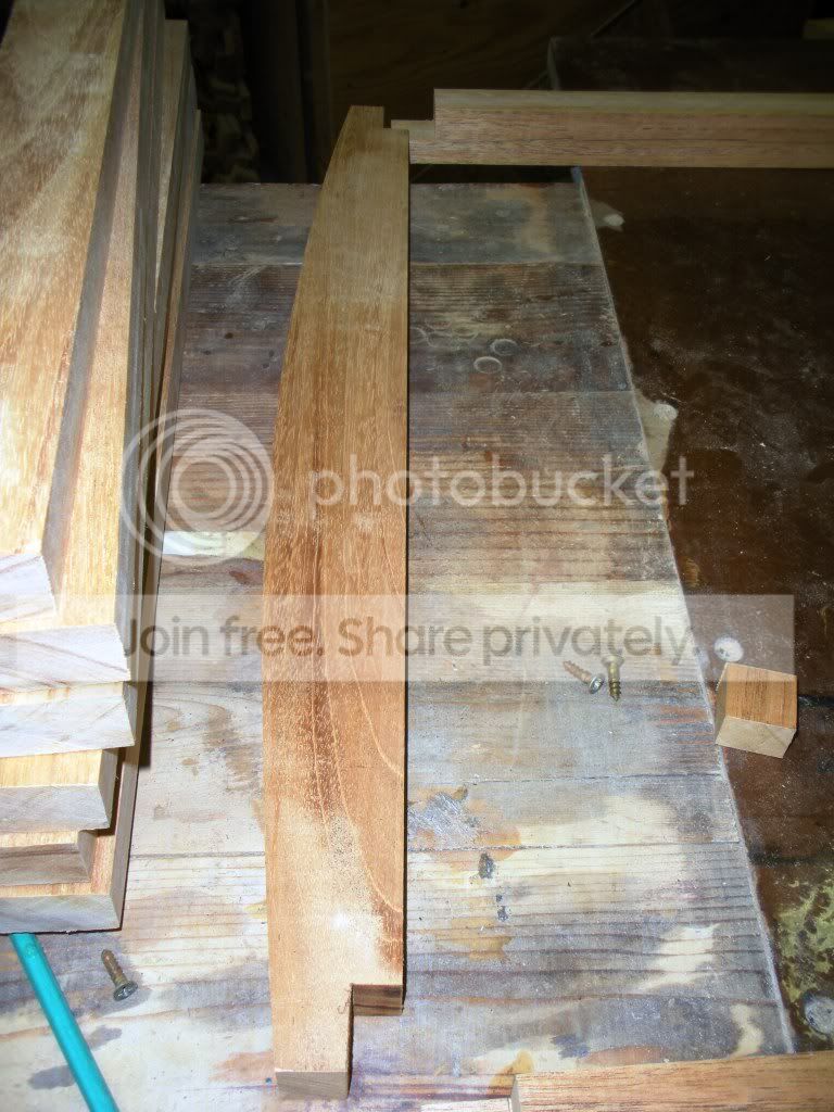

Joint

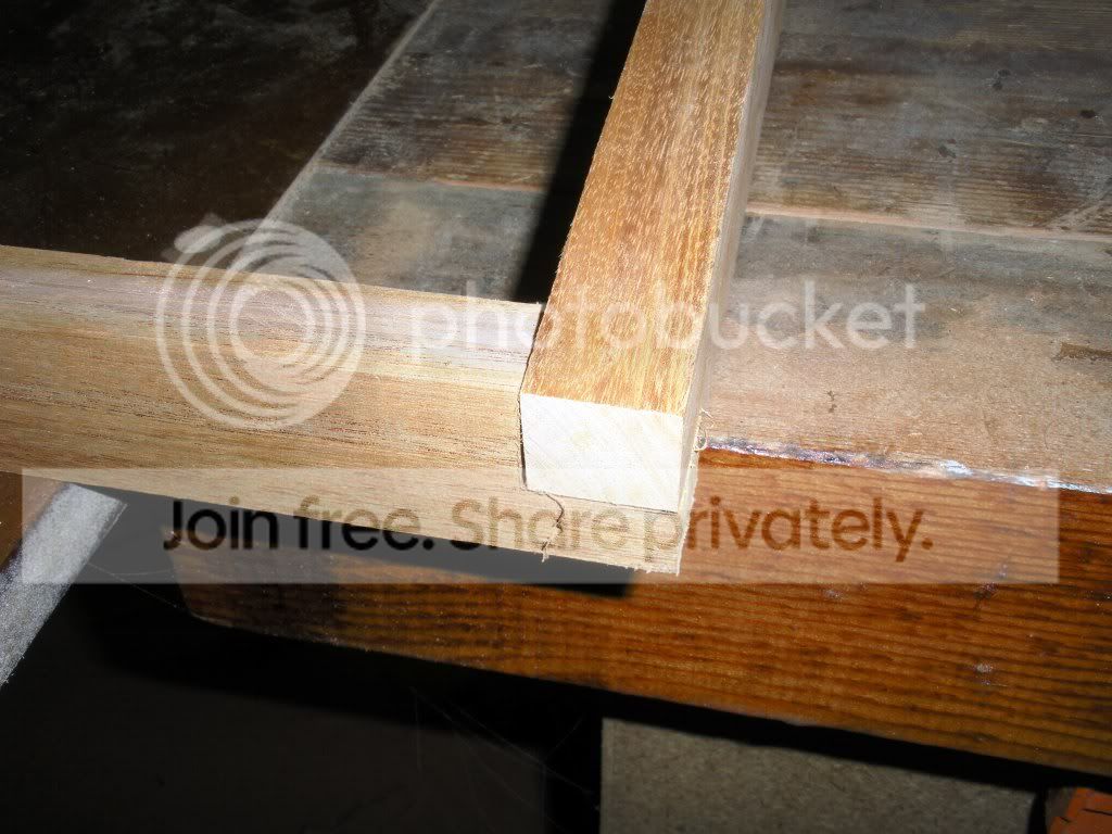

Another view

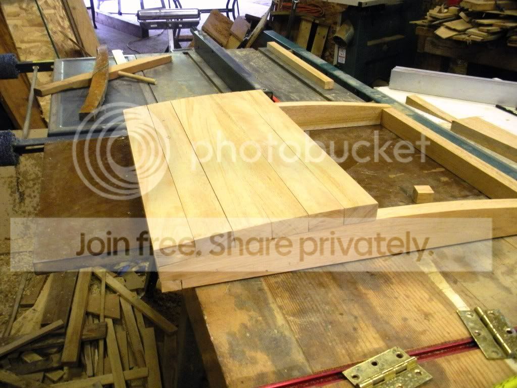

Partial mock up

yes, I'm gonna bevel those top slat joints and use glue and biscuit joins. I'm going to glue and screw with silicon bronze from the bottom on the frame joins and I'll run countersunk bronze screws with bungs over top through the top slats to the frames including a line down the side frames in the outer slats.
