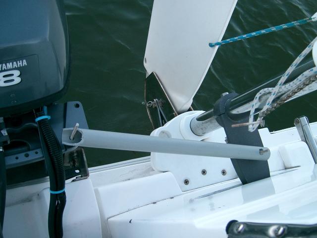

1. The way the motor is mounted so far to starboard, being able to direct the thrust is critical. Do get the motor/rudder link installed. (Photo of the cheap one available from Cabela's.) I take it off when sailing, hence the line tied on it.

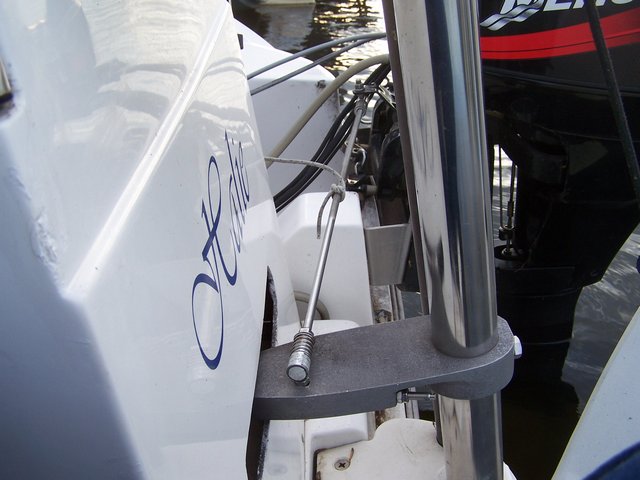

Here's a pic of my earlier motor/rudder link. Cost=$0, project time 30min max. replacement= anytime. Newer version is 1/2"pvc about 24"
It'll come, just keep practicing.
