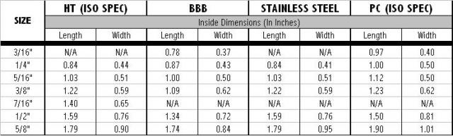

A measure of the diameter of the wire in the links and a count of the number of links per foot is what you need to match. Chain construction is pretty standard and the grades are well established.

Also, if your current chain fits the windlass, it will generally be marked. G43 or high-test chain should have a G4 stamped on the links, BBB will often have a "3B" stamped on the links, and Proof coil will have "PC" stamped on the links. Might want to look at the Acco chain PDF, located HERE.

Thanks everyone. The answer is that my current chain is 5/16 inch G4. One of the confusing things is what Sailing Dog referred to - this chain is stamped, and sometimes called G4, is made from G43 grade steel and is sometimes called HT or high test!!!
