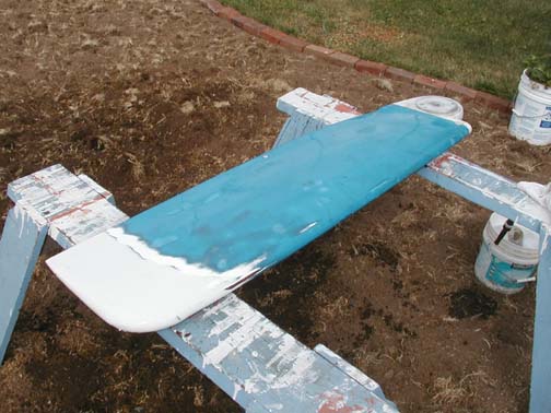

I recently had my 260 rudder rebuilt due to a large split at the bottom seam. I put several pictures of this project on the Hunter small boat forum. While working on it I had the boat shop add three pounds of lead and a brass skid strip to the bottom. They then glassed the area and put a finish coat on that did not match the origional white under the blue bottom paint. (see photo)I decided to sand off the blue bottom paint as it was always rubbing off on my hands and I store my boat on its trailer at my house so I don't need bottom paint. No problem wet sanding off the bottom paint but as it came off I noticed many thin spots in the gel coat, especially at the leading and trailing edges. I was very careful not to sand too deep and cause the thin spots myself. Now I want to apply a new gel coat. I have purchased some West Marine gel coat, which hardens without a cover coating, and tried using a brush to apply. With only 10 minutes to hard finish it did not give the coat time to flow and I ended up with lots of brush marks. I then tried a sponge-brush which worked much better but still gave marks and a pretty thin coat. As I carefully wet sanded, by hand, with 400 grit I could see through the new gel coat. My question is how to get a thick enough coat on, in the SHORT curing time, to sand and not leave lots of brush marks. I don't really want to take the rudder back to the boat works as I want to learn how to do this right myself. I don't own a paint sprayer.Brigg
