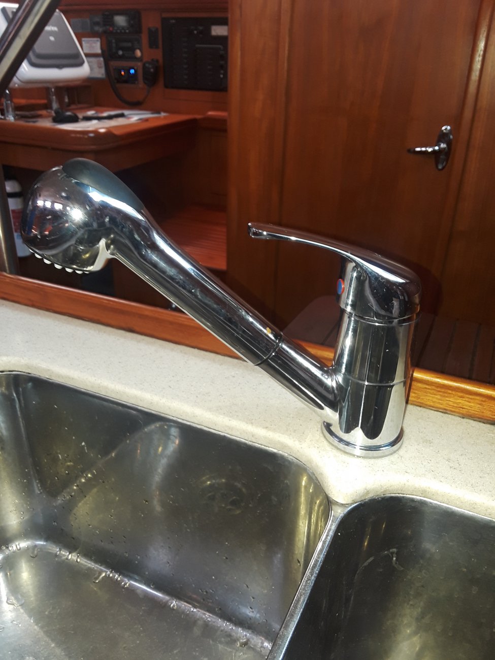

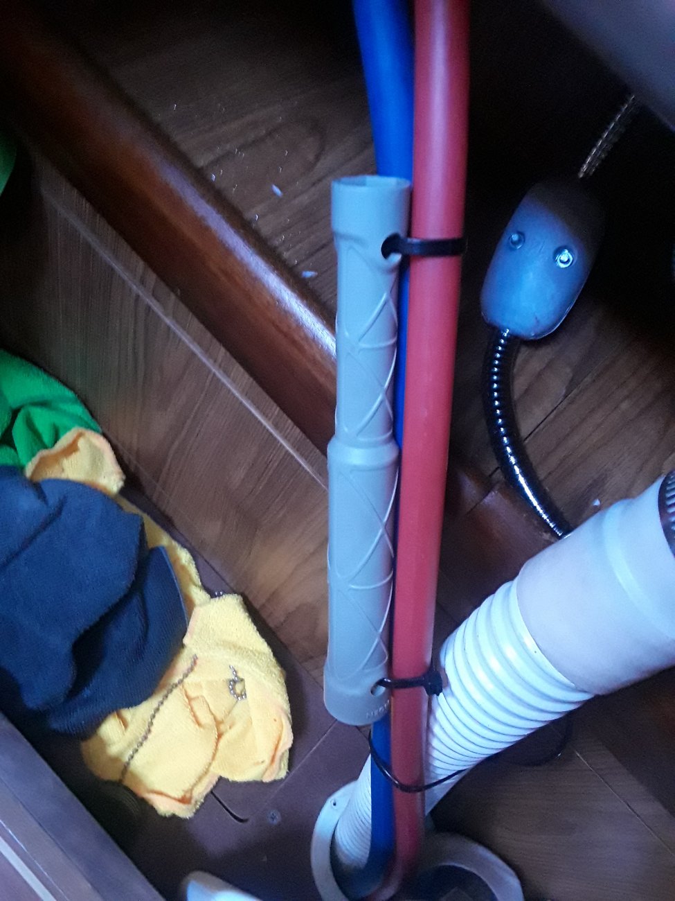

New to me Hunter 46 galley sink faucet water flow was restricted, looked tired (photo attached) and did not swivel cleanly. So I recently purchased a Scandvik sink faucet specified for a Hunter 46 from sailboatowners.com store. During faucet replacement I discovered the space between the sink and bulkhead was too small to remove the mounting and coupling hose attachment nuts with a conventional wrench so I thought I might be stuck. However, Hunter conveniently provided a faucet nut socket wrench tied to the hot water supply line (photo attached). This saved me from purchasing one, which made it easy to remove / re-install the mounting and coupling hose attachment nuts.
With the new faucet (photo attached) I now get adequate water flow and the chrome faucet is lower profile, looks great and swivels cleanly.
