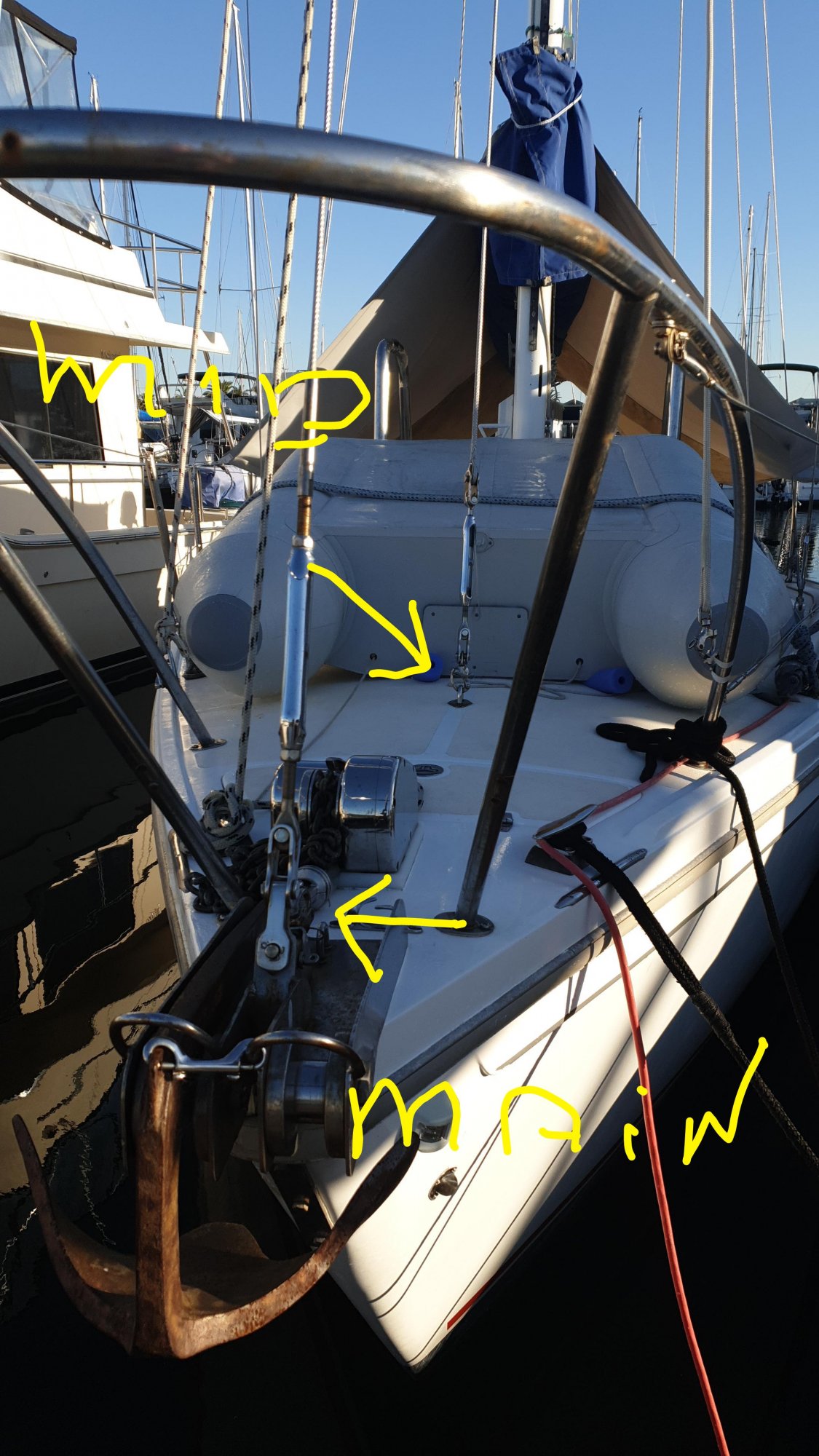

Taj... what you're calling the 'main' is your forestay or headstay. The 'baby stay' (mid) in your picture was most likely added to prevent mast pumping in heavier conditions and I would guess is not strictly required, and it certainly will complicate tacking and gybing. It's not a standard Catalina 30 setup.
The babystay is rigged with a quick disconnect snap shackle so you could easily stow it out of the way until it was deemed a good idea
(.. maybe never)

It's not a standard Catalina 30 setup. Ok, will remove it { let it remain but get it out the way } for tacking and gybing.

The inner forestay is not original and not required for normal conditions. That is why it has a quick connect. I have had my C30 tall rig with bow sprit for 25 years and have never found any issues with the factory rigging.
I suspect that the inner forestay was added to make the rig a cutter rather than sloop rig and allow the addition of an inner foresail for use in heavy weather. If this is the case, to be properly done, there should be some form of reinforcement added to the underside of the fore deck to take the load from that stay down to the hull. It is also likely that running backstays were added at the attachement height of the inner forestay to resist that load. If the inner forestay is attached near the height of the spreader, no running backs would be needed.
All of this would only be needed for serious off-shore work. I have sailed my C30 many times in +40 and one in the high 50-knot range and was able to keep everything reasonably comfortable with a double reef and roller furled 135%.
