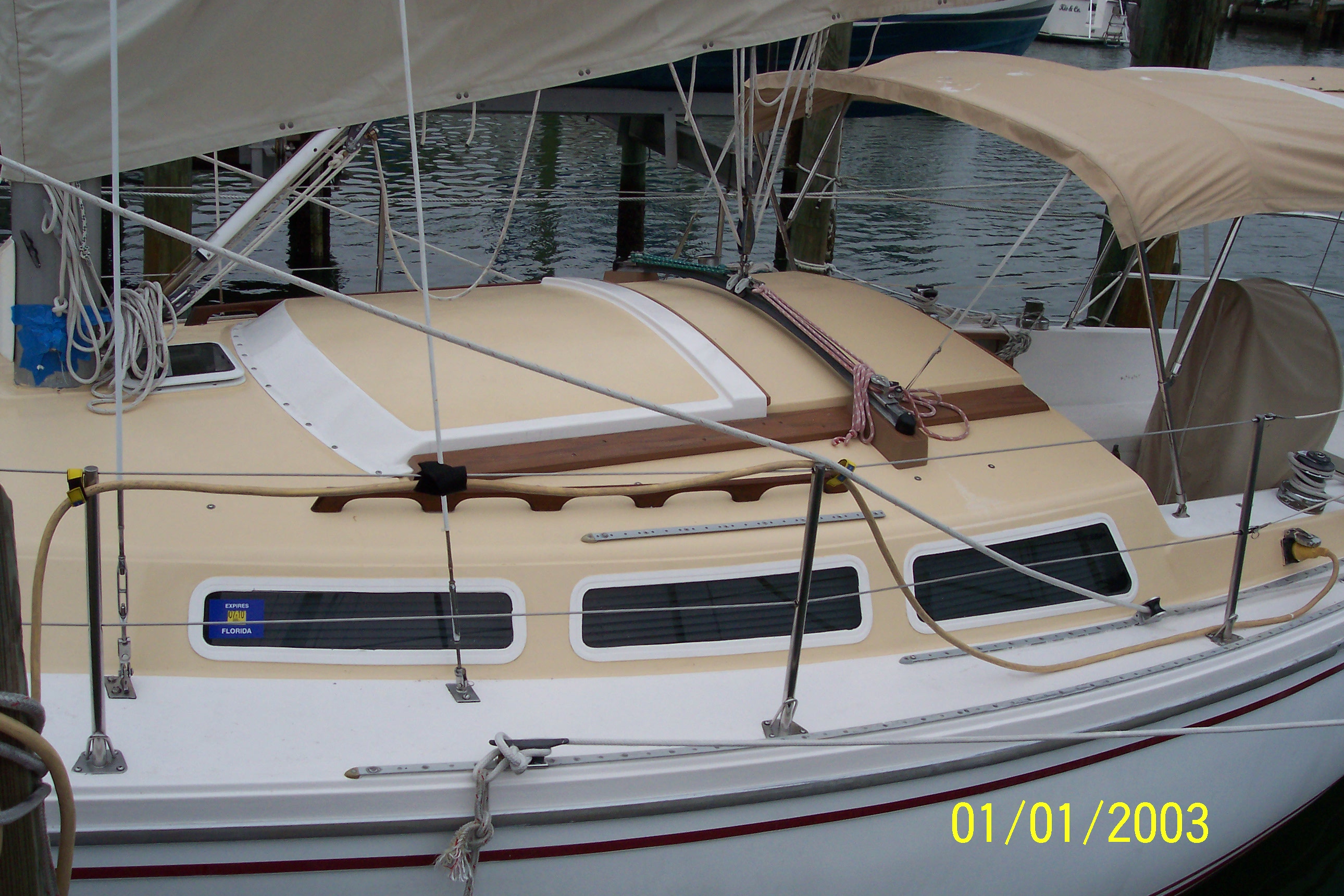

I have never liked the setup Catalina used for mid boom sheeting. Trimming it was not easy or convenient
. Had Garhauer make me this fiddle block. It trims as easy as a 22. Can still go to winch if needed. But out in heavy air last night and could pull in with one hand.

Wow, at first glance it looks like a lot of hardware, but when I count the sheaves, I see why.
You certainly should have enough mechanical advantage.

Looking at the pic, I do not know who set this up for you but is it SOO wrong.
it is not the better setup. What you have makes you work harder pal.
I use a different 3 to 1 purchase block. If you look at my picture,
& I know it is not the greatest, here is what I use & it is simple for making adjustments.
As you can see, all the lines are on a single plane for easy pull. Extra blocks makes no sense to me.
With my setup, adjustments are easy. If you look at the most aft line, when making adjustments, I grab this, pull it towards me as I adjust the boom,
I slacken the line I am holding while pulling the line thru my cam cleat.
It all goes very smoothly. And, you only have one adjustment point.
I've been using this for years.

Thanks for the comment. But apparently you are seeing more than one adjustment point. Mine has one and works beautifully. Glad yours works for you.

The thread was showing new setup that I liked. I have a different traveler than you do. It has 3 attachment points, instead of 1. Purchase is purchase whether in line or not. I did not like original setup going forward to base of boom, back through a deck organizer then back to cleat. When letting out main with old system, I had to push boom. Now it moves freely. Like I said. Glad you like yours. I like mine. I can release and pull in and lock from anywhere in cockpit. Even from behind wheel.

I did not like original setup going forward to base of boom, back through a deck organizer then back to cleat. When letting out main with old system, I had to push boom. Now it moves freely. I can release and pull in and lock from anywhere in cockpit. Even from behind wheel.
That's a great modification. I agree, the extra length & friction running the line to the mast and back can't be doing any good.

The critical part or your upgrade was getting rid of the curved traveler. I personally never liked running the mainsheet to the mast base beneath the vang. With that much purchase you can sit in the cockpit and flick the control line to unsnap it from the cleat. Nice.

I did basically the same thing on my 272, eliminating the curved traveler and main sheet run forward from a midboom sheet. Like yours, I ran it straight aft with a cam cleat on the fiddle. It worked great.
Yours looks good. Enjoy!

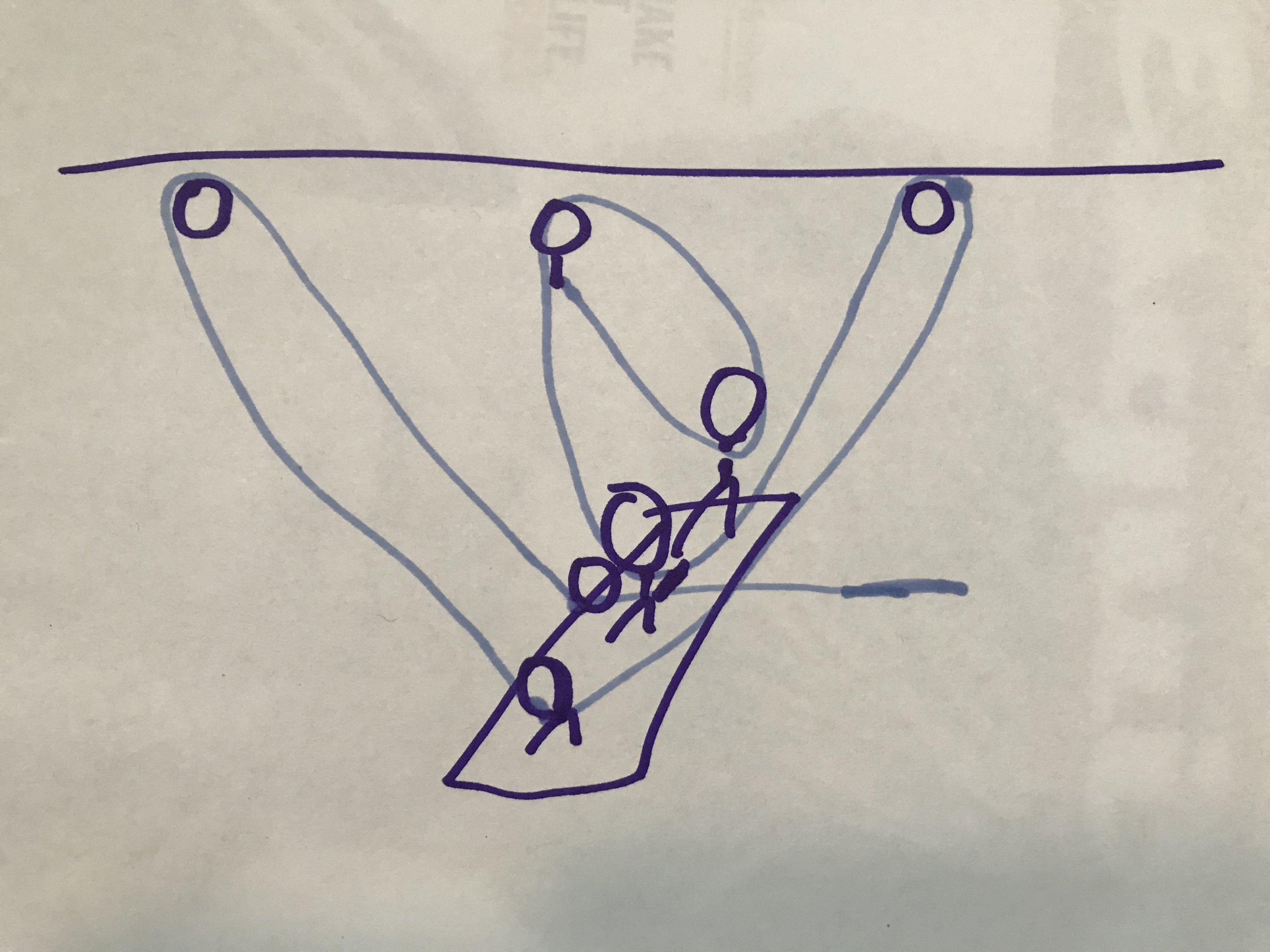

I’m really suprised that they put that extra block on top of the becket on the main block. With the three attachment points on the traveler car, they could’ve put that top block on the starboard side, and put the main block with the cleat in the middle. That would’ve made the load much more proportional and have the effort coming out of the middle of the car.
You could actually do that quite easily with the hardware you have right there

I don't need any more purchase

That would not change the purchase. It would just make it better organized, and allow the cleated block to pull from the middle of the traveler.
